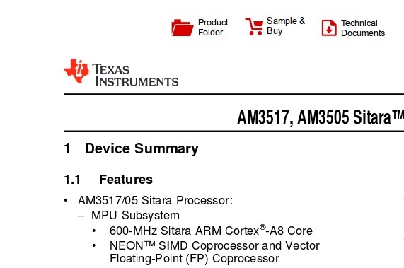

Hello TI,
We have AM3505 based custom board. While looking into the bootlog what we observed that MPU is running at 500MHz.
[    0.000000] Clocking rate (Crystal/Core/MPU): 26.0/332/500 MHz
So when I searched for it I got some reference from http://processors.wiki.ti.com/index.php/AM35x-OMAP35x-PSP_03.00.00.05_UserGuide
According to it if we add "mpurate=600" in bootargs the MPU frequency will change to 600MHz.
But when I did that I got some kernel crash messages
[    0.000000] ------------[ cut here ]------------
[    0.000000] WARNING: at arch/arm/mach-omap2/clkt_clksel.c:194 omap2_clksel_recalc+0xd4/0xe4()
[    0.000000] clock: Could not find fieldval 2 for clock clkout2_src_ck parent omap_54m_fck
[    0.000000] Modules linked in:
[    0.000000] [<c006b440>] (unwind_backtrace+0x0/0xec) from [<c008e198>] (warn_slowpath_common+0x4c/0x64)
[    0.000000] [<c008e198>] (warn_slowpath_common+0x4c/0x64) from [<c008e230>] (warn_slowpath_fmt+0x2c/0x3c)
[    0.000000] [<c008e230>] (warn_slowpath_fmt+0x2c/0x3c) from [<c0079d94>] (omap2_clksel_recalc+0xd4/0xe4)
[    0.000000] [<c0079d94>] (omap2_clksel_recalc+0xd4/0xe4) from [<c007c0ac>] (propagate_rate+0x20/0x50)
[    0.000000] [<c007c0ac>] (propagate_rate+0x20/0x50) from [<c007c0b8>] (propagate_rate+0x2c/0x50)
[    0.000000] ---[ end trace 1b75b31a2719ed1c ]---
[    0.000000] Switched to new clocking rate (Crystal/Core/MPU): 26.0/332/600 MHz
Can anyone please help me with this? How can I change the clock frequency to Maximum?
Kindly let me know if there is any more information required.
PS: Please find the full logs along with this thread
