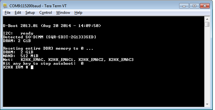

    The following are the steps to get the u-boot prompt on K2H EVM through CCS which is the easiest method.
    Please follow the steps one by one and reply me upto which step you can carry on.
    I have attached the necessary screenshots for your reference.

      ----> Hit the play button in CCS and in the tera term observe the output messages from "u-boot.bin" image ( flashed through CCS just now) and the u-boot prompt like below.
    First make sure, that you get this, then we will see the OOB Demo.

  • Hi Shehzad Ahmed,
    I have personally tested the image, u-boot-keystone-evm.gph and it worked for me many times.
    Post the screenshot of it with your UART settings details such as baud rate - 115200, hardware flow control - none e.t.c.
