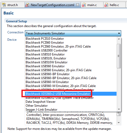

We have been experiencing some license issues with CCSv5.1 we hope you can help us solve them.
We have recently purchased the TMS320C6670 Evaluation Module with the XDS560v2 Emulator. The DSP arrived with CCSv5.1 and a licence file, unfortunately when we try to load the C6670 configuration we receive a “license cannot be acquired” error, saying  that our license is only for XDS100 and not for XDS560.
According to TI’s licensing wiki  the bundle license included with the DSP should work with the XDS560v2 card available in C6000 multi-core EVM bundles: http://processors.wiki.ti.com/index.php/Licensing_-_CCS#License_Types .
Could there be something wrong with our license file?

  • Eyal - Are you using the connection type for the mezzanine emulator? That is the only one that will work with the bundled license:
    ki
  • I was using the Trace Emulator, Mezzanine Emulator work.
    Thank you
