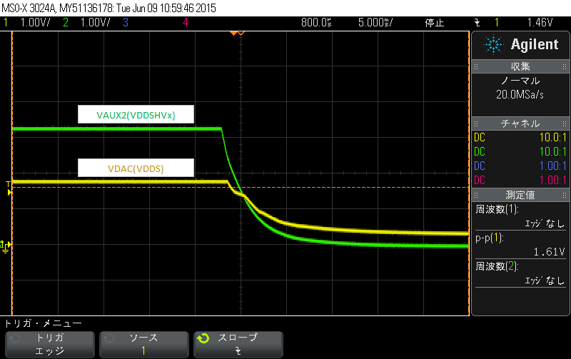

I have some question about AM335x power down sequence.
Could you please answer my question?
I have gotten the waveform of VDAC(VDDS) and VAUX2(VDDSHVx) on AM335xEVM.
I suspect that it violates the following description on AM335x datasheet.
"It is recommended to maintain VDDS ≥1.5V as all the other supplies fully ramp down to minimize in-rush currents."
Does this waveform violates this description?
If yes, please tell me what I should do to solve this.

  • Sorry, this is the waveform.
  • The requirement to maintain VDDS ≥1.5V as all the other supplies fully ramp down to minimize in-rush currents is preferred, but we understand this may not be possible in some cases.
    The alternative is to make sure VDDSHVx [1-6] is never greater than VDDS plus 2 volts during power supply ramping on/off.
    Paul

  • Wolfgang, your comment about power-down not being problematic is not true. I agree the power source may produce higher levels of energy than the capacitors, but the power supply capacitors can store significant amounts of energy. Energy stored in the power supply capacitors is more than enough to generate an Electrical Over-Stress (EOS) if the recommended power-down sequence is not followed.
    There are two common EOS events that damage semiconductors. One common EOS event occurs when more current than expected is forced through circuits which can over-heat individual components in the semiconductor. The other common EOS event occurs when a voltage potential larger than expected is applied to circuit components, where the field strength of the voltage potential breaks down very thin insulators in a semiconductor. The later EOS event doesn’t require any current.
    Ishii-san, the waveforms you posted appear to meet the alternate requirement of not allowing the voltage applied to VDDSHVx [1-6] to exceed the voltage applied to VDDS plus 2 volts.
    Paul
