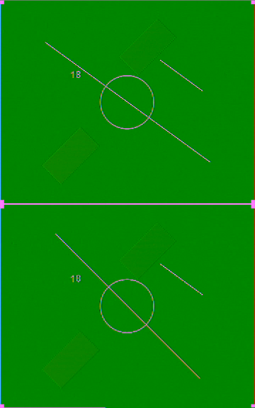

I am trying to decode a MPEG2 stream.  I set this picture to the McFw:

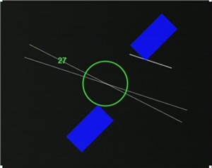

I get this picture after my processing chain:
My processing chain is: Decode -> DEI->Display.
My problem with this picture is: it lacks one frame
All of my chain is interleaving:
Pt_chInfo->scanFormat =  SYSTEM_SF_INTERLACED;
Pt_decLinkChPrm->processCallLevel     =  VDEC_FIELDLEVELPROCESSCALL;
deiPrm->enableDeiForceBypass    = TRUE;
The formats I use:
prm.deviceParams[VDIS_VENC_DVO2].outputInfo.dataFormat = SYSTEM_DF_YUV422SP_UV ;
Pt_decLinkChPrm->format             = IVIDEO_MPEG2HP;
Pt_chInfo->dataFormat     = SYSTEM_DF_YUV420SP_UV;
I use the output: HD Venc DVO2 ( prm.deviceParams[VDIS_VENC_DVO2].outputInfo.dvoFmt = VDIS_DVOFMT_SINGLECHAN;)
Can you tell me if this parameters are correct ? And can you tell me why my picture is different?

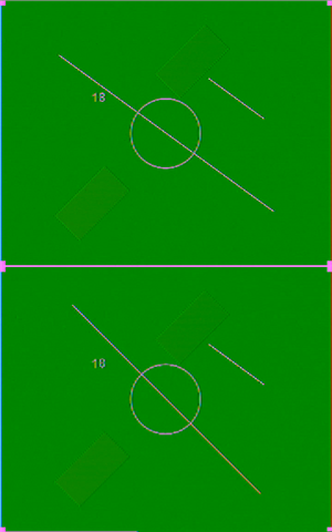

    At the output of decode, I have this good picture:

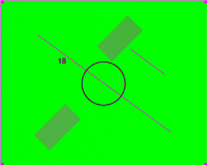

    Now, at the output of DEI, I have this picture:
    The color isn't e problem. But the Dei takes just a TOP picture of the decode and never takes a BOTTOM picture.
    Here the DEI setting:
        uint32_t  outId, chId;
        deiPrm->comprEnable                          = FALSE;
        deiPrm->setVipScYuv422Format        = FALSE;
        deiPrm->outputDeiFrameRate             = Pt_S_Application->Conf.framerateOut; //50
        deiPrm->interlacedBypassMode         =  TRUE;
        deiPrm->enableForceInterlacedInput  = FALSE;
        deiPrm->enableLineSkipSc                 = FALSE;
        deiPrm->enableDualVipOut                 = FALSE;
        deiPrm->enableInputFrameRateUpscale = FALSE;
        outId = 0;
        deiPrm->enableOut[outId] = TRUE;
        deiPrm->tilerEnable[outId] = FALSE;
        for(chId=0; chId< 1; chId++)
            deiPrm->outScaleFactor[outId][chId].scaleMode = DEI_SCALE_MODE_ABSOLUTE;
            deiPrm->outScaleFactor[outId][chId].absoluteResolution.outWidth = 720;
            deiPrm->outScaleFactor[outId][chId].absoluteResolution.outHeight = 576;
        deiPrm->outputFrameRate[outId]  = Pt_S_Application->Conf.framerateOut;  //50
        deiPrm->numBufsPerCh[outId]     = NUM_BUF_PER_CH; //5
        deiPrm->generateBlankOut[outId] = FALSE;

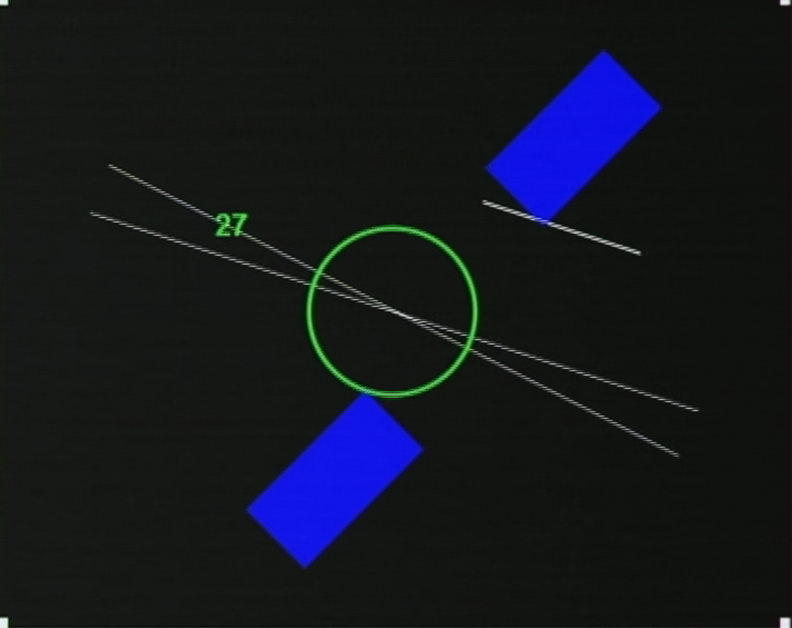

    Now, I have this good picture:

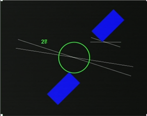

    and this bad picture:
    The problem is: I have a good picture (Top and Bottom are interleaved) but sometimes I have a picture with a good Bottom intreleaved with the next Top.
    Do you have any idea?
