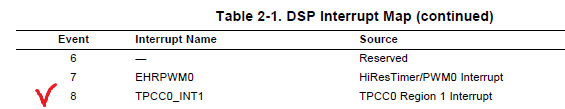

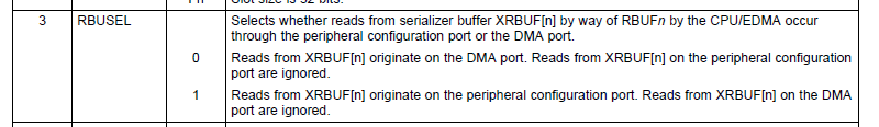

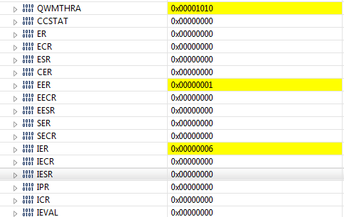

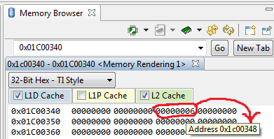

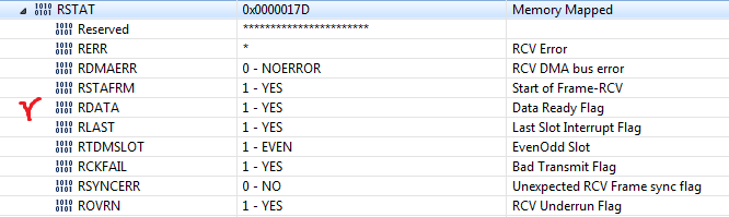

Hello.
I'm successful in sending and receiving data through  MCASP0 with interrupt. I'm using QuickStartOMAPL1x rCSL  mcasp  example, slaved for my board.
I'm change my example for receiving data through EDMA 3. (using parts of code from this example  software-dl.ti.com/.../index_FDS.html). But I don't go to the interrupt handler function. EDMA3CC_INT1_isr  isn't  triggering.
I am followed by sequence from  SPRUFM1  document  (2.4.1.2 Transmit/Receive Section Initialization), but it  does not solve the problem.
This is my code:

  • Also I must correctly  set   INTMUX  register.
    // EDMA3 Channel Controller 0 Region 1 interrupt
    CSL_FINS(dspintcRegs->INTMUX1, DSPINTC_INTMUX1_INTSEL4,  CSL_INTC_EVENTID_TPCC0_INT1);
    For transfer completion interrupt I must select the TPCC0_INT1  interrupt or not ?
    The next interrupt using only for error detection or not ?
    Thanks.
    Thanks for your update.
    The above line would map the EDMA3CC system interrupt (TPCC0_INT1) to DSP INT4 and this would setup the DSP interrupt controller. Yes, you are right, you should configure the EDMA3CC0 system interrupt TPCC0_INT1  for transfer completion interrupt. Also, for the EDMA3 channel controller to assert a transfer completion interrupt, you should enable setting up the TCINTEN and ITCINTEN bits in OPT of the associated PaRAM set.
    Again, the next interrupts are used for error enabling for CC0 and TC0,1 which is for error detection on any CC & TC's.

  • Interrupts doesn't work.
    rcv_ping_L, rcv_pong_L, rcv_ping_R, rcv_pong_R   buffers  - are empty.
    DMA Region Access Enable Register for Region 1 - set is OK. [E1=1; E2=1]
    Interrupt Pending Register (IPR)   contains all zero.
     I do not understand what's going on. How I can solved this problem ?
    Thanks.
  • IER register set to 0x00000006
    Interrupt Enable Set Register (IESR)  contains all zero. Is it correct ?

  • Receiver Status Register (RSTAT) contains the next:
    Data is transferred from XRSR to RBUF and ready to be serviced by the CPU or DMA. When RDATA is
    set, it always causes a DMA event (AREVT). Why EDMA doesn't work ................... ?

  • I solved my problem [EDMA and interrupts works successfully ].
    Problem was on this configuration:
    CSL_FINST(mcaspRegs->RFMT, MCASP_RFMT_RBUSEL, VBUSP); // VBUSP =0
    Correct configuration is the next:
    CSL_FINST(mcaspRegs->RFMT, MCASP_RFMT_RBUSEL, VBUS);  // VBUS =1
    But on SPRUH91b  I read the next information:
    RBUSEL  must be = 0 ?
    Tell me please  where the Truth Lies.
    Thanks.
  • Hi
    You might find the following wiki useful
    processors.wiki.ti.com/.../McASP_Tips
    I have not read the entire thread, but RBUSEL should be set as recommended in the user guide and the wiki.
    VBUS = DMA port
    VBUSP = config port.
    Let me know if this does not help.
    Mukul
  • Hi, Mukul.
    Thanks for your explanation, it's realy helped.
    Thanks.
