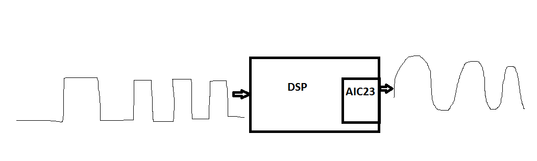

I know c6713 has a codec to read analog inputs, is there any way i can work on digital pulses using c6713.
I need to take the digital pulses coming from tac line and convert that digital pulses to a analog signal and send it out through line in.
Thanks.
Have a small description about the project, I would be getting a Tac signal from Tac line which is a digital pulses, so i have to output a analog signal based on received pulses.
Is there any sample example for such type.
I am new to dsp , so any help would be appreciated.

I would simply like to take digital data through GPIO ports and send it out to codec, which converts it to analog output.

You have sample code for accessing GPIO registers. You also need to find sample code for accessing codec outputs, which probably means using the McBSP ports.

In your GPIO sample code, what is the line below doing?
Navaneeth Karthikeyan said:> *GPIO_VALUE_REGISTER = 255 ;
Is this reading from or writing to the GPIO register? Is it accessing a single data line or more than 1?
Can you observe the GPIO pins with a scope or change them with a signal generator (or even with a manual switch)?
When you read the GPIO register, if there are several pins providing values into that register, how can you pull out or extract the single line that you want to read? Since that will be a simple binary 1 or 0, you will next figure out an algorithm that will convert a series of binary 1 or 0 data into a numeric value to be written to the codec.
