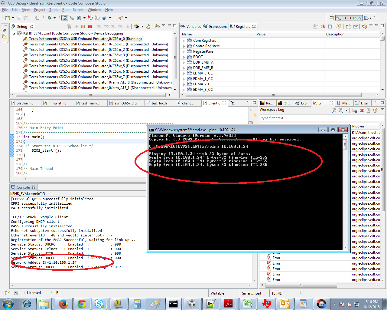

    In my setup, I've connected my K2H EVM board to LAN so I would get IP address from DHCP server and running the NDK client example without any code modification.
    Here is the screen shot.

    I've tried newer MCSDK NDK examples too which you used and got the good results.
    Did you change the code ?
    1) Set boot mode to "DSP no-boot mode"
    2) Connect DSP core0 and gel file get initialized.
    3) Select DSP core0 and load the attached .out
    4) Run.
    If you get again the same problem, then we will try to change to the "static mode".

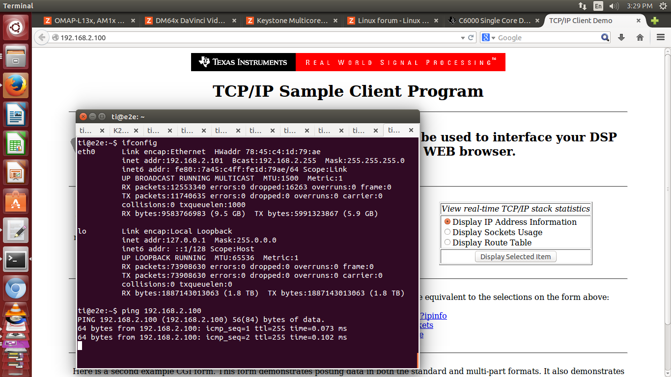

    As I told you, now I've done static mode too with just bit changes.
    I've attached the code and check the screen shots.
    Setup:
    I've connected ethernet cable between Windows 7 PC where I'm running code on K2H EVM (192.168.2.100) through CCS and Linux machine (192.168.2.101).
    We have to setup the ethernet address (192.168.2.101) at other end i.e, Linux with the same subnet address of K2H's IP address (192.168.2.100)
    https://e2e.ti.com/cfs-file/__key/communityserver-discussions-components-files/791/1323.client_5F00_evmk2h.out
    Even we can do the same on the same Windows 7 PC setup where we are running the CCS with LAN settings option and "static IP mode" configuration.
    If you face any issues with this, kindly let me know, I will do the same for windows 7 PC also.
