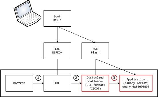

I am creating a bootloader.
The boots are in order, three times a failure.
Load binary data in the address 0x80000000, if you would like to jump to 0x80000000.
How do I create a bootable binary file, not the ELF file?
2) strip6x -p -o bootloader.bin bootloader.out ==> BOOT PASS
3) tiobj2bin app.out app.bin ofd6x hex6x mkhex4bin ==> BOOT FAIL

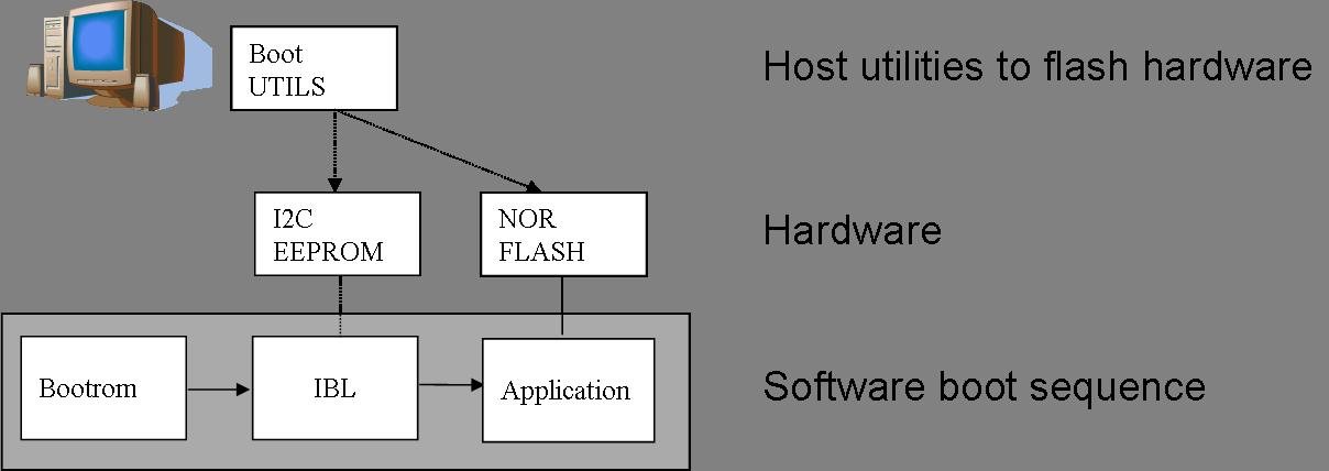

  • Hi Gyosun,
    What is the boot sequence and mode? Is it something similar below?
    If as above, you are able to run IBL and not able to load the application from SPI NOR flash. Is my understanding right?
    Thank you.
    For my understanding, you are able to boot ELF format binary file from IBL and not able to boot BBLOB format binary file from IBL boot. Is it correct?
    I have answered your previous thread, how to change the boot format ibl_BOOT_FORMAT_BBLOB to ibl_BOOT_FORMAT_ELF on IBL source.

  • Hi Raja,
    I think the concept is.
    It works well to create CBOOT.
    After downloading the app from the flash through the uart CBOOT, the concept is to boot after a ddr3 copy area.
    Simply convert your file to the BIN file OUT(ELF format).
    How do I convert? In another type of the CPU it has been converted to objcopy.
    Thank you for your help.
  • Now I understand the flow.
    What is the purpose of CBOOT?
    What is the file format supported by CBOOT?
    Are you downloading the application image from flash or through UART?
    From my understanding, the CBOOT fails to load and run the application image from flash or UART.
