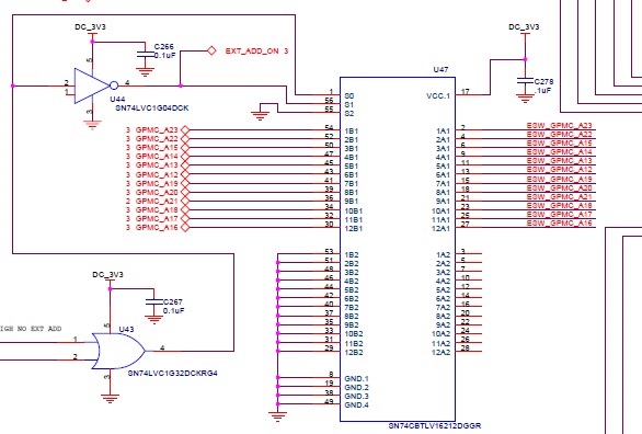

  • AD multiplexed mode is not supported for 8-bit devices. With your device you can only boot in one of the XIP modes described in Table 26-9. Pay attention to this:
    "Specifically, external logic is needed to isolate the upper address lines (A12–A27) of the NOR flash from the device pins and drive them low during non-muxed NOR boot."

  • MOHIT HADA said:
    But this means that only A0 to A11 can be used to address the OTP during boot through the ROM code
    This is correct.
    MOHIT HADA said:
    rest of the addresses need to be driven through normal GPIOs
    This is not necessary. You need only to ensure that addresses above A11 are low at reset release time, so that the ROM code can start reading from the correct NOR location. The simplest way to do this is through external pulldown resistors. Another way is to use an external switch, controlled through a GPIO. See this schematic to get the idea:
    This is just an example, addresses are different on the picture.
    Then what has to be done is to pinmux the high GPMC address pins within the first 4k of code, after which the whole NOR can be accessed correctly.
