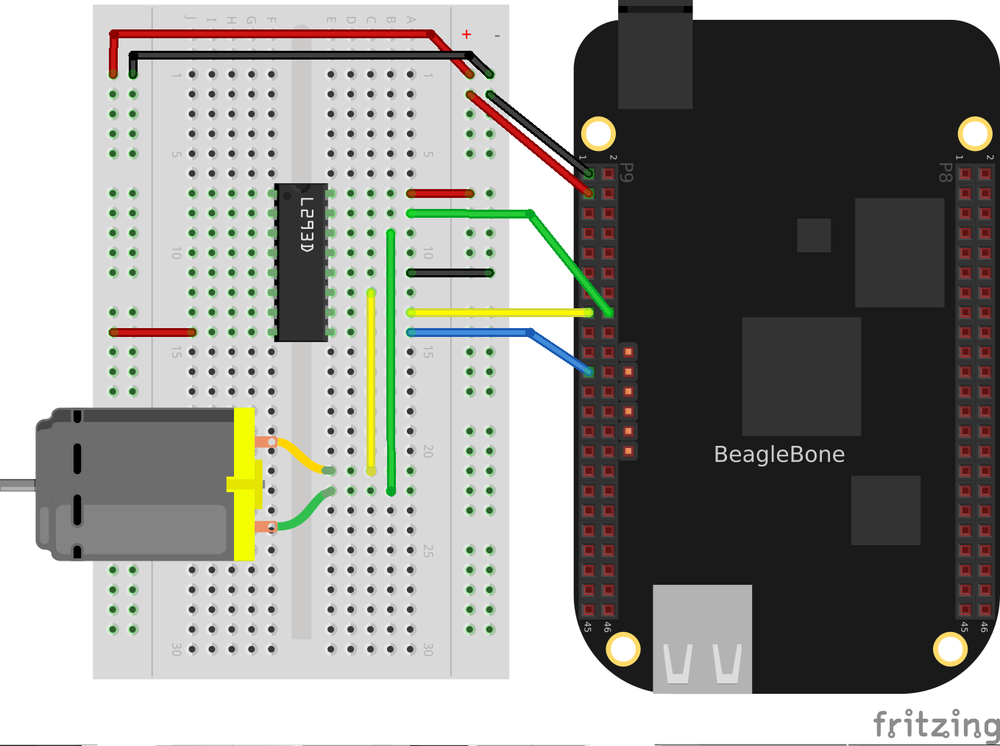

  • Here i will post schemtic of my system . (I am a fresher to Eagle). Could you please   find the  bad practises i have designed.
    The IC L293D's 5V supply @ VCC2 is taken from SYS_5V of P9 header of BeagleBone. Is it a bad practise ?

  • The problem is very simple. Your L293D is powered at 5V. AM335X I/O pins in Beaglebone are powered from 3.3V and are NOT 5V tolerant. You must use level shifters when you interface to any voltage different from 3.3V.
    You can safely assume that your processors have failed. There is probably nothing wrong with the PMICs.
  • I got the references from BeagleBone cookbook chapter4 like ,
    Then what i am missing ?
    And , i can't use the damaged boards any more ?
    And what is the best design to achieve the system i have tried ? . . .
  • I don't have this book, but from what I see power for the external board is taken from P9 pins 1 and 3, which are GND and +3.3V.
    As for your boards I cannot help. The processors need to be changed at least.
