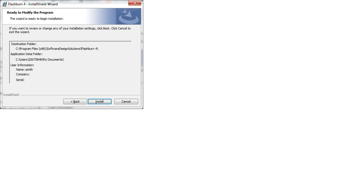

I found a promising tool, FlashBurn4 from http://processors.wiki.ti.com/index.php/Flashing_the_C6713_EVM
I had to download CCS 5.2 to make it work. However,  I cannon find the FlashBurn Target Component file (.fbtc) required to make the program work. Does anybody know where I can found it?
