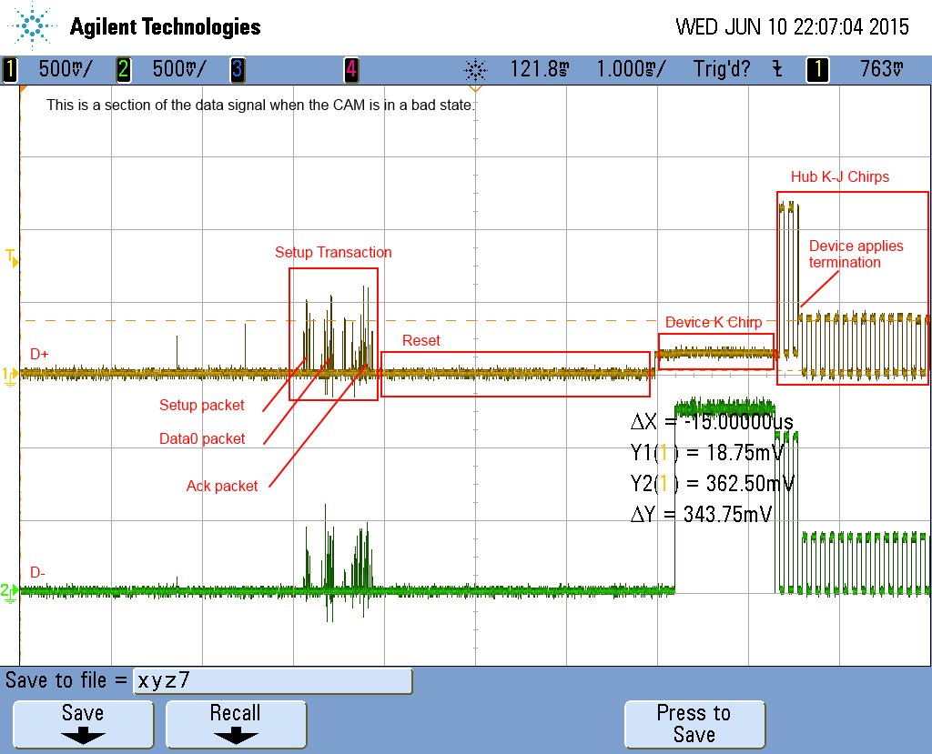

The issue is as following description:
Our device is using AM3352 which connect to a PAD(such as Lenovo PAD or Nexus PAD) through USB, when plugging in/out USB cable between our device and PAD many times, the PAD can’t identify our device by USB, only reboot our device can fix it;
We have made some debugging on it, but can’t get solutions, Please get detailed information from attachment;
It’s an urgent issue about the USB on AM3352 now, please help  us to fix this issue, thanks in advance!

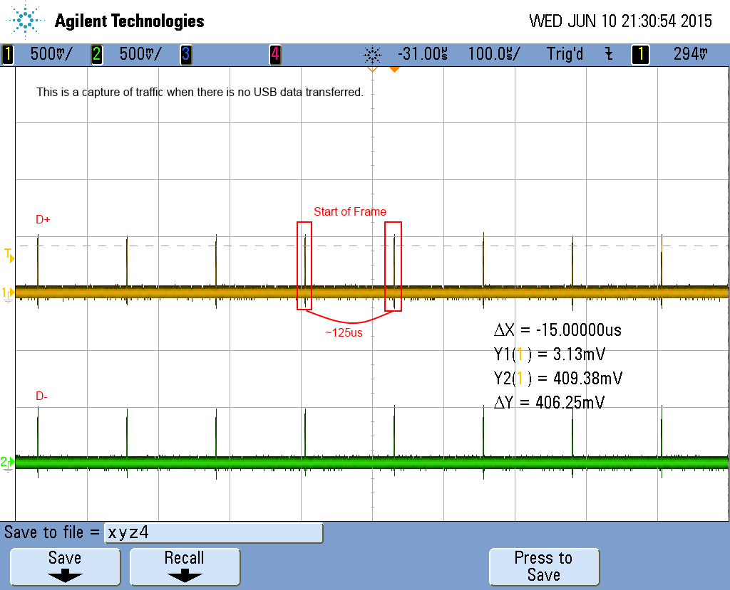

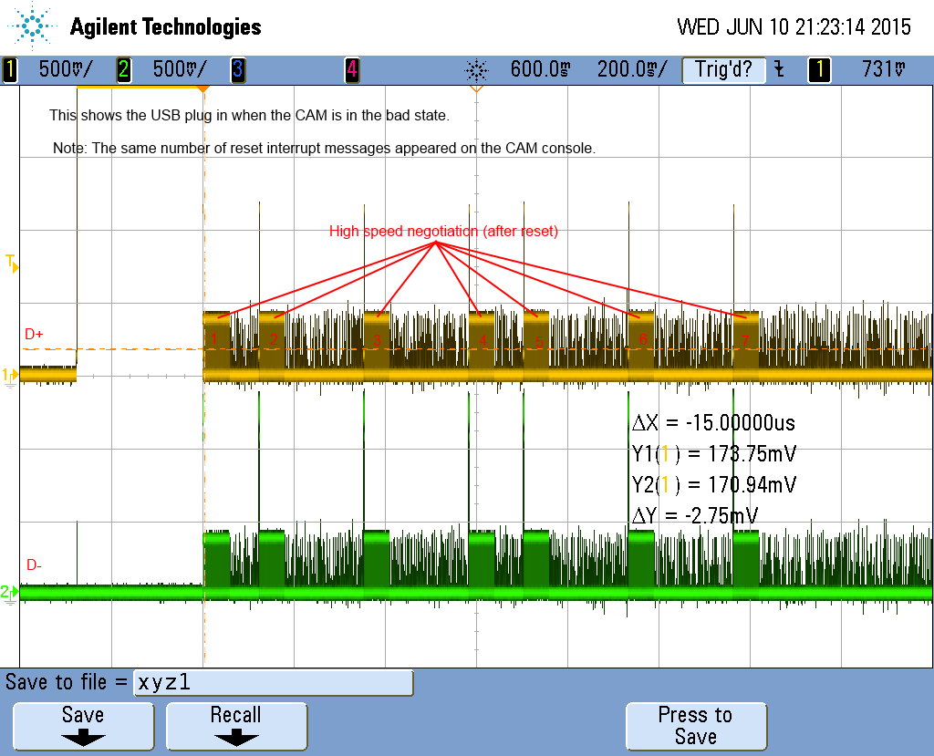

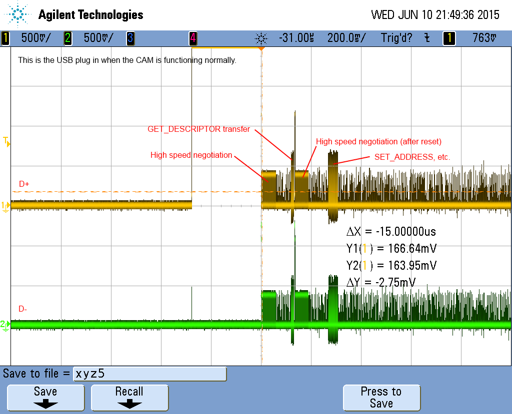

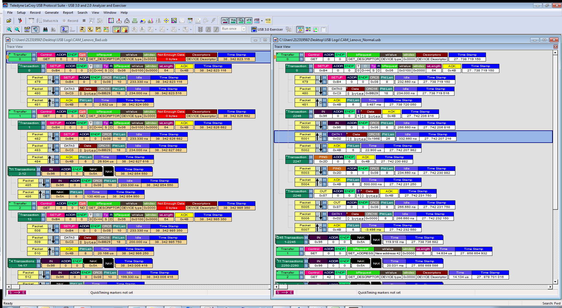

I have attached more messages and information in attachment, please help to check them;
Log of the USB plug in when the CAM is in the bad state*
[80473.421795] usb bus reset!!!
[80473.770441] musb_g_ep0_irq 726: SetupEnd came in a wrong ep0stage setup
[80473.777497] usb bus reset!!!
[80474.004875] usb bus reset!!!
[80474.120324] musb_g_ep0_irq 726: SetupEnd came in a wrong ep0stage setup
[80474.127368] usb bus reset!!!
[80474.350263] musb_g_ep0_irq 726: SetupEnd came in a wrong ep0stage setup
[80474.357304] usb bus reset!!!
[80474.584973] usb bus reset!!!
[80474.910330] musb_g_ep0_irq 726: SetupEnd came in a wrong ep0stage in/status
[80475.124881] usb bus reset!!!
[80475.390321] musb_g_ep0_irq 726: SetupEnd came in a wrong ep0stage out/status
*I've removed my other debug messages from the original log file
