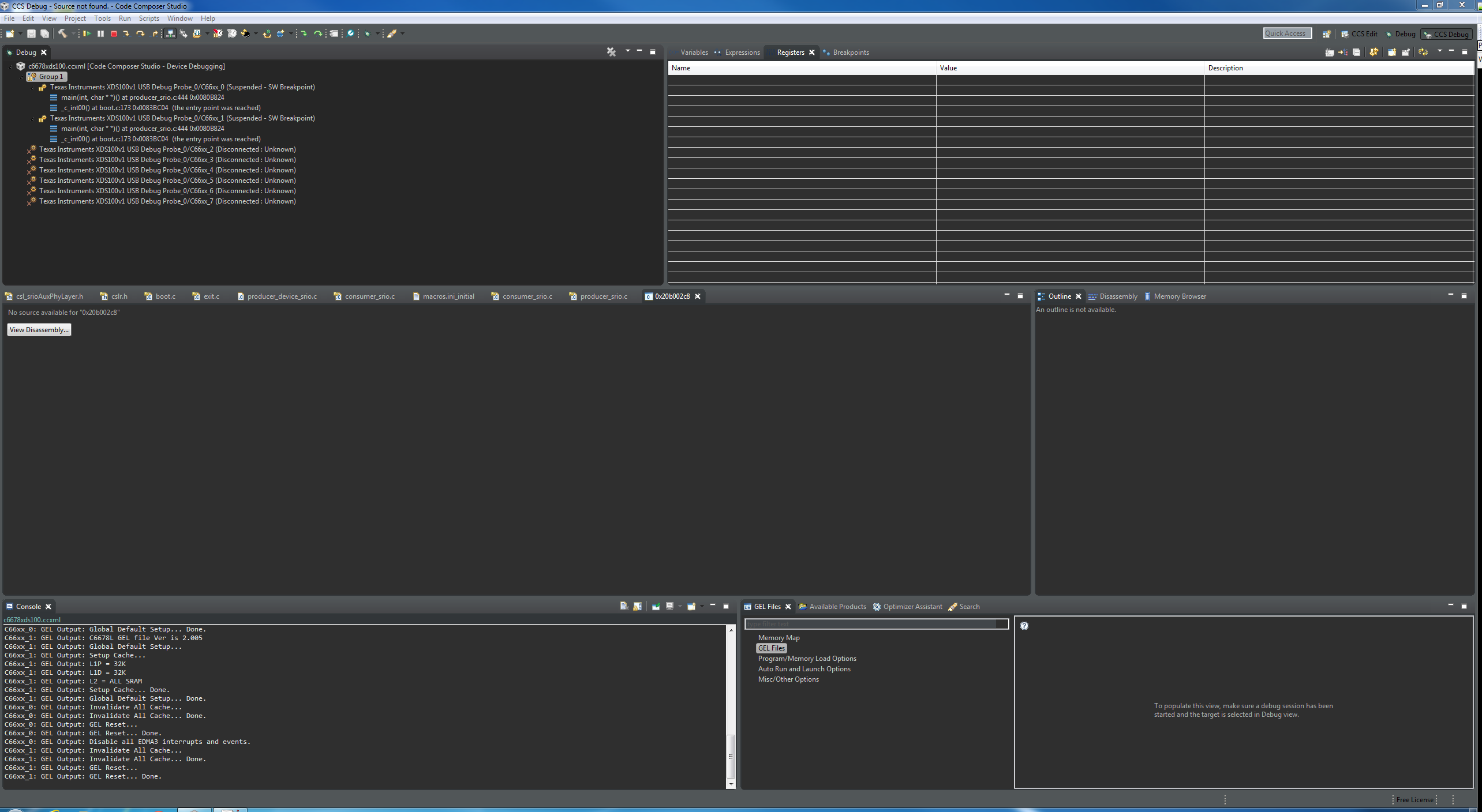

    I have successfully import and build the project. See my screen below:

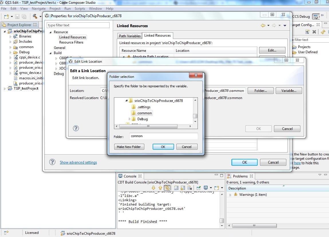

    I try to build your attached project, but srioChipToChipProducer_c6678\common folder is empty on your zip file.
    Have you copy the MCSDK example to your work space? Better to import the example project from default MCSDK path, don't copy to your work space.
    It looks like you are selecting the option, "Copy projects into work-space", when you are importing. The linking error you see in the first case is caused by this because CCS could not copy the 'common' folder due to it being defined with a variable in its path (if you right click on it and select properties, you can see it defined as ${PARENT-1-PROJECT_LOC}\common).
    Follow the below two ways you may try to solve this error:
    1) Import without copying to your work-space and work directly on the directory
    2) Hard copy the "common" folder into your current project location and change the common folder path in project properties. see below image, after this changes i able to built your attached project.
  • Hi Ganapathi,
    Thanks it works, I don't know why the consumer project imports those files but the producer doesn't...

    See below my CCS target configuration file screen shot for your reference:
    I've read the link you posted, and it's said "having two XDS100v1 emulators are not supported". But I also noticed that you're using 2 xds100v1 emulators, so how did you make it work? Also when I run xds100serial.exe only 1 serial # is printed.
    Shang
