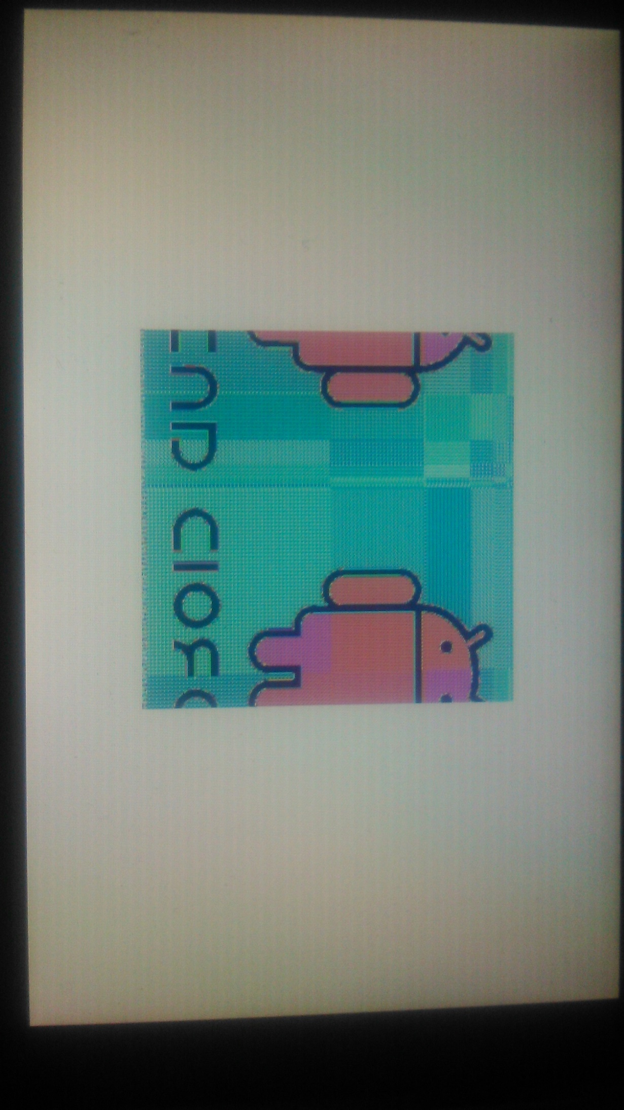

    I have taken splash screen image with BPP8 format 300x300, changed the DSS.DISPC_GFX_ATTRIBUTES register to support the BPP8 images to display. But it is not working as expected, i can see 2 images(BPP8) images, some garbage data on the screen. Trying to figure out any other configuration changes required. All suggestions are accepted to solve this issue.

    The above image is 300x300 pixel, BPP8 format, SPLASH_SCREEN width,height are 300,300.Image is set by U-boot code omap3_fill_framebuffer(). DSS configuration at U-boot, kernel shown in the below table. At kernel BPP24 is used.

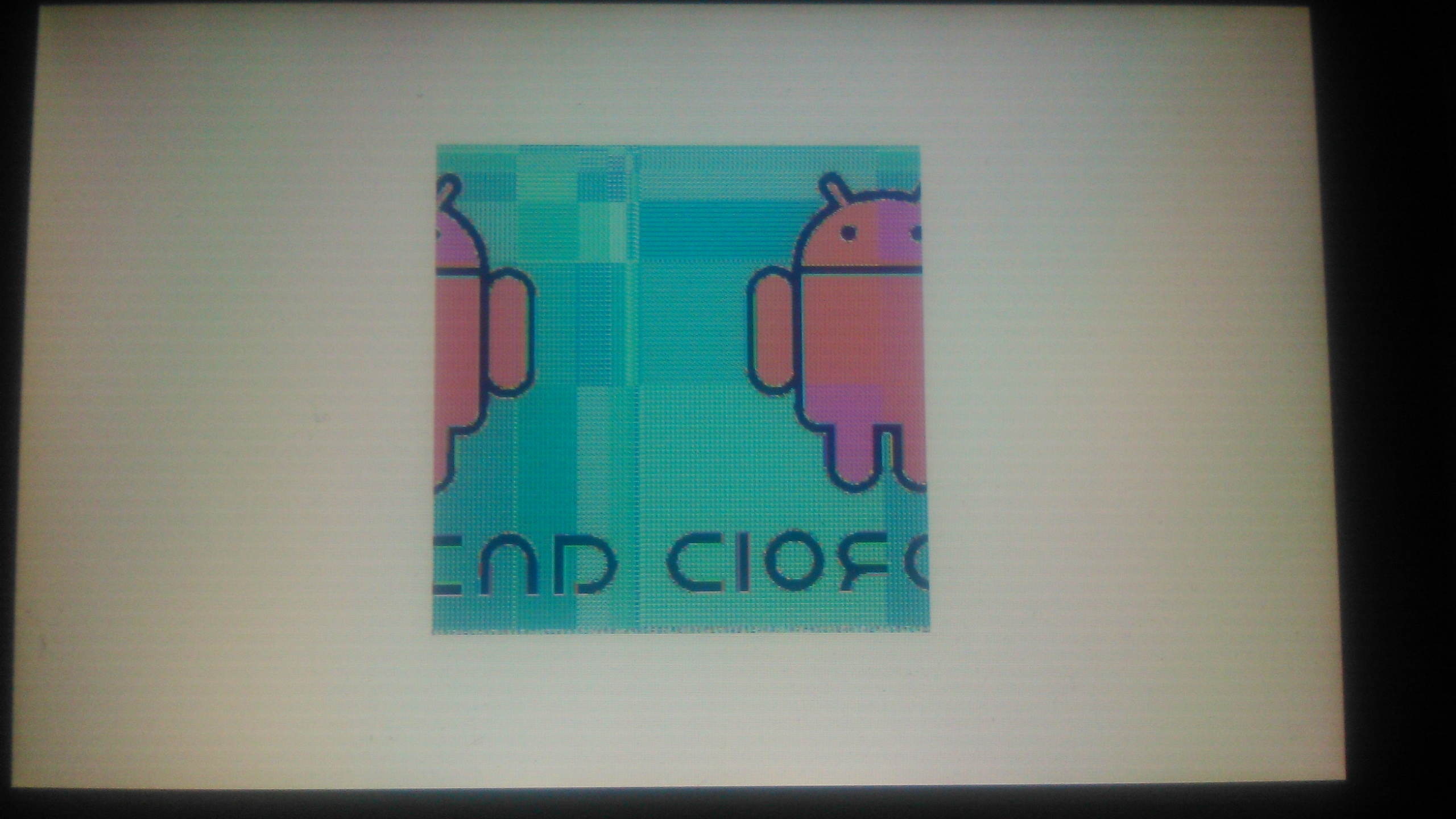

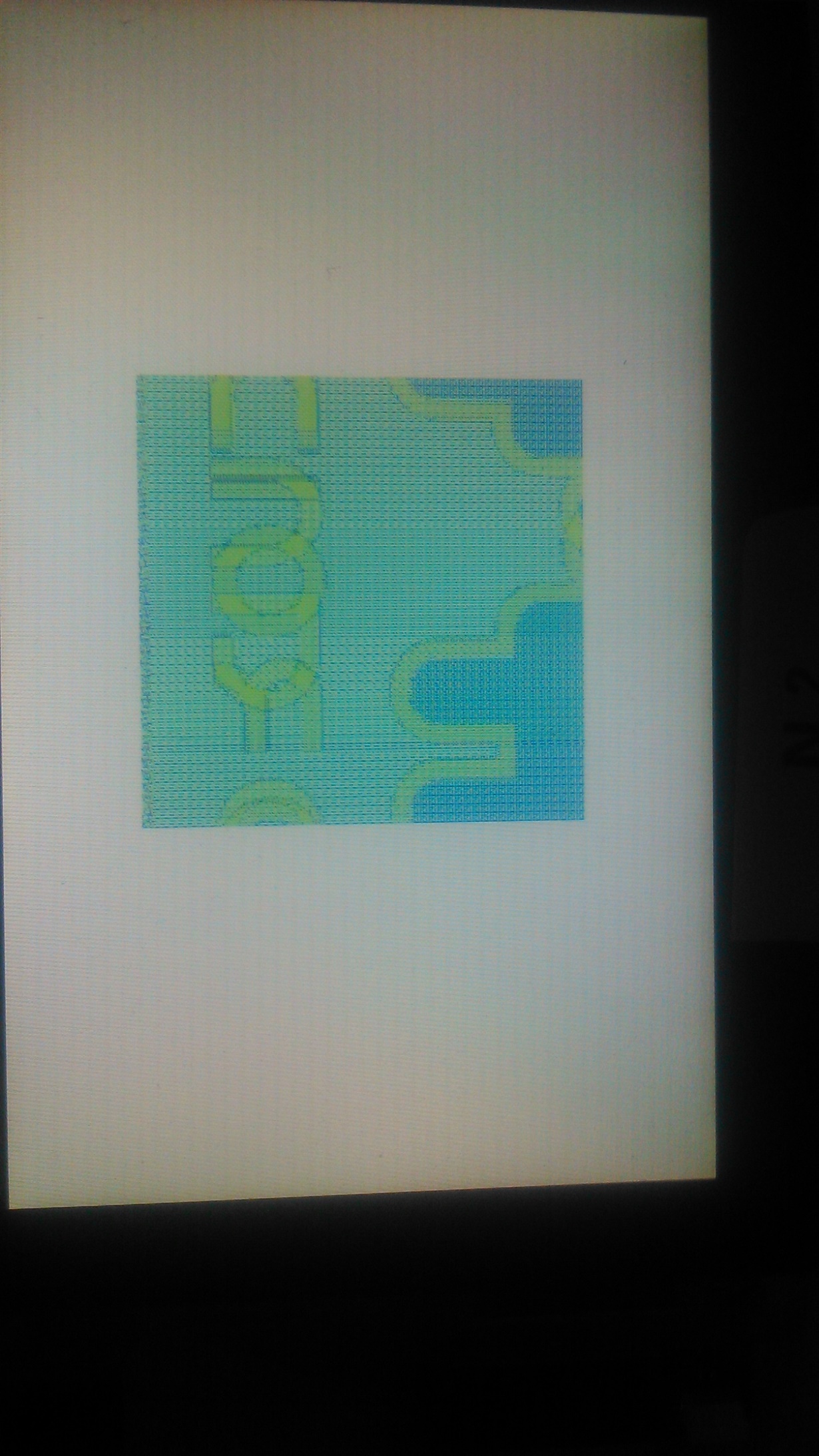

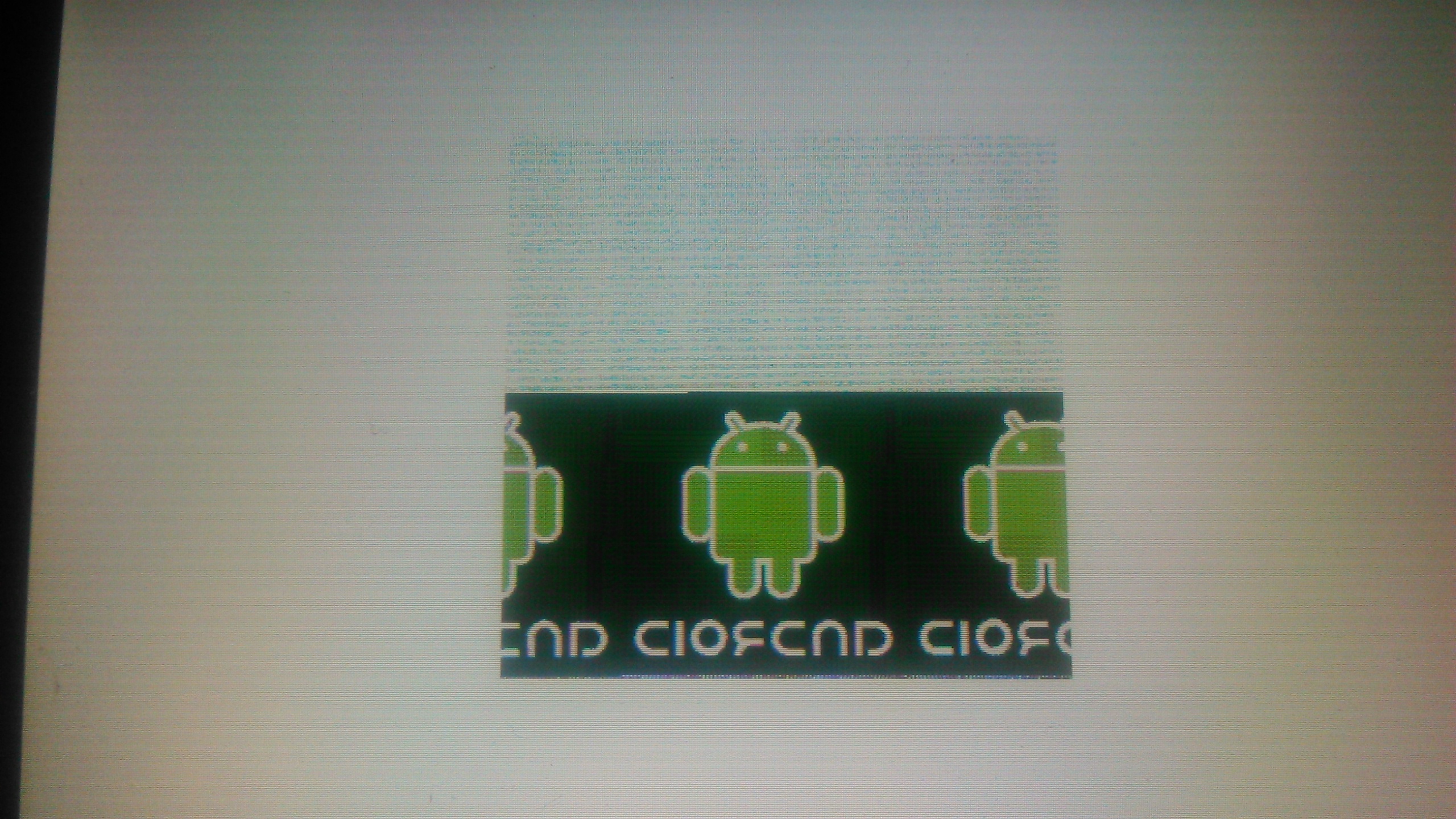

    Below images are captured at Splash screen size : 300x300, BPP8 image data format:
    At GFX_FORMAT : 0x2 BITMAP4 (0x05 is written into the DISPC_GFX_ATTRIBUTES)
    At GFX_FORMAT : 0x6 RGB16(0x0d is written into the DISPC_GFX_ATTRIBUTES)
    At GFX_FORMAT : 0x3 BITMAP8(0x07 is written into the DISPC_GFX_ATTRIBUTES)
