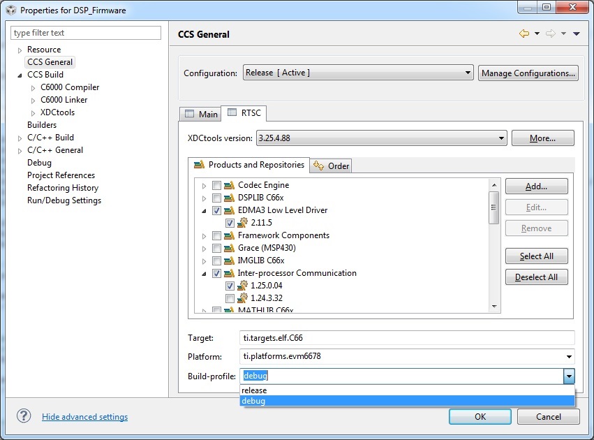

I just integrated NDK into my project and have a weird observation. The last days I worked with Debug Configuration and I was able to ping the C6678.
Today I switched back to Release Configuration, but ping is not possible. I compared both configurations and found out that the behaviour (ping possible or not) depends on the Build-profile under CCS General->RTSC (see below). I am working now with the Release Configuration and just changed the Build-profile to debug and the ping works. Has anyone a suggestion what is the problem with "release".

[Core0] 00:00:01.452 Network Added: If-1:192.168.123.100
[Core0] 00:00:01.457 NetworkOpen()
Thanks for your help
