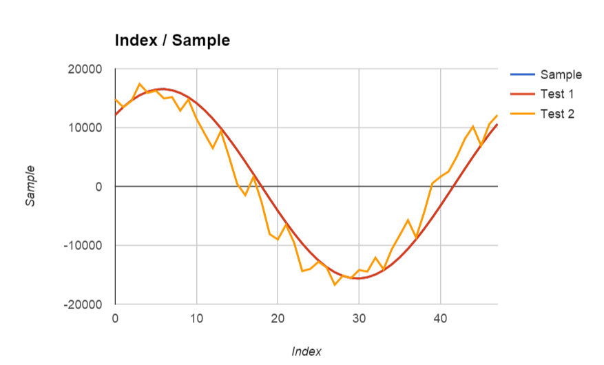

I have been trying to generate a 1 KHz tone, using the EVMOMAP-L137. I started from the spectrum digital AIC Test and slowly tried to combine this with EDMA. Sadly I'm running into issue where my signal sounds and looks noisy,
I'm not doing ping pong but I'm also not doing any processing. If I service the McASP buffers directly in a for loop I get the red line but if I try to configure the EDMA the results looks like the orange line.
I have verified everything that I can, gone through forums and read through the documentation but I can't figure out how to do this with EDMA.
Any suggestions will be greatly appreciated.

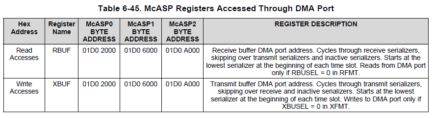

  • Hoffiz,
    Your red line sine wave is much more smooth than I would expect from a sampled waveform. In the orange line drawing, you can see the 10 individual sample points between vertical lines, and there should be that same step size on the red line. So I am wondering exactly what that line represents.
    I do not see the code that sends data directly to the McASP to generate the red line. This would be vital for comparing how your EDMA3 setup is working compared with that code. Please post a copy of that part of the code or point me to where I am missing it in your original post, above. If it is the code that is commented out, that tells me it was not running, so it is hard to figure out a comparison; if that is all I am missing, please let me know.
    For a test, please try changing the EDMA3 destination address to a memory buffer area and also change the SRCBIDX to 2 so the pointer will increment. Just store it all in a single linear buffer, even if you have to change the LINK field to 0xFFFF so it stops after one sine wave. Please post the samples from that buffer, which will confirm what actual data is being sent out to the McASP XBUF5 port.
    When using the DMA transfer method, accesses should be made using the XRBUF locations with XBUSEL=0 in XFMT. Below from the C6747 datasheet (same as L137 in these respects), respectively.
    I am not sure how this would affect the data as shown, but using the XBUF address is the correct way to use the EDMA3 for writing to a McASP.
    We will continue looking at this after you can capture those output samples being sent to XBUF and also to the RAM buffer. And I will try to follow your commented code with your help.
    RandyP
