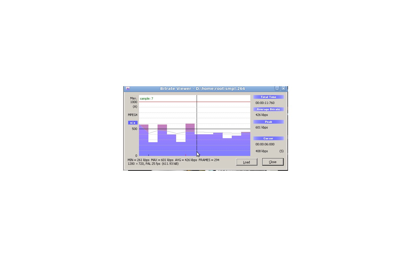

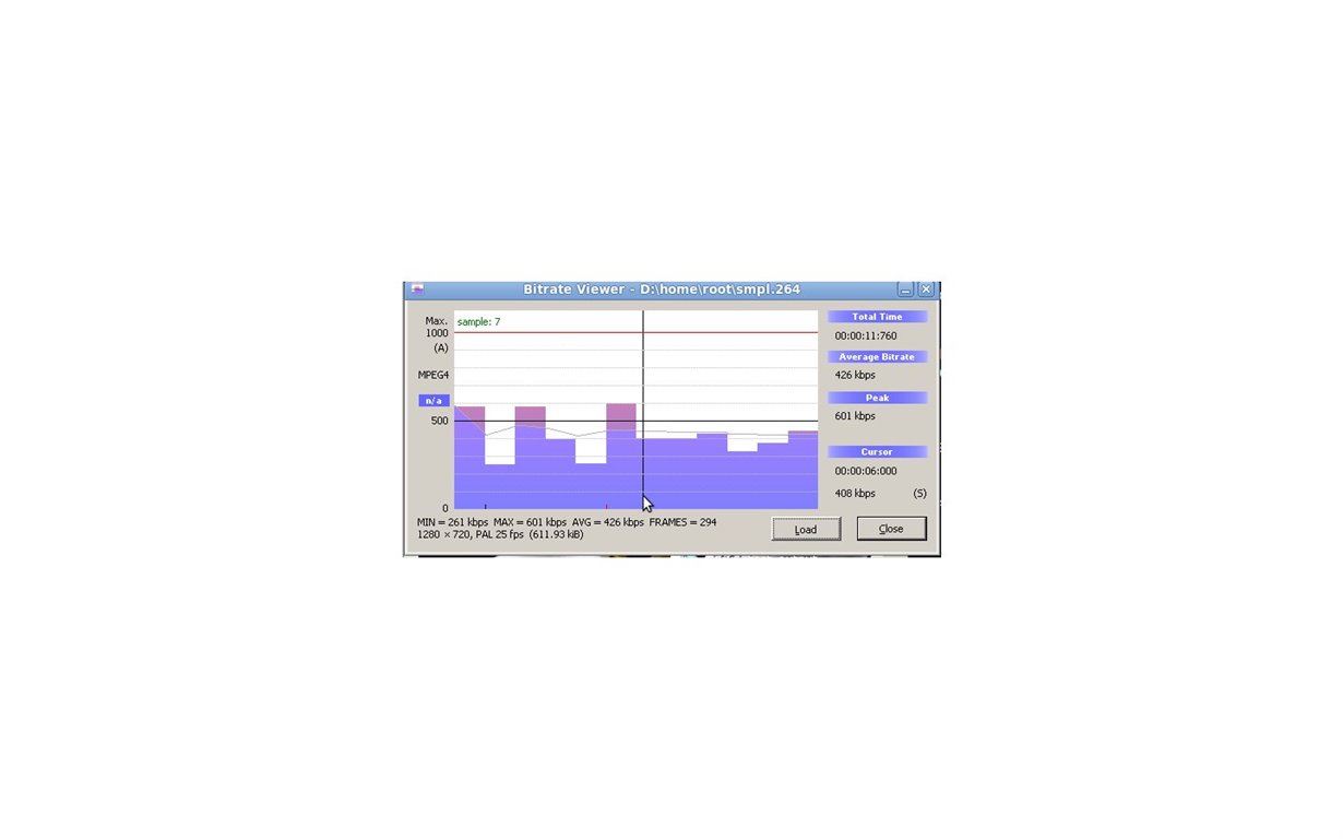

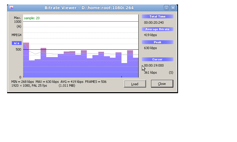

Hi All,
We have developed our own DM8168 based H/W, and using EZSDK version 5.05.02.00.
In our board we are able to achieve the CBR in Progressive video input, but when we feed the
interlaced video input, the O/P bitrate is twice the given bitrate.
Can any one tell us why this is happening in the Interlaced input?
H264 settings 'c' file attached for reference.
we have tested with 1080i50 / 60 and 576i all the resolutions are behaves the same.
Please help us to resolve the issue.

    Here is what I am seeing.
    BR
    Margarita

    Here is what I am seeing for bitrate:
    Here is the encoded video:
    smpl.264.txt
    BR
    Margarita

  • Hi Margarita,
    Did you get a chance to verify my encoder settings ?
    Please HELP us to resolve this issue as soon as possible.
    R.Abdul Rahman.

    When the intraFrameInterval is set to 1 all the frames are I. But for 500kB the quality is very low depending on the how complex are the scenes.
    BR
    Margarita
  • Hi Margarita,
    Thanks a lot for your settings.
    But this also did not resolve the issue.
    we also tried settings maxPicSizeRatioI = 1;
    we are very much concern about the Breathing effect please help us
    to resolve the breathing issue first.
    Do you thing the GDR will help us to resolve the breathing effect
    if so please give us the GDR settings we will try that and let you know.
    FYI: we are ready to compromise the Quality but we are very much concern about the Breathing effect issue and the Bitrate jumping
    R.Abdul Rahman

  • Hello Margarita,
    No, we talking about the CBR Only
    say for example if the intraFrameInterval is < 10 we are seeing the breathing effect ( The Quality of the I frame is less compare to P frame in lower bitare (in CBR mode).
    R.Abdul Rahman
  • Hello Margarita,
    FYI :
    Basically we are facing following issues in CBR mode
    1. if we set the intraFrameInterval=1 the o/p bitrate goes high
    2. if we set the intraFrameInterval < 10 we are seeing the breathing effect ( basically the I frame Quality is less compare to P frame)
    3. The Bitrate is double while we try to Encode the Interlaced video.
    R.Abdul Rahman.
    This behavior is not expected. Can you cross check the output filesizes generated for progressive & interlace for same no of frames (i.e 30 frames,60 fileds).
    If its still not clear & you are expected the double the bitrate, please send me those bistreams.
    Gajanan
    Could you check my previous posts, with intraframeinterval =60 , 90 I lined you a image with bitrate viewer that the video with you share with me the bitrate is ~ 500 KB.
    Also check again maxPicSizeRatioI as I said in some of my previous posts, probably that is why I am not seeing this effect.
    What is the encoder version that you are using?
    Let me know the results.

    My major issues are
    1. Breathing Effect ( the quality of ' I ' frame ) we tested this with "IPQualityFactor" settings
    it is not giving the expected result
    2.Bitrate variation - the Expected bitrate variation is +/- 50 Kbps, bit it goes beyond that based
    on the Image complicity ( we noticed that the Bitrate is going high only for 'I' frame ) so we hoping
    if we fix the ' I ' Only frame coding with the desired bitrate this issue will be fixed.
    On my side maxPicSizeRatioI was set to 640.
    I also tried intraframeInsteval=90 here is the bitrate with the video which you shared with me:

  • Hello Margarita,
    I used your settings still the output bitrate is bumping while encoding the complex video.
    and referred the Link.
    Here our problem is CBR is working but it is not strictly following the Output bitrate.
    This problem is not only in Lower bitrates , it is happening in higher bitrates also
    example 4000kbps is my target bitrate but sometime it goes upto 4300kbps.
    R.Abdul Rahman
  • Hi abdul,
    1. For I frame if bitrate is going high then reduce the value of the maxPicSizeRatioI.
    2. If you are using the rateControlParamPreset = userdefined then ,
    set qpMaxI = 51, qpMaxP = 51
    This may resolve your bitrate issue.
    Gajanan
  • Hi Gajanan,
    Thanks for your suggestion.
    But this is also not resolved my problem.
    The output bitrate is still bumping beyond the fixed level.
    ( I need the strict CBR output)
    for example the target-bitrate is 512kb means it should give the output bitrate <= 512kb
    but the current encoder output is goes up to 750kb.
    Please share your Ideas to fix this issue.
    If you have any encoder settings for CBR Please share with us.
    Thanks a lot for your help.
    R.Abdul Rahman
  • Hi Abdul,
             Can you share your bit-stream where you had observed the bit-stream shootup.
    I can analyse & provide feedback. This will be faster solution.
    Gajanan
  • Hi Gajanan
    File attached for your ref.
    Please do the needful
    BitStream.zip
    R.Abdul Rahman
  • Hi Abdul,
             For the attached bit-stream bit-rate is achieved even with 60fps configuration.
            The stream is very complex & 500kbps for this stream is difficult to achieve with decent quality. To achieve bit-rate in worst cases any encoder will do below things. If its not possible with below settings we need to increase the bit-rate.  I guess you are setting encoder with 60fps which even degrades the quality to achieve the bit-rate.
    1 - use maximum QP = 51
    2 - use frameskips for P frames
    Gajanan
  • Hi Gajanan & Margarita,
    I have tried all the settings suggested you both. but none of them helped us to resolved the issue.
    so we planned to reduce the FPS (example 15 FPS), but if i set the lower FPS then the output bitrate goes
    higher than the full fps bitrate.
    Can you please help us to resolve the issue.
    R.Abdul Rahman
