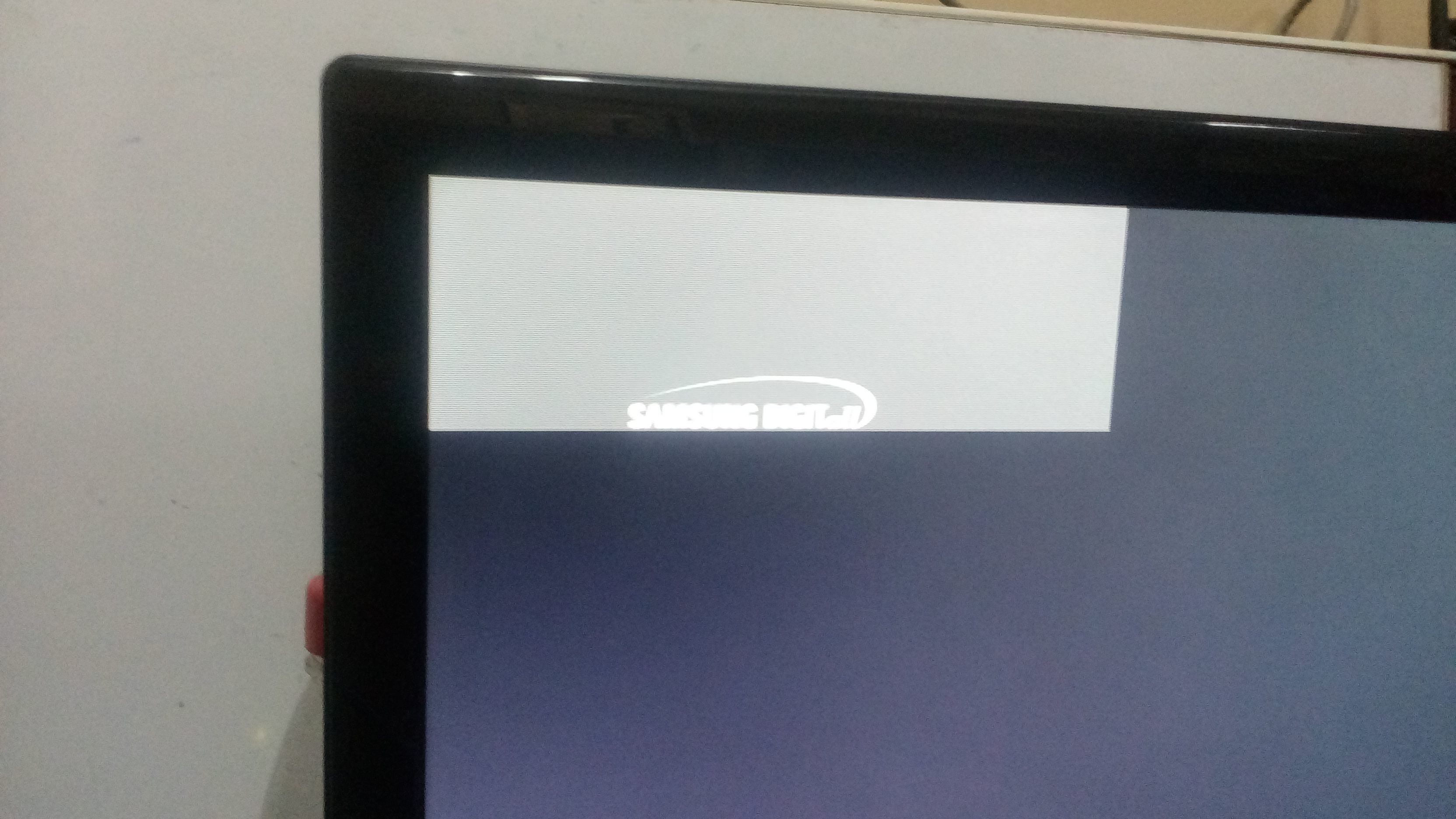

Hi All,

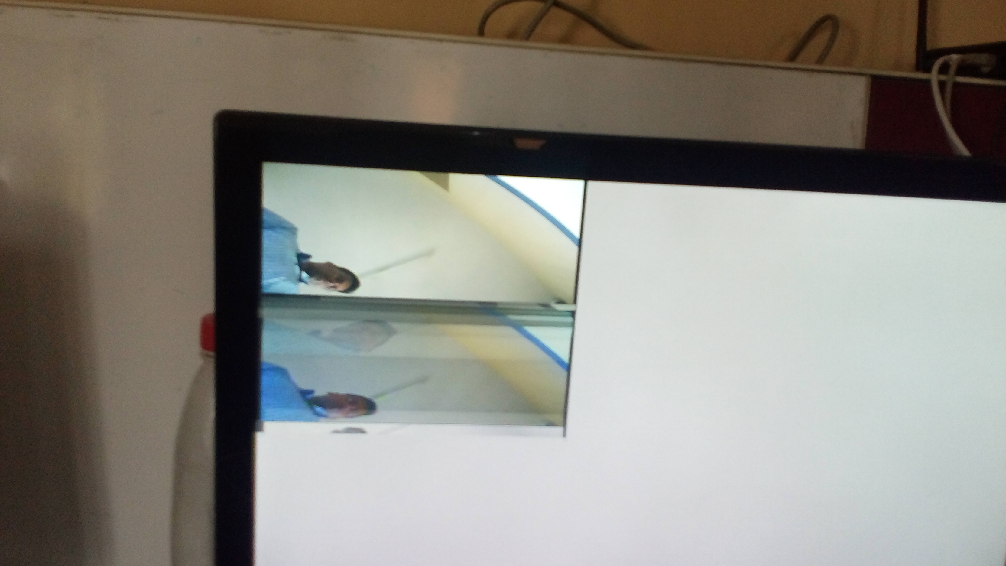

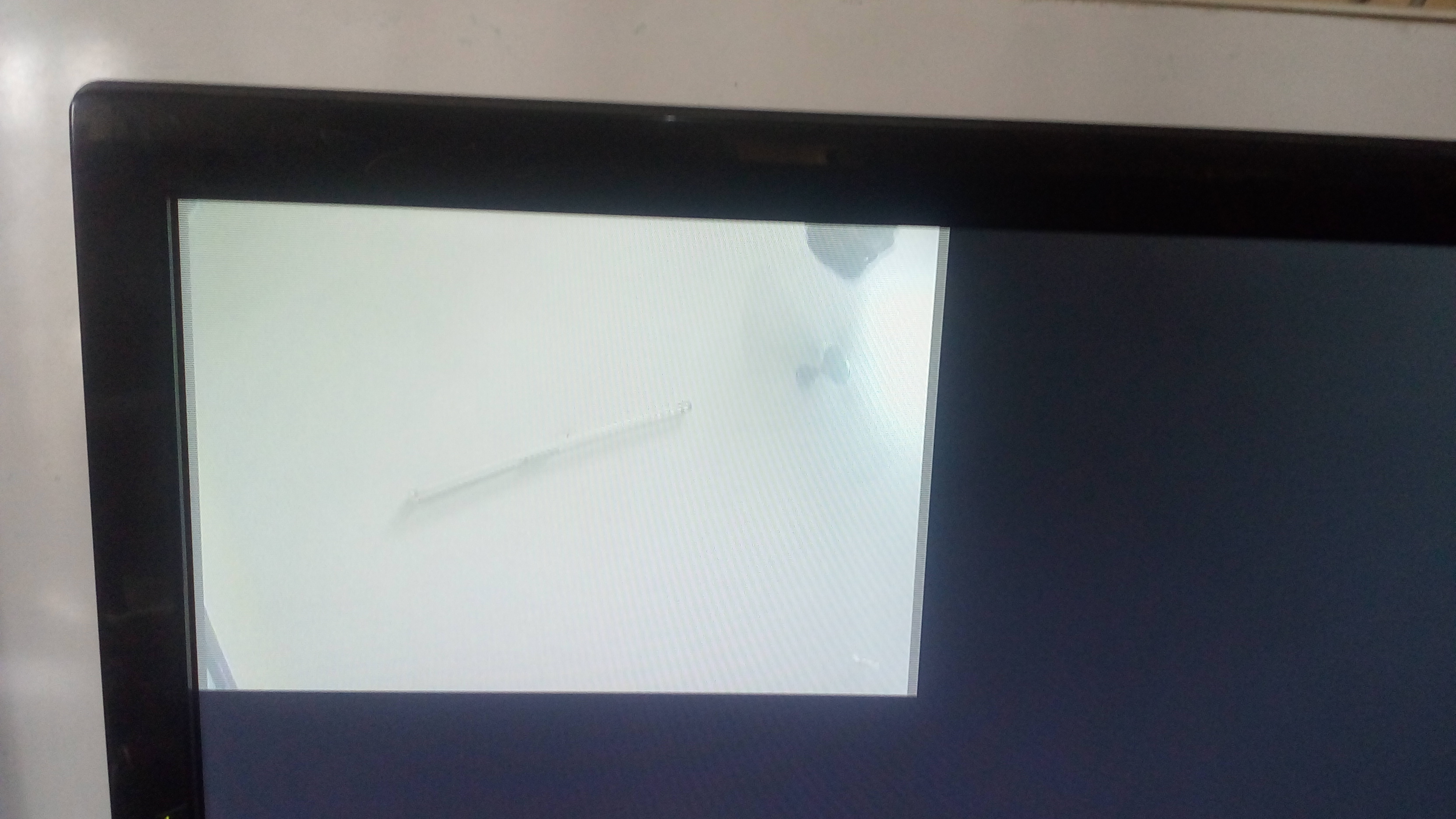

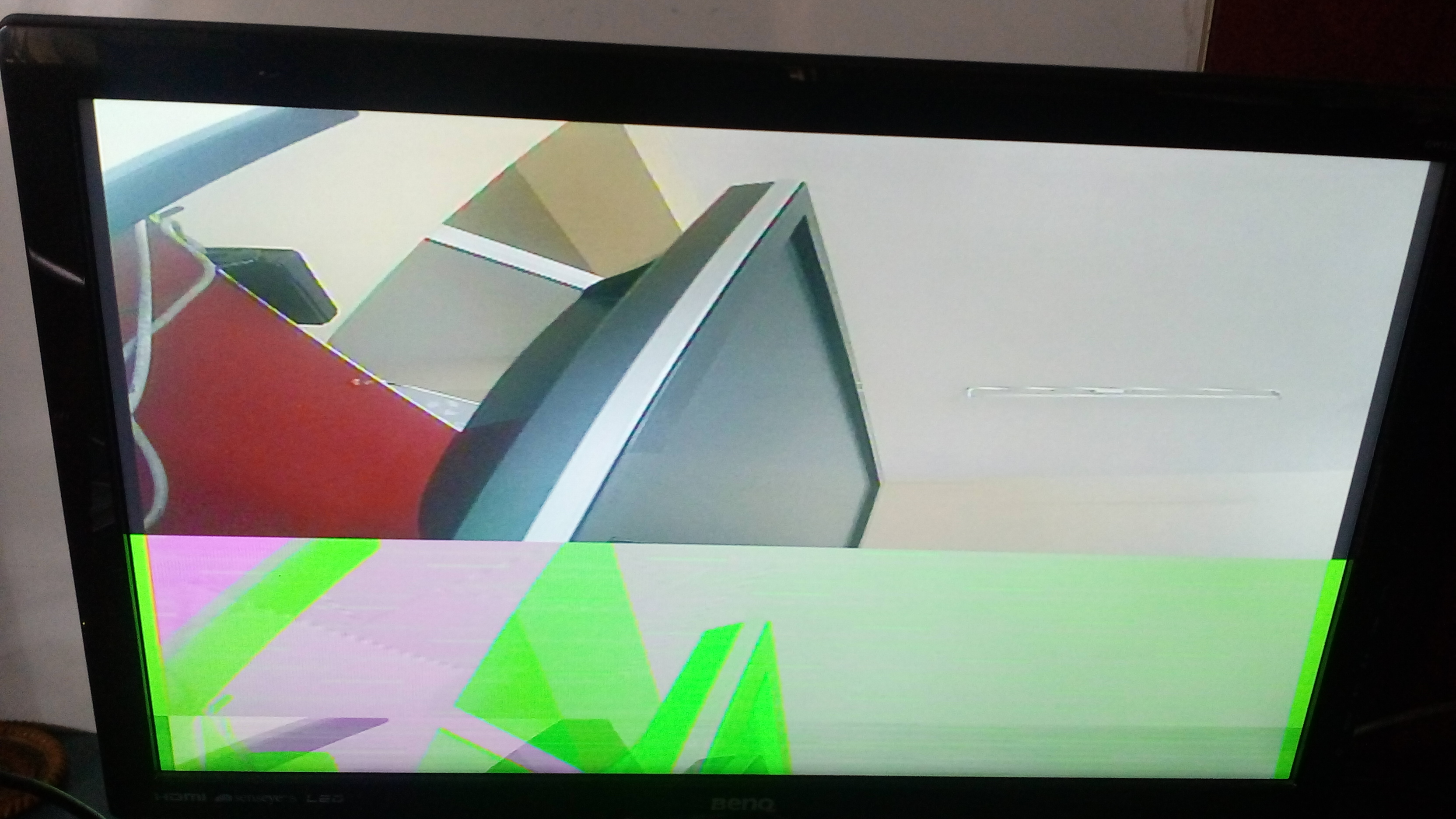

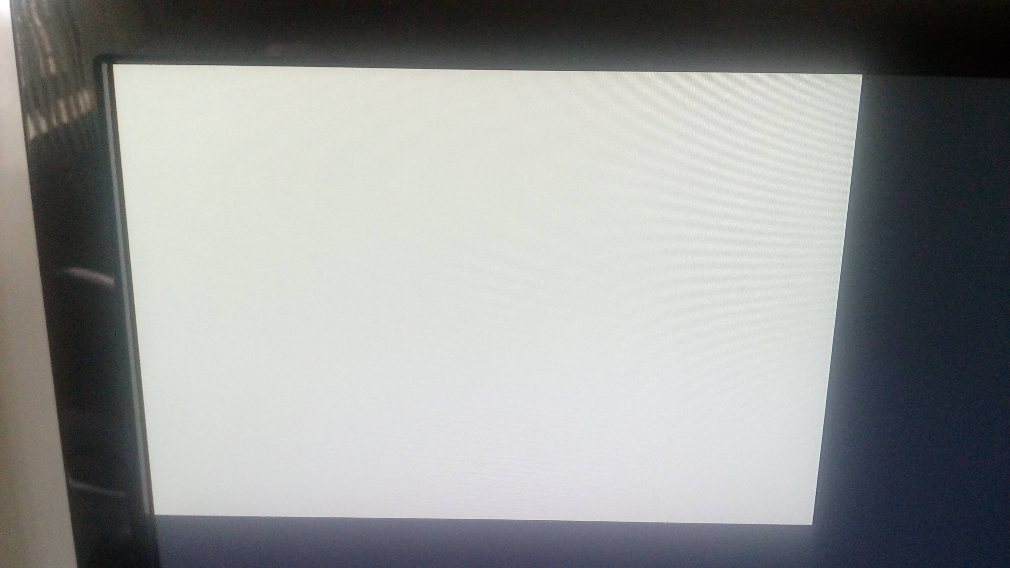

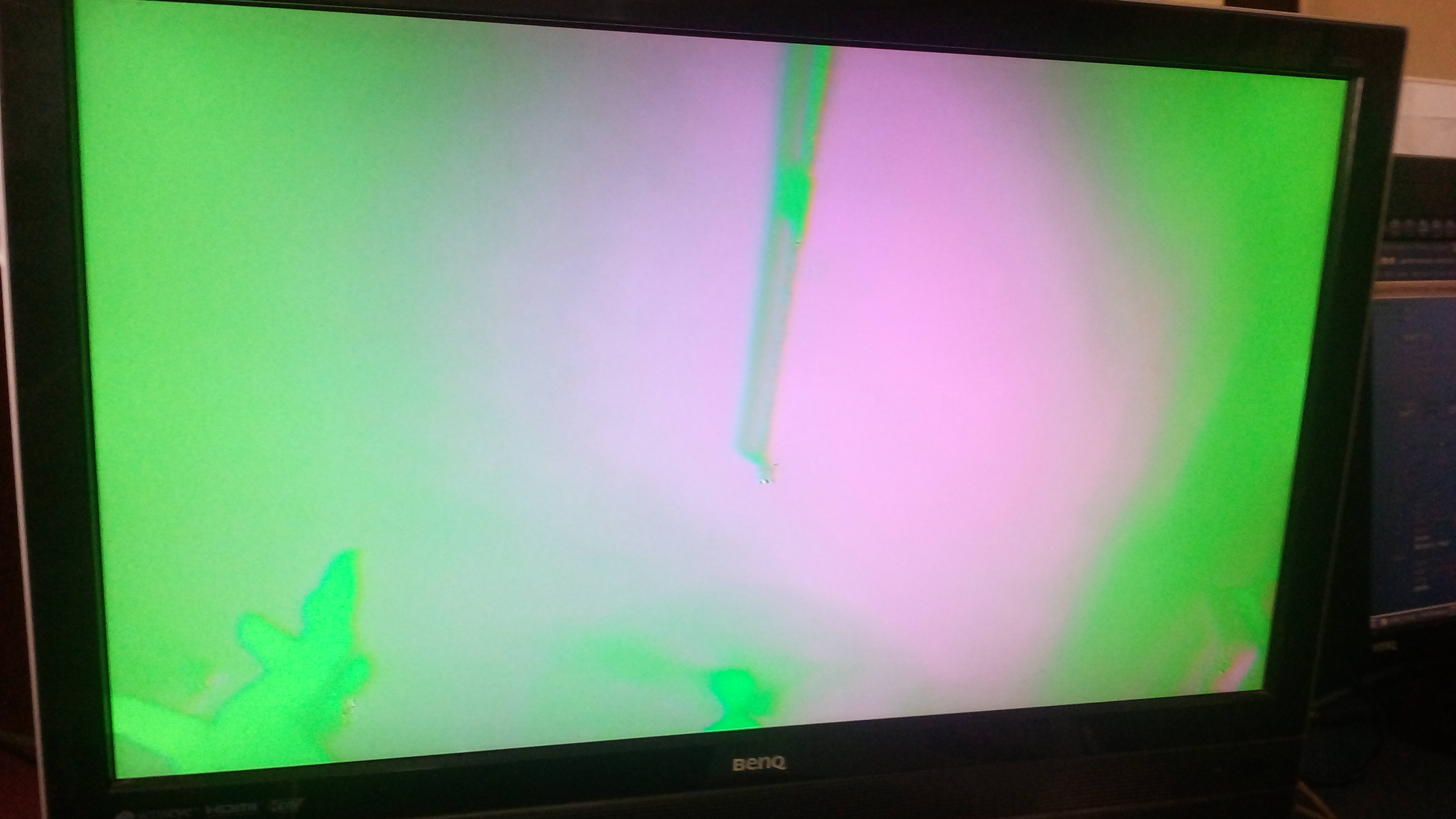

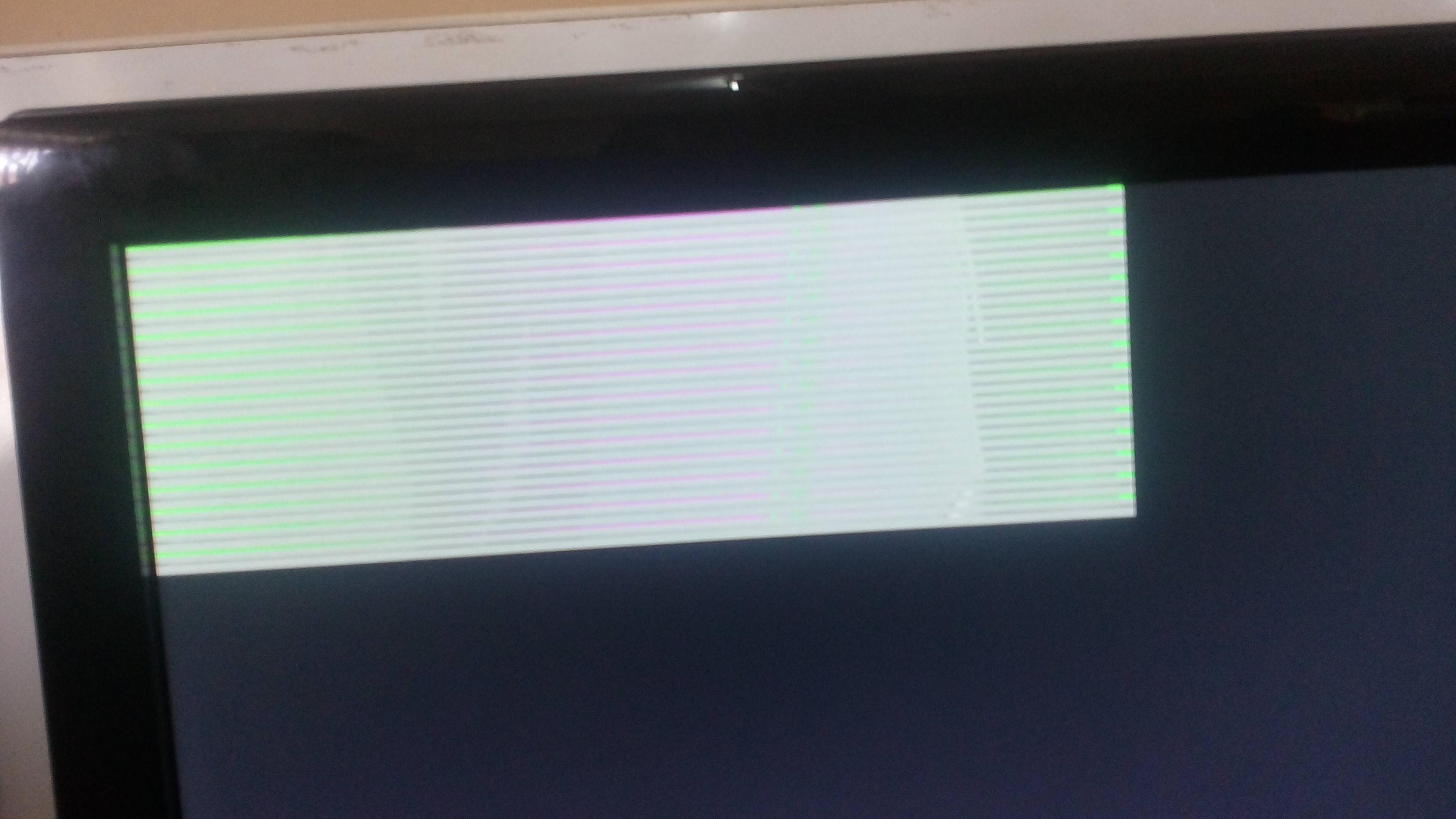

I'm working customized DM385 platform.
Analog capture --> DEI ---> Scaler ---> display
My usecase is getting input from Analog camera and displayed  interlaced scanformat in LCD display
But  I want to display in progressive scanformat. Then I added deinterlacer to convert the scan format !!!
For scaler to convert and give SYSTEM_DF_YUV422I_YUYV fomat to display
But I did n't !!!
I mentioned the logs kindly let me know the results !!!

    We have not tested the DEI link in the IPNC RDK.
    Can you pl. share your complete use case and the display screen shots?
    I will check with the DVR RDK team.
    regards,
    Anand
  • Hi Anand,
    Thanks for your reply ...,
    My Usecase is Input from the decoder (720 * 240 )------> Analog camera ------> DUP ------> Encode ------> display (Now HDMI) (YUV420 SP format)
    In HDMI I'm getting Interlaced output... I'm trying to convert Progressive scan format ???
    Whether I can convert from CaptureLink_drv file and send to next link ??? or Convert in usecase file using Deinterlacer ???
    I'm in IPNC RDK 3.5 Is it support to do the conversion ???   Find the attached usecase file .
    Rajesh Kannan.S

  • Hi Anand,
    In IPNC RDK  file location
    ipnc_rdk/ipnc_mcfw/mcfw/src_bios6/links_m3vpss/capture/captureLink_drv.c
    I tried to merge the fields into frames by using the following ioctl API before storing the buffers
                           Vps_CaptStorageParams StoragePrms;
                           StoragePrms.channelNum = 0;
                           StoragePrms.bufferFmt = FVID2_BUF_FMT_FRAME;
                           StoragePrms.fieldMerged = 1;
                           status = FVID2_control(pDrvObj->captureVipHandle,IOCTL_VPS_CAPT_SET_STORAGE_FMT, &StoragePrms, NULL);
                           Vps_printf("RAJESHKANNAN : Checking ###status### value = (%d)\n", status);
    I'm getting the successful value but still output is 720 * 240  !!! ( The output is interlaced )
    I'm expecting 720*480 ????
    Kindly suggest ???
    Rajesh Kannan.S
    Find the attached screenshot

  • Hi Anand,
    I setted the std FVID2_STD_480I here it's  ( In captureLink drv) setting the pObj->maxHeight = 240;
    But I want to display as 720*480
    Now I'm getting 720*240 but the image is in zigzag view  it's going up and down ???  In down unable to see ???
       if(format.height < CAPTURE_LINK_HEIGHT_MIN_LINES)
                   format.height = CAPTURE_LINK_HEIGHT_MIN_LINES * 2;    // Here I doubled the height
               format.pitch[0] = pOutInfo->pitch[0];
               format.pitch[1] = pOutInfo->pitch[1];
               format.pitch[2] = pOutInfo->pitch[2];
               format.fieldMerged[0] = FALSE;
               format.fieldMerged[1] = FALSE;
               format.fieldMerged[2] = FALSE;
               format.dataFormat = pOutInfo->dataFormat;
               format.scanFormat = FVID2_SF_PROGRESSIVE;
               format.bpp = FVID2_BPP_BITS8;                  /* ignored */
     [m3vpss ]  RAJESHKANNAN : CAPTURE:ALLOCINFO: FMT[7]  / PITCH[736] / HEIGHT [576]  / NUMBUFS[10]
    Getting Height as 576
    Need to change the pitch value or field merge ?
    Kindly suggest ???
    I attached the Image
    Pl. undo the height doubling that you did in the 'CaptureLink_drvAllocAndQueueFrames()' fn and instead double the pitch in the 'CaptureLink_drvCreateInst()' fn before FVID2_create() fn call:
    pVipOutPrm->pitch[0] *= 2;
    pVipOutPrm->pitch[1] *= 2;
    regards,
    Anand
  • Hi Anand,
    //pVipOutPrm->pitch[0] = VpsUtils_align(pObj->maxWidth, VPS_BUFFER_ALIGNMENT * 2);
    pVipOutPrm->pitch[0] *= 2;   //FOR TESTING JULY_1
    //pVipOutPrm->pitch[1] = pVipOutPrm->pitch[0];
    pVipOutPrm->pitch[1] *= 2;  // FOR TESTING JULY_1
    After changed the pitch value I'm getting the following log
    pitch value is 0 !!!
    [m3vpss ] RAJESHKANNAN : Checking maxHeight = 240
    [m3vpss ] RAJESHKANNAN : Checking else to change the capture mode from 16 to 8 bit
    [m3vpss ]  10313: CAPTURE: VIP0 PortA capture mode is [ 8-bit, Non-mux Embedded Sync] !!!
    [m3vpss ] RAJESHKANNAN : Checking ###pitch[0] = 0
    [m3vpss ] RAJESHKANNAN : Checking ###pitch[1] = 0
    [m3vpss ] RAJESHKANNAN : In Fn CaptureLink_drvAllocAndQueueFrames Entered......
    [m3vpss ] RAJESHKANNAN : ###Checking format scanFormat (0 to interlaced )= 6664
    [m3vpss ] RAJESHKANNAN : ###Checking format maxwidth = 720
    [m3vpss ] RAJESHKANNAN : ###Checking format maxheight = 240
    [m3vpss ] RAJESHKANNAN : Checking After changed the height = 288
    [m3vpss ] CAPTURE:ALLOCINFO:FMT[7]/PITCH[0]/HEIGHT[288]/NUMBUFS[10]
    [m3vpss ] RAJESHKANNAN : Checking ###status### value = (0)     //  IOCTL success

  • Hi Anand,
    After Added the pitch value before FVID2_create () I got the attached image for your reference
       pVipOutPrm->pitch[0] *= 2;   // FOR TESTING JULY_1
       pInst->captureVipHandle = FVID2_create(FVID2_VPS_CAPT_VIP_DRV,
                                              pInst->instId,
                                              pVipCreateArgs,
                                              &pInst->createStatus, &pInst->cbPrm);

  • Hi Anand,
    I understood ..,
    After increased the height value in Fn CaptureLink_drvCreateInst()  and doubled the height into two..,
    I got 720 * 480 but still the video scanformat in INTERLACED
    The filed merge is not happened !!!
    The structure FVID2_Format says that the fieldMerged
    /**< This field tells whether both the fields have to be merged,
    i.e line interleaved or not.
    Used only for interlaced format. The effective pitch is calculated
    based on this information along with pitch parameter. If fields are
    merged, effective pitch = pitch * 2 else effective pitch = pitch. */
    Can I try this to merge the fields into frames ???  It will take effect ???
    Find the Image
    It looks like proper filed merged image.
    Where are you checking the scanFormat?
    If the next link is checking for the scanFormat then you need to set 'pQueChInfo->scanFormat = FVID2_SF_PROGRESSIVE;' in the CaptureLink_drvCreateInst() fn so that the next link will treat the frames as progressive.
    regards,
    Anand
  • Hi Anand ,
    In Encoding side, I was Checking the scanFormat  INTERLACED ..,
    After changed the  pQueChInfo->scanFormat = FVID2_SF_PROGRESSIVE I'm getting the scan Format PROGRESSIVE it's showing
    [m3vpss ] CAPTURE:ALLOCINFO:FMT[7]/PITCH[736]/HEIGHT[576]/NUMBUFS[10]
    [m3video] 10408: ENCODE: Creating CH0 of 720 x 480, pitch = (736, 736)  [PROGRESSIVE]  [NON-TILED ], bitrate = 8000 Kbps ...
    But still the screenshot looks like the fields are not arranged properly ???

  • Hi Anand,
    Find the attached file for your reference ..,
    I think the field's are coming but not interlaced properly..,
    Rajesh Kannan.S
    Image.tar.gz

  • Hi Anand,
    In Fn(CaptureLink_drvCreateInst) I multiplied the pitch value into two I'm getting
       pQueChInfo->pitch[0] = pVipOutPrm->pitch[0] * 2; //TESTING JULY_3
       pQueChInfo->pitch[1] = pVipOutPrm->pitch[1] * 2;
       pQueChInfo->pitch[2] = pVipOutPrm->pitch[2] * 2;
    the progressive (Field merged )attached Image but not 720*480
    Kindly suggest ????
    Rajesh Kannan.S
  • Hi Anand,
    In my usecase I added scaler link to upscale the incoming data (720*480 to 1080P)
    I tried before converting to progressive .., scaler was not effected
    But now It's upscaling..., Still I'm facing the same problem for field merge !!! I attached the image for your reference..,
    Kindly give some suggestion to solve this issue..
    Rajesh Kannan.S

  • Hi Anand,
    As per your suggestion I added Deinterlacer in my usecase I'm getting the following logs !!
    For first case it's getting success then it's failing alternatively ..,
    After dei, the data is not entered to next link !!!
    In display side I'm getting 720 * 480 blank white screen
    I attached the usecase file for your reference

  • Hi Anand,
    In deinterlacer Whatever the input scanformat( in my case INTERLACED) is coming it's taking either only odd scanlines or even scan lines whenever the NEWDATA arrives..,
    Here also Field Merge not happened ???
    Is it a way to implement the merge the fields and convert to progressive ???
    Give me some suggestion
    I attached the Image kindly reply..,
    Rajesh Kannan.S
    Can you pl. undo the changes done for merging the two fields in the capture link?But keep the standard as 480I in the use case.
    The Deinterlacer generates a full frame out of every field,so that for 60 fields per sec input it will output 60 frames per sec.

  • Hi Anand,
    I undo the changes in Capture side and enabled the SYS_STD as 480I in usecase
    In Encoding side I'm seeing the scanformat as progressive but still I'm getting the same blank white screen (Jul 8, 2015 10:07 AM post)
    Kindly suggest ???
    Rajesh Kannan.S

  • Hi Anand,
    I tried Capture->DEI->Display usecase but in display side It's expecting YUV420_SP format only in HDMI
    That is the reason I added Noise filter to change the data format..,
    I enabled the below mentioned macros for main and substreamer. Are you telling to change sub_streamer value to DEI_LINK_OUT_QUE_DEI_SC ???
    #define DEI_OUT_MAIN_STRAMER (DEI_LINK_OUT_QUE_DEI_SC)
    #define DEI_OUT_SUB_STRAMER (DEI_LINK_OUT_QUE_VIP_SC)
    Rajesh Kannan.S
    HDMI Display should work for YUV422I format.Pl. change the displayId to 'DISPLAY_LINK_DISPLAY_BP0'.
    Pl. enable DEI_LINK_OUT_QUE_DEI_SC output queue for DEI.
    regards,
    Anand
  • Hi Anand,
    After changed the output queue DEI_LINK_OUT_QUE_DEI_SC and display id to DISPLAY_LINK_DISPLAY_SD
    I think it's merged Kindly check and let me know
    I'm getting the following Image it's showing green colour
    In display side I'm getting the scan format SYSTEM_DF_YUV422I_UYVY value is 0 !!!
    Kindly suggest !!!
    Rajesh Kannan.S
  • Hi Anand,
    I forgot to tell u one thing If I changed the display id to DISPLAY_LINK_DISPLAY_BP0 in HDMI, unable to see the the data in display side..,
    If I changed to DISPLAY_LINK_DISPLAY_SD I can able to see the data in display side ..,
    Rajesh Kannan.S
    The DEI output frames are in YUV422I_YUYV format and this is supported by 'DISPLAY_LINK_DISPLAY_BP0' display path.
    But the SD display may be displaying it as YUV422I_UYVY format hence you see that the luma and chroma data are swapped.
    Pl. check if the HDMI display link is skipping the incoming frames in the 'DisplayLink_drvProcessData()' fn.
    regards,
    Anand
  • Hi Anand,
    In display side .., Is properly entered and return successfully...,
    There is no frame skipping in HDMI display side !!!!
    Rajesh Kannan.S
