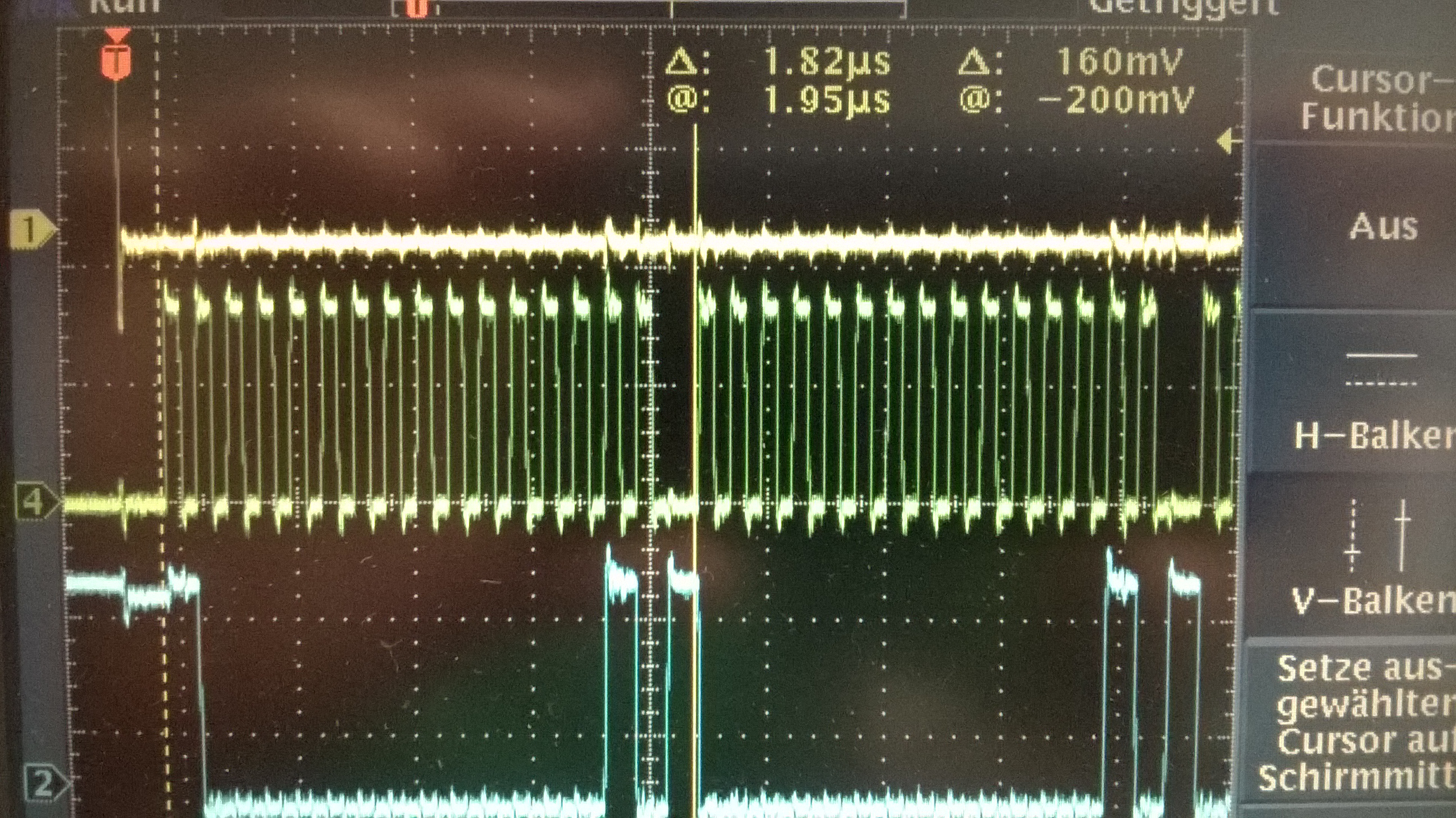

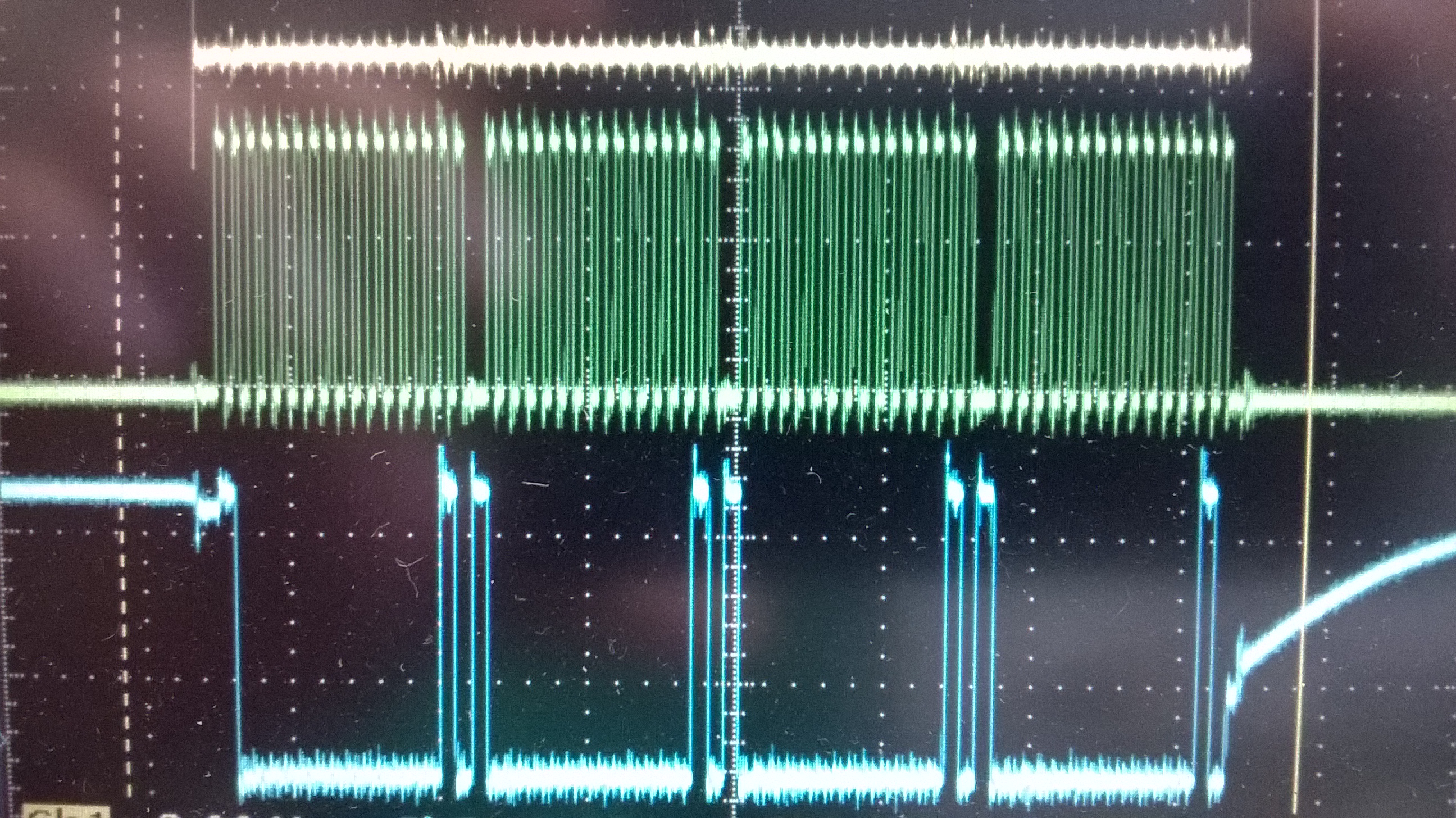

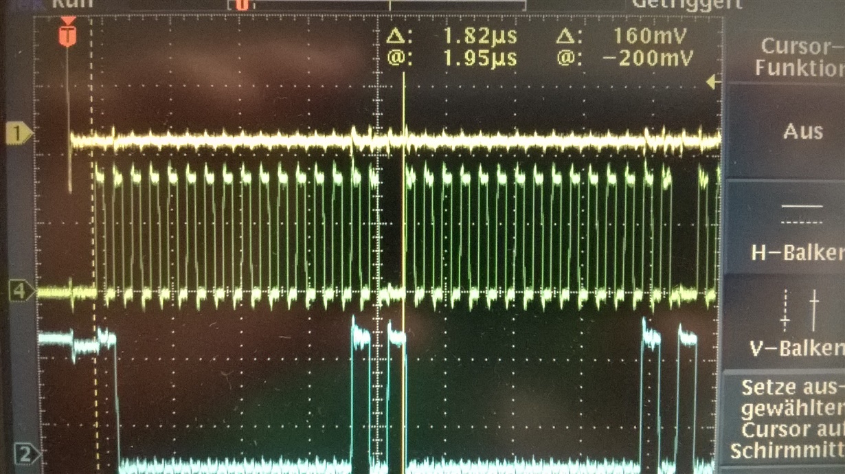

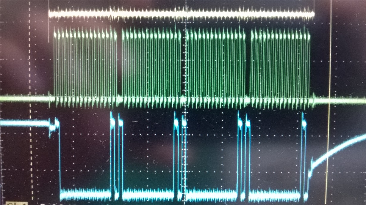

    I configure the McBSP as SPI master to transfer 4 16-bits elements data package using the EDMA. The XFRLEN1=3, XWDLEN1=16, the FSX is generated by FSG. The value of all elements is 0x8002.
    I observed the signals of FSX, CLKX, and the DX  on the scope and found out, that one clock cycle is missed up the second element. That means the first word will be correct transmitted and the following element are shifted 1 bit to left. the shifting is caused by missing the first clock cycle.
    I added a pictures of the scope measurement I did. (FSX:Yellow;  Green: CLKX;   Blue: DX)
    How do you can see the first clk cycle up the 2 element is missed.

  • Hi Arvind,
    It seems that the transmitter CLKSTP mode in SPCR-Register (actually adjusted to NODELAY) causes the missing CLKX cycle by the elements after the first element.
    Adjusting the CLKSTP mode to DELAY solves the missing CLKX cycle. The CLKX runs properly and I am able to transmit a frame consisting of many elements using the EDMA.
    I can't clear this behavior of the CLKX. It runs properly when CLKSTP mode is adjusted to DELAY and doesn't run properly when CLKSTP adjust to NODELAY.
