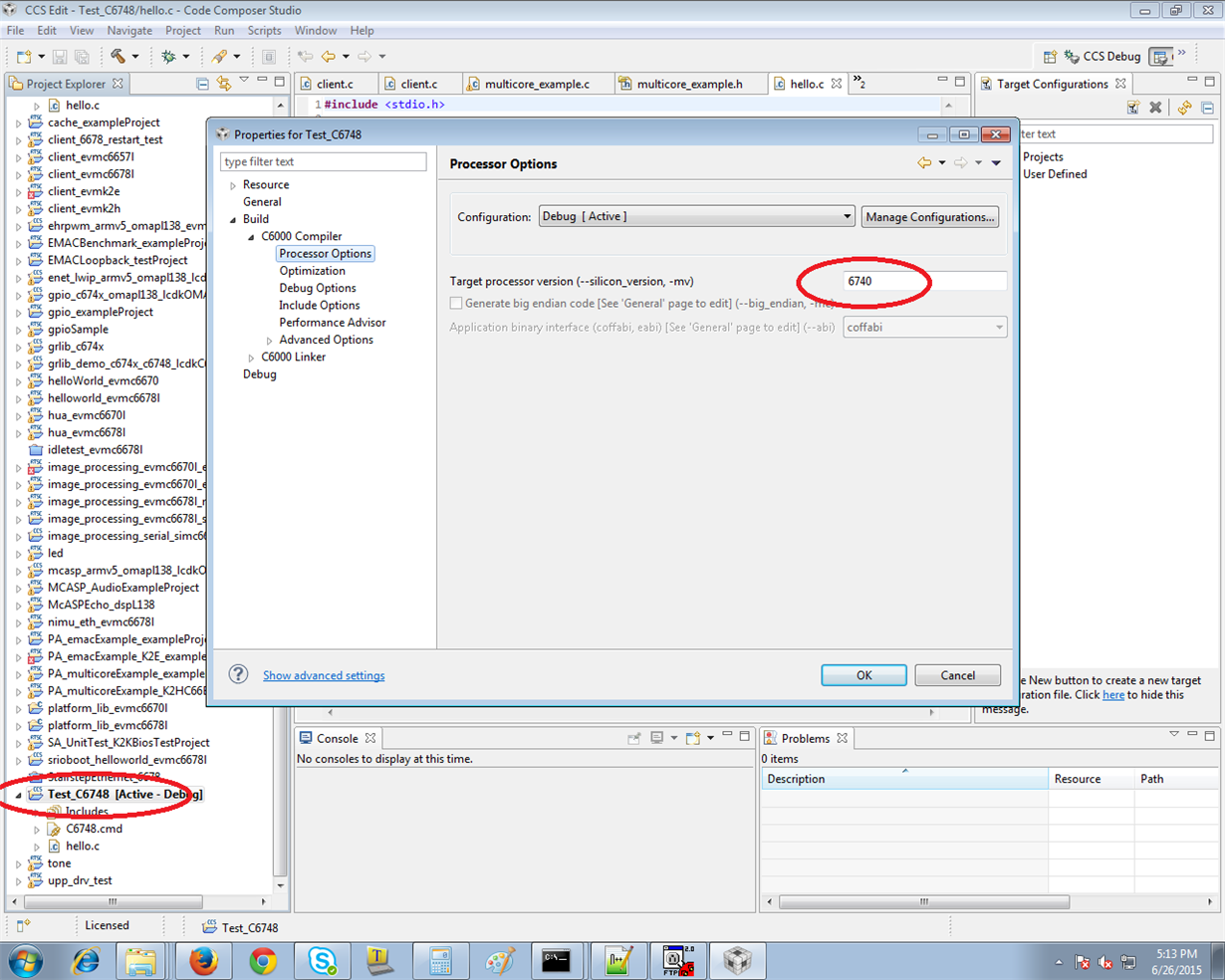

  • Hi, I noted just now that on my project (imported from CCs3.3) the target processor was set to C6713; now I have set it to back to C6740 (-mv6740):
    - now I am out of office until next Monday; do you think this can explain the strange behavior of the OMAP?
  • Update: using the compilation switch -mv6740 today so far no double calculation errors after a couple of hours trial test. The errors were arising in a random manner, so I am not sure that is solved.
    I'll keep you updated.
    After I changed the compilation switch, the prologue/epilogue of the interrupt routine automagically changed including the C674x registers as described in the compiler app note, and furthermore the linker included a different library... so a lot of things changed in the code and now I am trying with a completely different binary code.
    Have you any idea if the incorrect setting of the silicon CPU type can give errors when working with interrupt and floating points?
    Many thanks
    You should use "6740" for C674x processors.
    How did you create this project initially ?
    I've created new project for C6748, "target processor version" mentioned as "c6740" so, when you create CCS project, automatically, that processor information get added.
    I'm not sure what could happen if we mentioned wrongly, hope CCS folks can answer to that question.
    I think, unexpected behavior would occur.
  • Well yeah me too I noticed that a new CCS project uses the correct silicon version, but my project was imported from a legacy CCS3.3 old project, where the 6740 option wasn't present in the project droplist.
