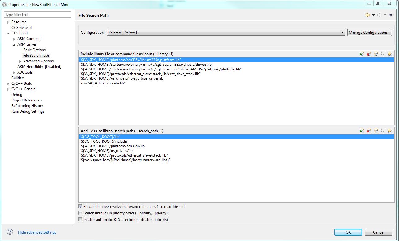

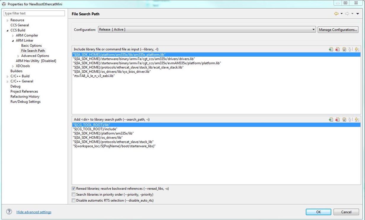

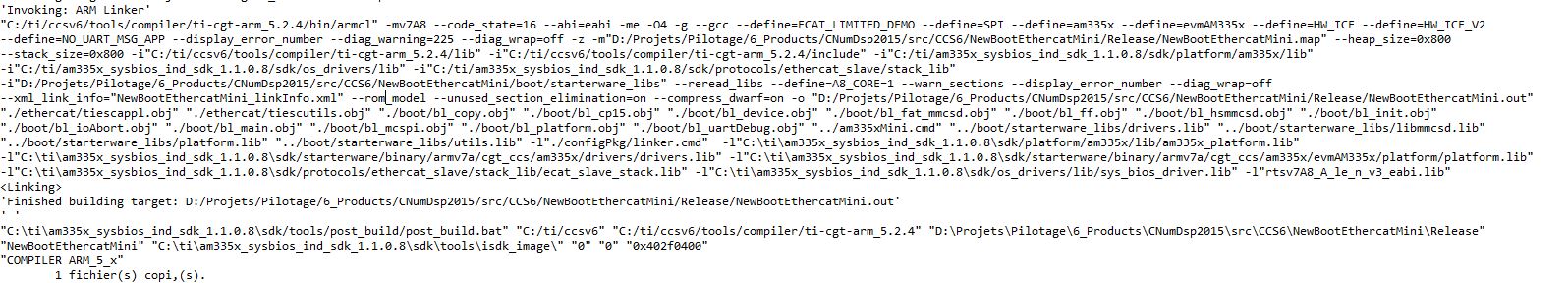

  • Hi Vinesh,
    Sorry for the delayed response.
    I looked at your .map file and it seems like the Task_create function is being pulled in from the ethercat_pea8fnv library rather than the sysbios library (line 471 of the map file). Can you please post a screen shot of the linker libraries in your project? Additionally, can you post the link line that is on the console when you compile the project?
    -- Emmanuel
  • Hello Emmanuel,
    Thanks for your answer !
    I was about to be very anxious about my unsolvable problem...
    I join you the 2 things you asked me...
    Do you have any idea of the problem ?
    Thanks a lot
    Laurence
