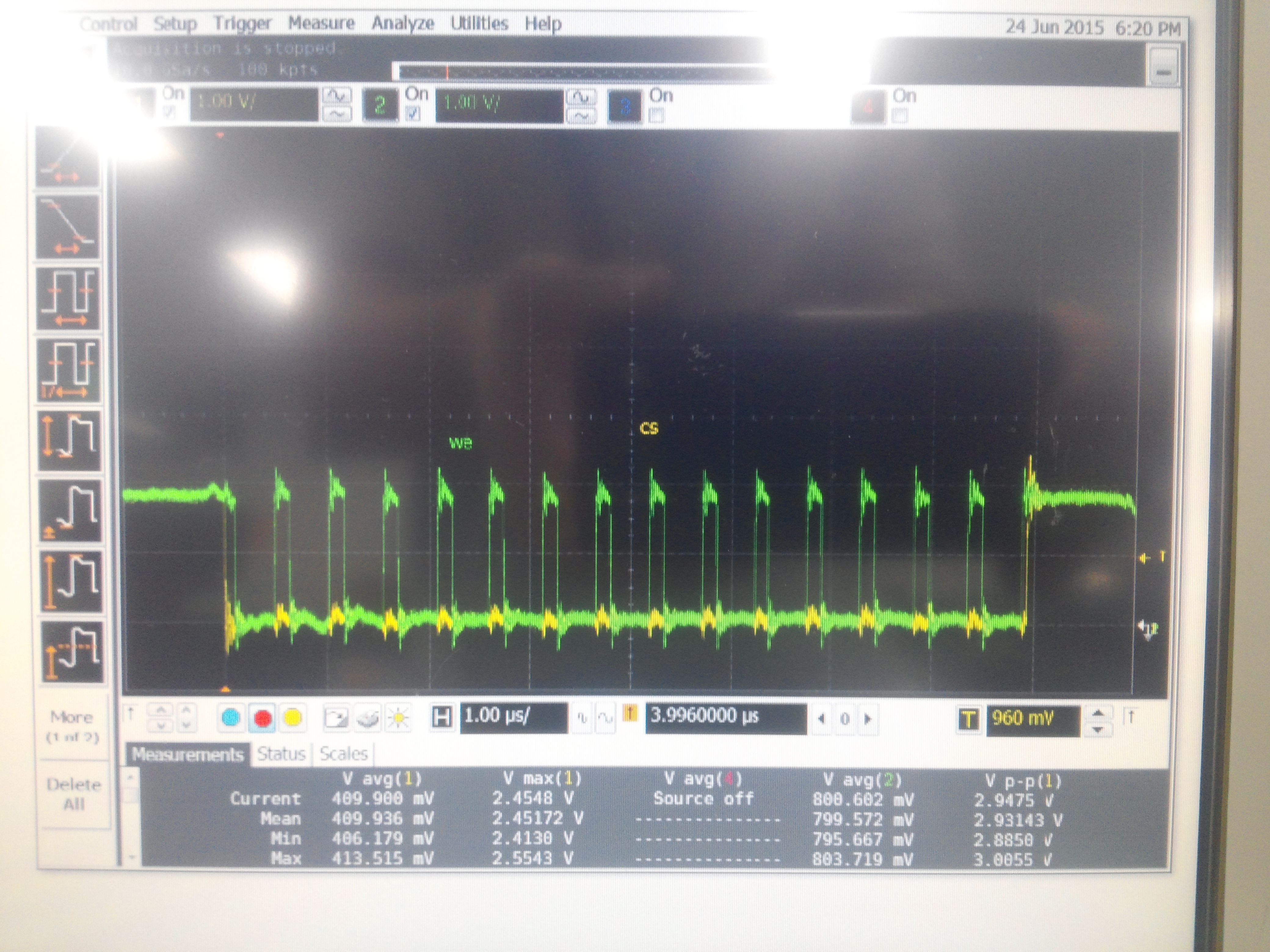

When the order is given to "CE-3" with "S/W" once, "WE" occers "15 times"
What should i do to deal with this?
we : WE(EMIFWE#, ),  cs : CE-3(Chip select 3)

    I'm working with Kim Kyoung. Let me explain more about the situations.
    We made a custom board with C6672 DSP and FPGA is connected by using EMIF16-CE3.
    When we write 16bit data to FPGA, we can find above images. (just like 15 back-to-back asynchronous write cycles)
    But when we use "memory browser" (just modify one register), we can find just one we signal is asserted.
    What is the difference between memory browser and SW?
    How can we solve this problem?
    Thanks.
