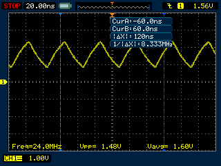

MCLK we are getting an triangle wave form: 2.3v amplitude and looking some offset in voltage level , is that clock is OK..??? (attached the waveform)

  • We fixed this issue. As we are using tlv320aic31xx.c for the tlv320dac3100 audio codec.
    As in AIC3XXX series audio codecs act as a MASTER and Frame will act as slave -- this is mentioned davinci_evm.c ---".dai_fmt " we changed here to I2S and CBS_FMS and NB_NF -- plz go through those values -- we got this from one of the thread from TI posted for dac3100 only.
    so the as the codec slave and frame -- necessary changes are pinmux -- in dts file and the .dai_fmt --- in davinci-evm.c and the mode related option in codec drvier.
    there u will get the Audio clocks.
    Still we are not get any SOUND .. but this is our progress to get the clocks to the codec.
    we are changing the register values -- try for the luck.

    MCLK is comes proper but BCLK & WCLK is not proper .
    Tejas
