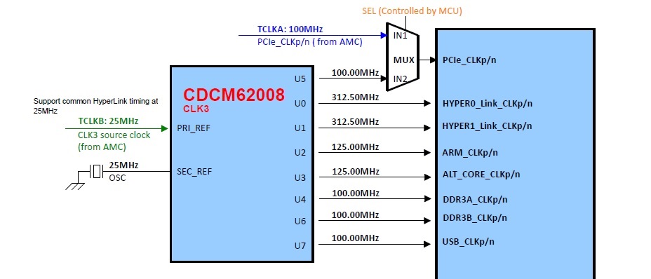

I am using EVMK2H As per this diagram PCie clock can be provided with two sources. One is from CDCM62008 and other is from AMC card. My question is how can I forcefully set it to be AMC clock. i.e writing 1 on sel line of MUX.
