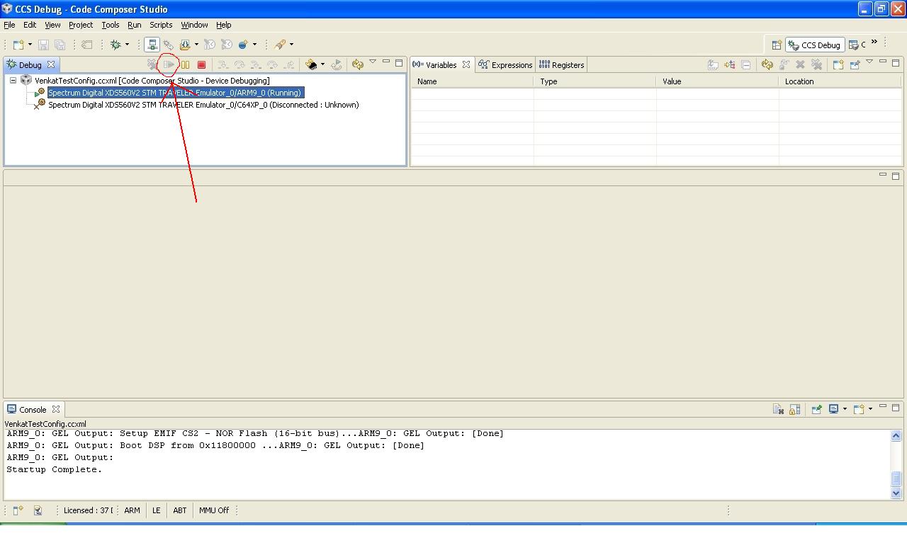

    Did you use JTAG for running this LED code ?
    Could you please attach the complete project (library and include files) that worked with DM6446 EVM through JTAG mode.
  • LED_UART Test_Azhagiri.rarHi,
    Yes, I download the code/ run on DDR using JTAG Emulator (Spectrum Digital XDS560 v2 LC traveller ) to run the LED code. please find my sample code also refer the note included with it, ignore the function names here, I have attached the workspace and project name led.

  • Hi Azhagiri,
    Thanks.
    Could you please try the following method.
    I) Debug the UBL and LED code through CCSAzhagiri
    1) Try to change the "entry point" address (0x81080000) to your actual binary "entry point" as per your *.map file.
    Ex:
    If your LED binary entry point is "0x80007490" then use this entry point address in UBL code to jump and waiting to execute.
    2) Firstly, write some value at DDR address (Ex: 0x88000000) in LED code plus LED blinking stuff.
    3) Build the code and convert into binary (.bin)
    4) Load this binary to DDR memory using "Load memory" option in CCS (Ex: "0x80000000") as per your *.map file.
    5) Now, load UBL ( entry point "0x80007490") code in CCS and run.
    6) Check now, LED is blinking and check DDR address (0x88000000).

  • I have tried to debug, by loading ubl_nor.out file. and also giving following error in ubl.c file and I am not sure about changing these address can you please help me?
    Settings/venkatraman/Desktop/DM644x_FlashAndBootUtils_2_00/DM644x/CCS/UBL/NOR/async_mem.obj" "../DM6446.cmd" "C:/Documents and Settings/venkatraman/Desktop/DM644x_FlashAndBootUtils_2_00/DM644x/CCS/UBL/UBL.cmd"
    "C:/Documents and Settings/venkatraman/Desktop/DM644x_FlashAndBootUtils_2_00/DM644x/CCS/UBL/UBL.cmd", line 20: error #10264:
      ARM_I_IVT memory range overlaps existing memory range ARM_IRAM

  • I have complied the code and tried to run but it is not allowing me to run or debug, the run icon goes hidden as soon as I load the UBL_NOR.out file plese refer the screenshot attached.
    1) I have made "DM644x_FlashAndBootUtils_2_00" folder itself as my Workspace folder
    2) Imported UBL_NOR.pjt to CCS v 5 by "File->Import->legacy ccs 3.3 projects"
    3) added a target configuration file testconfig.ccxml
    4) It has automatically linked all the library files and source files excluding DM644x/CCS/Ubl/include folder  which is missing and could not find but there was no error for that, I assumed it is not needed
    5) compiled the project
    6) started debug option and loaded UBL_NOR.out and run option has gone hide, also could not set any breakpoints and could not debug it
    (usually pointer goes to main()  and allows me to debug or run)
    Whats wrong here? need to take other project ?
