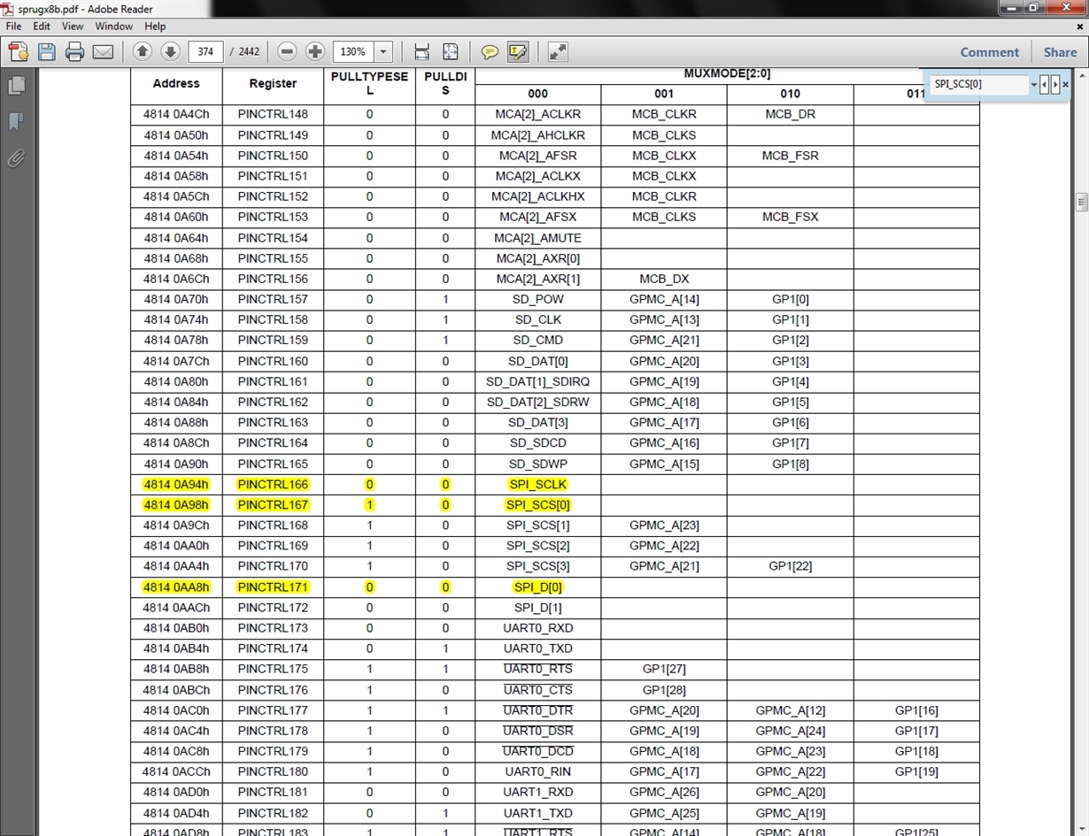

  • Dear Pavel,
    Here, in our case, I have added the below line for pin mux of SPI in my board file:
    static struct omap_board_mux board_mux[] __initdata = {
            TI816X_MUX(SPI_D0, OMAP_MUX_MODE0),
            TI816X_MUX(SPI_SCLK, OMAP_MUX_MODE0),
            TI816X_MUX(SPI_SCS0, OMAP_MUX_MODE0),
    Hopefully, the MUX pins will be configured below the devices getting registered. What is SPI clock mode ?.. I have seen in the reference manual, there is only one MUX mode for the above pins (sprugx8b).
    I have attached the screen shot with this post
    Please help me out on why the clock is not coming out from the master.
    Thanks in advance.
    Salih

  • Salih,
    Make sure you have the value of 0x00000000 in PINCTRL166 register just before starting the data transfer. Make sure you are connecting DM816x R2 physical pin to your sensor and probing this pin. Make sure you are making good HW connectivity of this pin.
    Check also that SPI CS signal is in valid level to select the external device.
    BR
    Pavel
