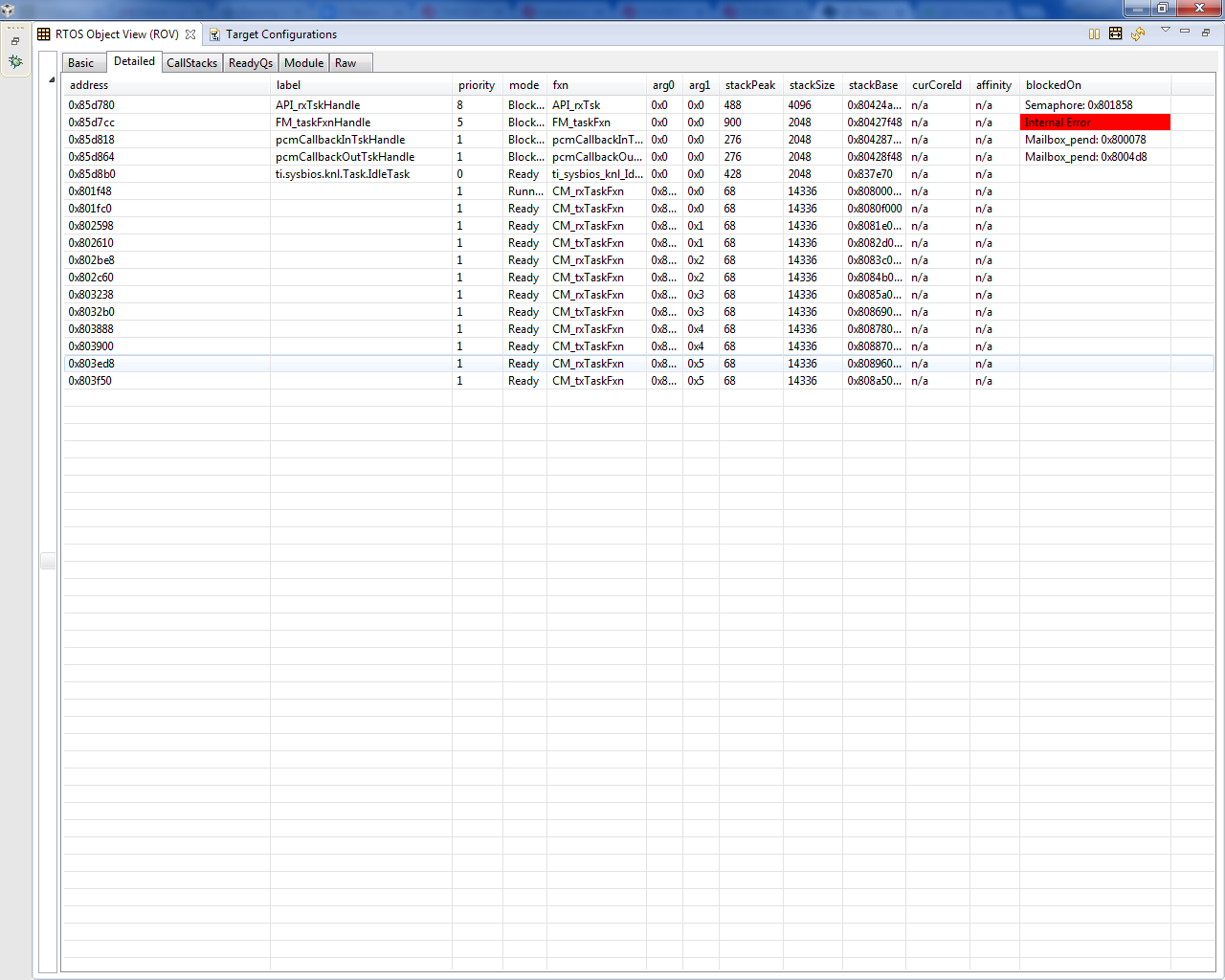

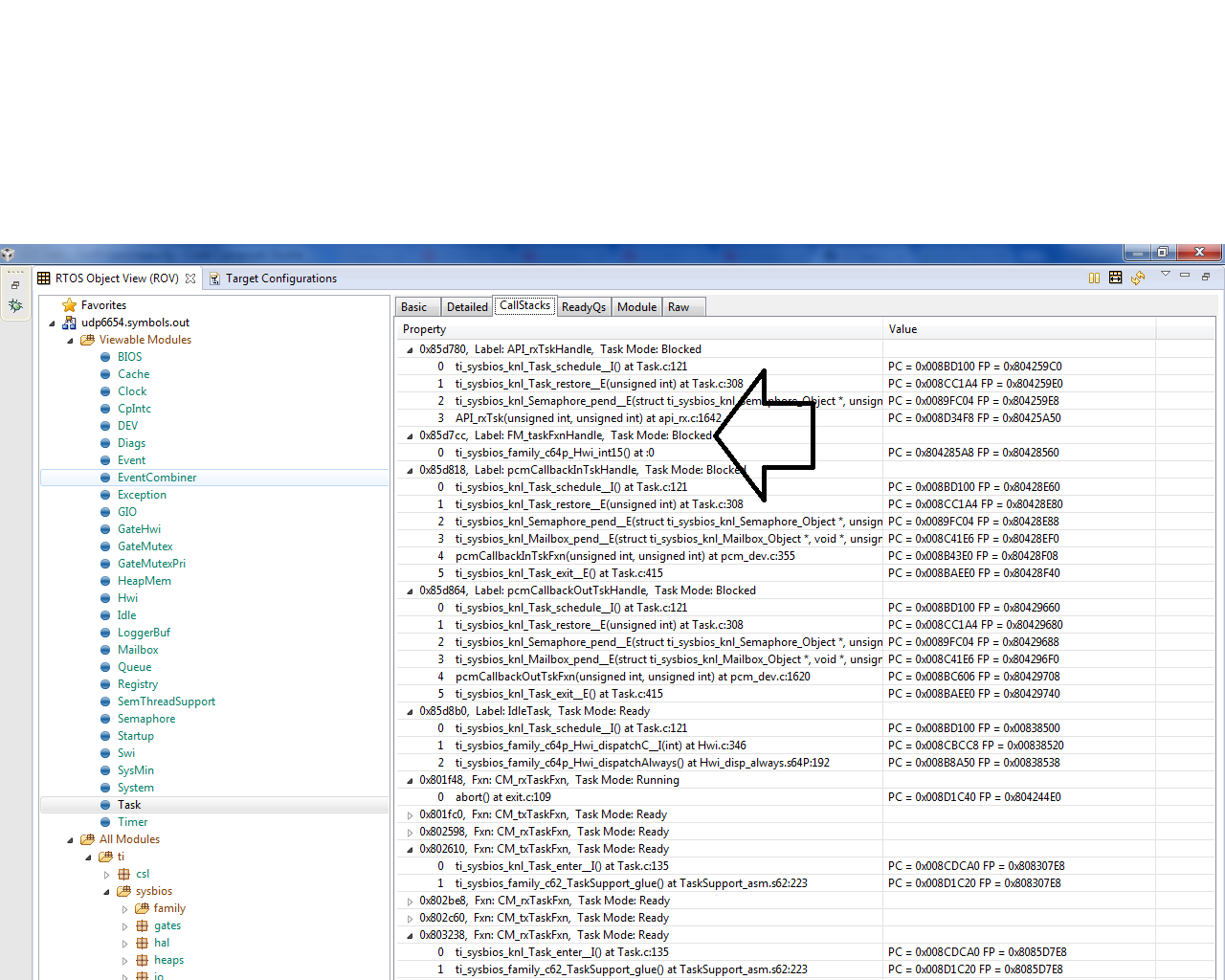

I am working on C6657 processor and SYS/BIOS 6.40.0339.
When the sytem is running, some times i get the following error E_spOutOfBounds: Task 0x85d7cc stack error, SP = 0x80428530. The task is not always the same. I have checked the ROV and the usage of stack is low.
I am using the EDMA interrupts and mcbso interrupts in my program
Coud you please help me?
Please have a look in the image below .
Below you can find the cfg file
