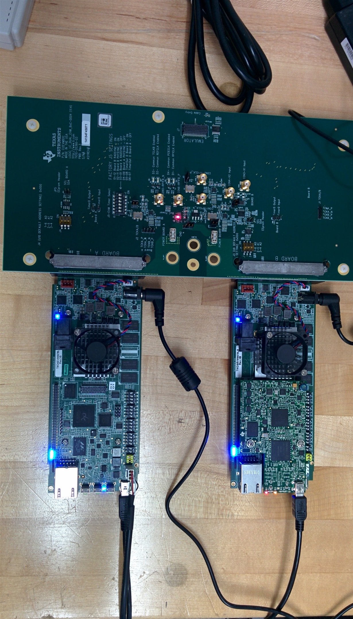

I'm trying to get the IPC SRIO example project working on C6678 EVM.
For hardware set up: I have 2 C6678 evm boards connected through the dual breakout board, both of them in "no-boot" switch mode.
I've tried the SRIO throughput test, which works. So it seems like the hardware settings are good.
But then When I tried the IPC SRIO example, the console log looks like this:

I've tried to use the exact target configuration file and binary files you built for this project from this post:
 But I still get the same error. Any hints where I should go from here?

  • Hi Ganapathi,
    Thanks for your patience!
    To make sure my hardware is working, I ran the through put test several times with different configurations, seems all working. The log is attached.
    (I set the max packet size as 1024 to save time)
    So I guess the hardware is okay, or is there another way to set up the hardware?
    I also ran the IPC SRIO test several times, sometimes I got the InvalidQueueID error. So I'm really confused..
    Shang

    Your SRIO throughput example log also show some error messages.
    Have you connected the two EVMs via BOC like below link on your test setup.
    processors.wiki.ti.com/.../DualEVM_BOC_quick_setup_guide_09SEPT13.pdf
    Please share your test setup image
  • Hi Ganapathi,
    I just took a pic of my evm and breakout boards.
    Your setup is correct. I am also using the same setup to test the SRIO IPC example on my EVM's with multiple times it is working fine.
