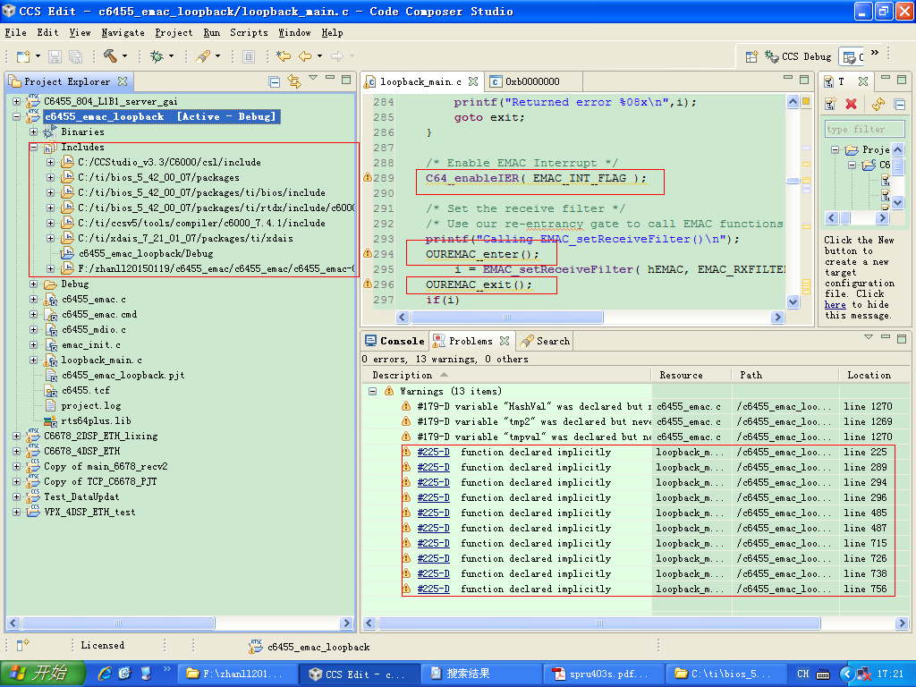

we use Loopback at the PHY device(PHY_LOOPBACK =1, LOCAL_LOOPBACK =0),after "rebuild project",it has some warnings as follows:

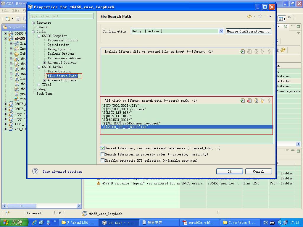

But we have checked "Include options" and "File search path " they are all OK. the "Include options":
the "File search path " :

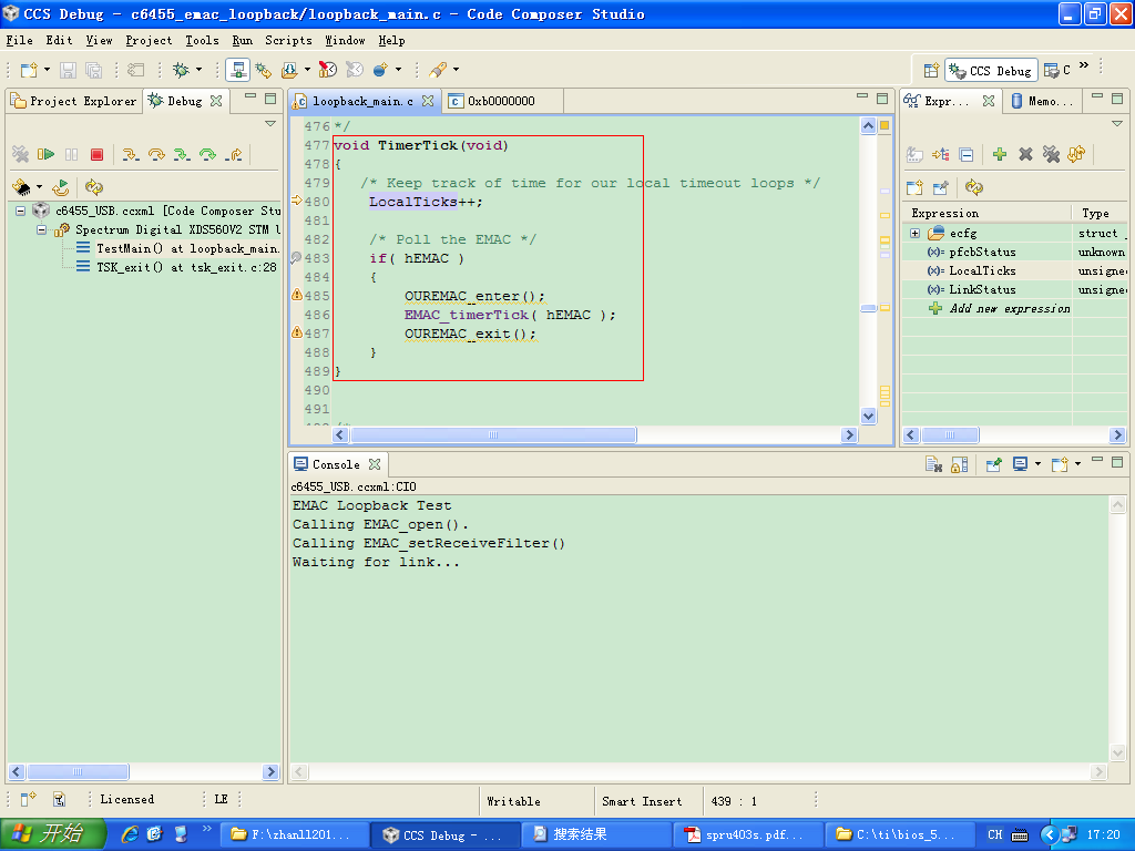

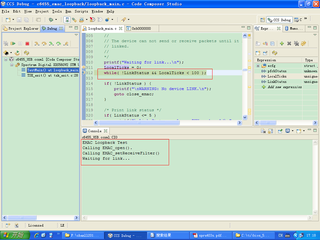

when "run",it will hung in "while( !LinkStatus && LocalTicks < 100)", the value of "LinkStatus" and "LocalTicks"are always "0".
So we set breakpoint in Interrupt function“TimeTick(void)”,we found that the Interrupt was not be triggered at all.
It seems that all the Hw interrupts were not be triggered at all. That is to say the
"C64_enableIER( EMAC_INT_FLAG );"
"SWI_enable();"
"OUREMAC_enter()"
and so on not working??
