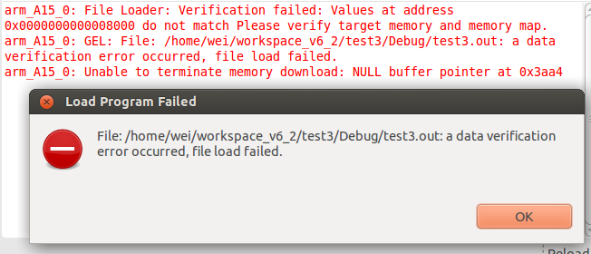

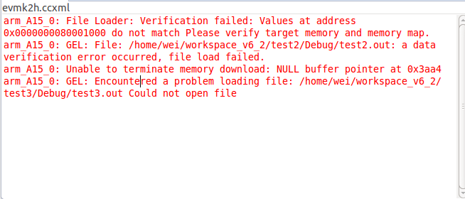

  • Hi, Raj. I already have the image built and was able to boot the image in SPI. I am booting it through sftp and nfs.
    Uboot is loaded and everything is correctly set up.  I am able to communicate to uboot with a serial port terminal.
    Now, when I tried and built a arm project the same way in the link i mentioned. This error message popped up
    I tried to also build the project using Linaro. It also failed, the error message is
    any suggestion?

  • Now, when I tried and built a arm project the same way in the link i mentioned. This error message popped up
    Which link are you referring? We have used linaro to build u-boot & Linux only not the CCS projects.

    I tried both Linaro and TI compiler for building an ARM project in CCS so I could debug it through the emulator using CCS. Again, I am running in SPI mode.

    For CCS projects, we recommend you to use the TI ARM Compiler.
