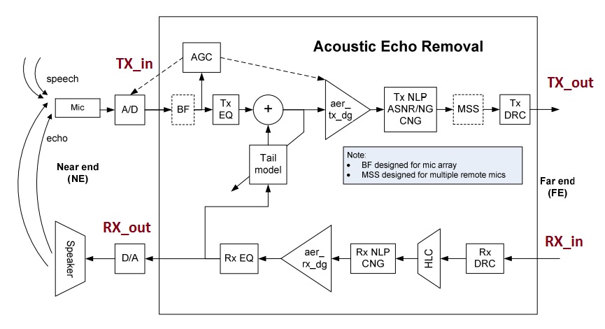

    If the far-end doesn't have any activity, the near end speech should go through without any attenuation, no matter how NLP is configured. It must be something else. Can you provide more information such as:

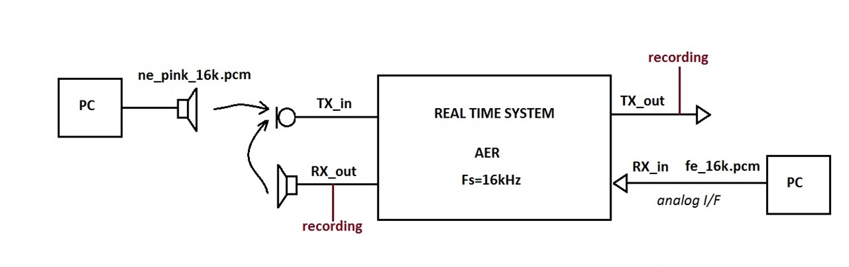

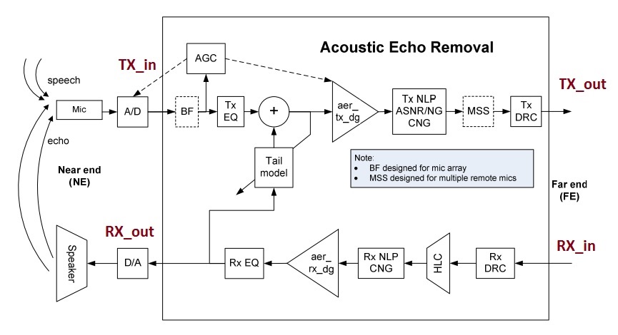

    To make myself clear I would like to use this picture to address signals:
    So there is no attenuation on TXout if RXin is muted. The problem is different. It is just like chopping the beginning of phrase on TX_out even without any signal on RX_in. However, I have some improvements since that time but anyway I would like to get a feedback if AER works well or nor.

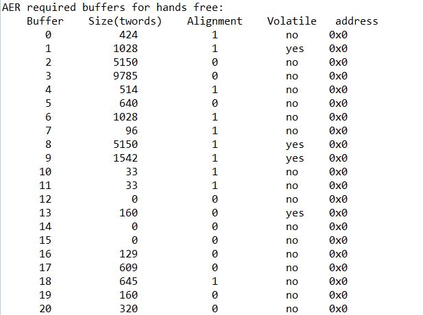

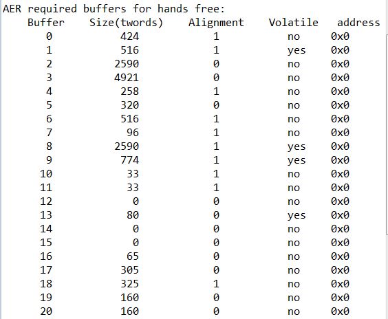

    My initial aim is to get AER worked in HF mode with Fs= 8khz. I have looked through the AER demo and I do not see any difference in required buffers when I change Sampling rate bitfield from 0 to 7 in aersimcfg.txt. It always requires the same memory size:
    So could you please advise how to switch AER on 8kHz properly based on AER demo project?

    The sizes of the required buffers depend on the maximum sampling rate which is configured through API aerCreate(). It is hard coded to 16kHz in the simulation. The sampling rate bitfield is used for run time configuration and does not affect buffer sizes. You can go to aer\test\siusim\siuaer.c for how to configure the maximum sampling rate.

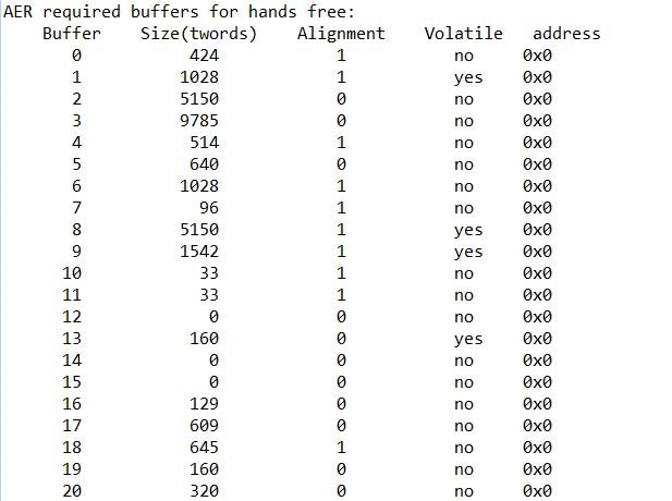

    When I changed aer_create_cfg.max_sampling_rate to aer_SRATE_8K total requested buffers size reduced almost twice from 27.446kB to 14.166kB which was quite expected.

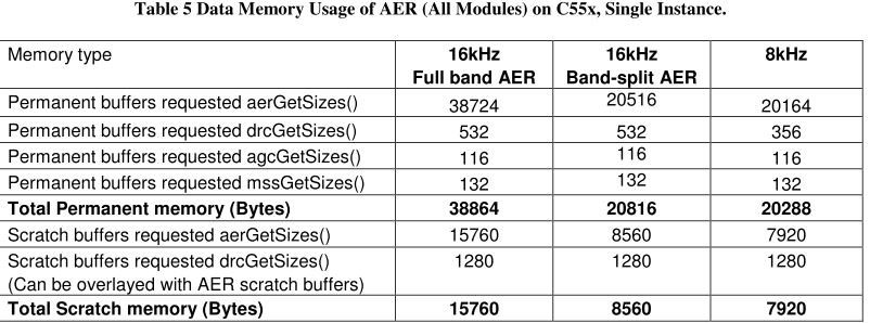

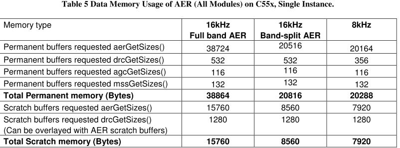

    However, how this corresponds with Table 5 in AER_Integration_Guide? According to this table 16kHz full band should take 54.624kB, 16KHz band-split – 29.076kB and 8kHz -28.084kB. But with aer_SRATE_8K requested buffer size is just 14.166kB.

    The total buffer size you got was in 16-bit word which is the minimum addressable unit on C55x. In the AER integration guide, memory requirement is in byte. The table may be a little out of date, but roughly total size given in the table is about twice as much as your number.
