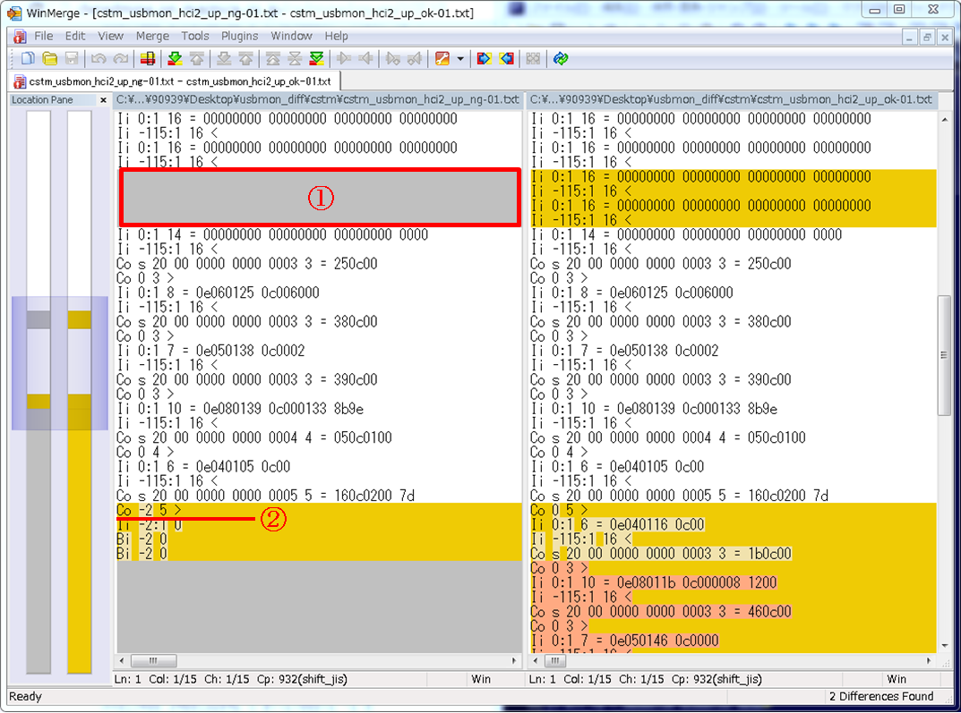

Hello Sitara team,
Our customer is checking the working of multiple USB BT dongles connected to the AM3358 Starter Kit. However, they are seeing the problem  that some dongles cannot boot up correctly. Thus, I would like to know whether anyone has a same experience about AM335x board or not.
Please see the phenomenon below and if you have any comment or advice on this problem, it would be helpful.
[Phenomenon]
1. They connect the self-powered USB Hub (including AC power cable) to the USB port of AM3358SK and connect four USB BT dongles (BT4.0 supported) to each ports of USB Hub.
2. After Linux boots up, if they issue "hciconfig hci* up", some of dongles cannot be up and "timeout" is displayed on the terminal.
-EVM is TMDSSK3358 - AM335x Starter Kit
-Linux kernel is 3.12.10 and user land is their own distribution package.
 (They modified the source code related with Ethernet a little but they do not think this is related with this issue.
-BT USB Dongle is bt-micro4 made by Planex Communications.

- If they connect one BT dongle to USB port of AM3358SK (without USB Hub), it is working correctly. (They succeeded by 10 of 10 times)
- If they connect two BT dongle to USB hub connected to AM3358SK,  these dongles are also working correctly in most cases.
 (They saw "Bluetooth: hci1 command 0x080f tx timeout" by 1 of 10 times but after that, they confirmed that these dongles were up correctly.)

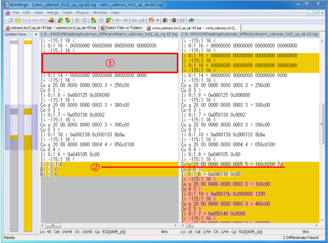

  • Bin-san,
    I got an information about the device descriptors (result of lsusb command).
    Please see the attached file.
    If you have any comment or advice for this problem, please let us know.
    Thank you for your help.
    Nobu Arai

    Do you by any chance have a protocol analyzer to capture a bus trace including the whole enumeration and test failure?
    They do not have a USB bus analyzer but they are checking if it can borrow it.
    In the past, they found the data that they enabled the USB monitor and checked the USB accessing condition by Wireshark.
    This is the data that was taken with their own AM3358 board (not AM3358SK). But according to this data, they confirmed that the interrupt transfer is done when the timeout happens. In the place that the timeout happens, it looks the timeout happens without any packet transfer communication.
    In addition to that, there is no trace of the Isochronous transferring in the place of hciconfig command.
    if you have any comment on this or any advice, it would be helpful for us.

    We do not have a protocol analyzer but we tried to use USB_MON to monitor the USB communication.
    I do not know what is the actual contents of the communication but there are some differences between good case and fail case.
    So, we would like to send the capture log and would like you to check these logs. Then, if you have any advice, it would be helpful for us.
    We got the information of USB communication with USB_MON in hci2 because we saw the problems many times at hci2 this time.
    We found that there are two types of difference in one set of logs.
    For example, if we compare usbmon_hci2_up_GOOD-01.log and usbmon_hci2_up_FAIL-01.log, we found following two differences.
    1. After the command [s 20 00 0000 0000 0003 3 = 140c00] is sent, the number of data of response from BLE dongle is smaller about 32bytes.
    2. After the command [s 20 00 0000 0000 0005 5 = 160c0200 7d] is sent, next line is [0 5 >] in Good case but [-2 5 >] in Fail case, then, there is no communication.
    Please see the attached image below. Left side is Fail and Right is Good.
    We prepared one more set of logs.
    If we compare usbmon_hci2_up_GOOD-02.log and usbmon_hci2_up_FAIL-02.log, we found following differences.
    2. The output to the command [s 20 00 0000 0000 0005 5 = 160c0200 7d] is not sent.
    From the results, it looks the output from AM3358 is not good or output incorrectly. For this reason, USB communication is stopping after that. Would you please check these logs  and give any advices?
    Thank you very much for your help.
    Nobuyoshi Arai

    cc071d00 3479726212 S Ii:2:005:1 -115:1 16 <
    cc071680 3479726288 S Co:2:005:0 s 20 00 0000 0000 0003 3 = 091000
    cc071680 3479726784 C Co:2:005:0 0 3 >
    cc071d00 3479727105 C Ii:2:005:1 0:1 12 = 0e0a0109 10001d49 05dc1b00
    cc071d00 3479727142 S Ii:2:005:1 -115:1 16 <
    cc071680 3479727690 S Co:2:005:0 s 20 00 0000 0000 0003 3 = 051000
    cc071680 3479728186 C Co:2:005:0 0 3 >
    cc071d00 3479729142 C Ii:2:005:1 0:1 13 = 0e0b0105 10003601 400a0008 00
    cc071d00 3479729185 S Ii:2:005:1 -115:1 16 <
    cc071680 3479729297 S Co:2:005:0 s 20 00 0000 0000 0003 3 = 230c00
    cc071680 3479729733 C Co:2:005:0 0 3 >
    cc071d00 3479730101 C Ii:2:005:1 0:1 9 = 0e070123 0c000000 00
    cc071d00 3479730135 S Ii:2:005:1 -115:1 16 <
    cc071680 3479730219 S Co:2:005:0 s 20 00 0000 0000 0003 3 = 140c00
    cc071680 3479732391 C Co:2:005:0 0 3 >
    cc071d00 3479734135 C Ii:2:005:1 0:1 16 = 0efc0114 0c004353 52383531 30204131
    cc071d00 3479734161 S Ii:2:005:1 -115:1 16 <
    cc071d00 3479735140 C Ii:2:005:1 0:1 16 = 30000000 00000000 00000000 00000000
    cc071d00 3479735161 S Ii:2:005:1 -115:1 16 <
    cc071d00 3479736101 C Ii:2:005:1 0:1 16 = 00000000 00000000 00000000 00000000
    cc071d00 3479736122 S Ii:2:005:1 -115:1 16 <
    cc071d00 3479737135 C Ii:2:005:1 0:1 16 = 00000000 00000000 00000000 00000000
    cc071d00 3479737156 S Ii:2:005:1 -115:1 16 <
    cc071d00 3479738141 C Ii:2:005:1 0:1 16 = 00000000 00000000 00000000 00000000
    cc071d00 3479738162 S Ii:2:005:1 -115:1 16 <
    cc071d00 3479739134 C Ii:2:005:1 0:1 16 = 00000000 00000000 00000000 00000000
    cc071d00 3479739153 S Ii:2:005:1 -115:1 16 <
    cc071d00 3479740131 C Ii:2:005:1 0:1 16 = 00000000 00000000 00000000 00000000
    cc071d00 3479740152 S Ii:2:005:1 -115:1 16 <
    cc071d00 3479743134 C Ii:2:005:1 0:1 16 = 00000000 00000000 00000000 00000000
    cc071d00 3479743154 S Ii:2:005:1 -115:1 16 <
    cc071d00 3479744132 C Ii:2:005:1 0:1 16 = 00000000 00000000 00000000 00000000
    cc071d00 3479744154 S Ii:2:005:1 -115:1 16 <
    cc071d00 3479745134 C Ii:2:005:1 0:1 16 = 00000000 00000000 00000000 00000000
    cc071d00 3479745155 S Ii:2:005:1 -115:1 16 <
    cc071d00 3479746132 C Ii:2:005:1 0:1 16 = 00000000 00000000 00000000 00000000
    cc071d00 3479746153 S Ii:2:005:1 -115:1 16 <
    cc071d00 3479747135 C Ii:2:005:1 0:1 16 = 00000000 00000000 00000000 00000000
    cc071d00 3479747155 S Ii:2:005:1 -115:1 16 <
    cc071d00 3479748096 C Ii:2:005:1 0:1 16 = 00000000 00000000 00000000 00000000
    cc071d00 3479748119 S Ii:2:005:1 -115:1 16 <
    cc071d00 3479749102 C Ii:2:005:1 0:1 14 = 00000000 00000000 00000000 0000
    cc071d00 3479749121 S Ii:2:005:1 -115:1 16 <
    cc071680 3481732049 S Co:2:005:0 s 20 00 0000 0000 0003 3 = 250c00
    cc071680 3481732543 C Co:2:005:0 0 3 >
    cc071d00 3481733125 C Ii:2:005:1 0:1 8 = 0e060125 0c006000
    cc071d00 3481733161 S Ii:2:005:1 -115:1 16 <
    cc071680 3483732030 S Co:2:005:0 s 20 00 0000 0000 0003 3 = 380c00
    cc071680 3483732604 C Co:2:005:0 0 3 >
    cc071d00 3483733120 C Ii:2:005:1 0:1 7 = 0e050138 0c0002
    cc071d00 3483733153 S Ii:2:005:1 -115:1 16 <
    cc071680 3485732073 S Co:2:005:0 s 20 00 0000 0000 0003 3 = 390c00
    cc071680 3485732645 C Co:2:005:0 0 3 >
    cc071d00 3485733128 C Ii:2:005:1 0:1 10 = 0e080139 0c000133 8b9e
    cc071d00 3485733163 S Ii:2:005:1 -115:1 16 <
    cc071680 3487732044 S Co:2:005:0 s 20 00 0000 0000 0004 4 = 050c0100
    cc071680 3487732623 C Co:2:005:0 0 4 >
    cc071d00 3487733145 C Ii:2:005:1 0:1 6 = 0e040105 0c00
    cc071d00 3487733166 S Ii:2:005:1 -115:1 16 <
    cc071680 3489732101 S Co:2:005:0 s 20 00 0000 0000 0005 5 = 160c0200 7d
    cc071680 3489732509 C Co:2:005:0 -2 5 >
    cc071d00 3489732600 C Ii:2:005:1 -2:1 0
    cc071b00 3489732642 C Bi:2:005:2 -2 0
    	cc071c00 3489732846 C Bi:2:005:2 -2 0
    cb959700 4050799005 S Ii:2:005:1 -115:1 16 <
    cb959800 4050800090 S Bi:2:005:2 -115 1028 <
    cb959700 4050800522 C Ii:2:005:1 0:1 6 = 0e040116 0c00
    cb959700 4050800575 S Ii:2:005:1 -115:1 16 <
    cb959900 4050802040 S Bi:2:005:2 -115 1028 <
    cb959980 4050802806 S Co:2:005:0 s 20 00 0000 0000 0003 3 = 030c00
    cb959980 4050803378 C Co:2:005:0 0 3 >
    cb959700 4050938542 C Ii:2:005:1 0:1 6 = 0e040103 0c00
    cb959700 4050938590 S Ii:2:005:1 -115:1 16 <
    cb959980 4050938718 S Co:2:005:0 s 20 00 0000 0000 0003 3 = 031000
    cb959980 4050939146 C Co:2:005:0 0 3 >
    cb959700 4050939490 C Ii:2:005:1 0:1 14 = 0e0c0103 1000ffff 8ffedbff 5b87
    cb959700 4050939525 S Ii:2:005:1 -115:1 16 <
    cb959980 4050939603 S Co:2:005:0 s 20 00 0000 0000 0003 3 = 011000
    cb959980 4050940054 C Co:2:005:0 0 3 >
    cb959700 4050940487 C Ii:2:005:1 0:1 14 = 0e0c0101 100006bb 22060a00 bb22
    cb959700 4050940523 S Ii:2:005:1 -115:1 16 <
    cb959980 4050940598 S Co:2:005:0 s 20 00 0000 0000 0003 3 = 091000
    cb959980 4050941018 C Co:2:005:0 0 3 >
    cb959700 4050941487 C Ii:2:005:1 0:1 12 = 0e0a0109 10001d49 05dc1b00
    cb959700 4050941522 S Ii:2:005:1 -115:1 16 <
    cb959980 4050942187 S Co:2:005:0 s 20 00 0000 0000 0003 3 = 051000
    cb959980 4050942674 C Co:2:005:0 0 3 >
    cb959700 4050943524 C Ii:2:005:1 0:1 13 = 0e0b0105 10003601 400a0008 00
    cb959700 4050943564 S Ii:2:005:1 -115:1 16 <
    cb959980 4050943669 S Co:2:005:0 s 20 00 0000 0000 0003 3 = 230c00
    cb959980 4050944124 C Co:2:005:0 0 3 >
    cb959700 4050944490 C Ii:2:005:1 0:1 9 = 0e070123 0c000000 00
    cb959700 4050944529 S Ii:2:005:1 -115:1 16 <
    cb959980 4050944610 S Co:2:005:0 s 20 00 0000 0000 0003 3 = 140c00
    cb959980 4050946780 C Co:2:005:0 0 3 >
    cb959700 4050948527 C Ii:2:005:1 0:1 16 = 0efc0114 0c004353 52383531 30204131
    cb959700 4050948556 S Ii:2:005:1 -115:1 16 <
    cb959700 4050949509 C Ii:2:005:1 0:1 16 = 30000000 00000000 00000000 00000000
    cb959700 4050949531 S Ii:2:005:1 -115:1 16 <
    cb959700 4050950528 C Ii:2:005:1 0:1 16 = 00000000 00000000 00000000 00000000
    cb959700 4050950551 S Ii:2:005:1 -115:1 16 <
    cb959700 4050951531 C Ii:2:005:1 0:1 16 = 00000000 00000000 00000000 00000000
    cb959700 4050951554 S Ii:2:005:1 -115:1 16 <
    cb959700 4050952525 C Ii:2:005:1 0:1 16 = 00000000 00000000 00000000 00000000
    cb959700 4050952548 S Ii:2:005:1 -115:1 16 <
    cb959700 4050953521 C Ii:2:005:1 0:1 16 = 00000000 00000000 00000000 00000000
    cb959700 4050953544 S Ii:2:005:1 -115:1 16 <
    cb959700 4050954527 C Ii:2:005:1 0:1 16 = 00000000 00000000 00000000 00000000
    cb959700 4050954549 S Ii:2:005:1 -115:1 16 <
    cb959700 4050955521 C Ii:2:005:1 0:1 16 = 00000000 00000000 00000000 00000000
    cb959700 4050955543 S Ii:2:005:1 -115:1 16 <
    cb959700 4050956524 C Ii:2:005:1 0:1 16 = 00000000 00000000 00000000 00000000
    cb959700 4050956544 S Ii:2:005:1 -115:1 16 <
    cb959700 4050957521 C Ii:2:005:1 0:1 16 = 00000000 00000000 00000000 00000000
    cb959700 4050957541 S Ii:2:005:1 -115:1 16 <
    cb959700 4050958523 C Ii:2:005:1 0:1 16 = 00000000 00000000 00000000 00000000
    cb959700 4050958543 S Ii:2:005:1 -115:1 16 <
    cb959700 4050959487 C Ii:2:005:1 0:1 16 = 00000000 00000000 00000000 00000000
    cb959700 4050959508 S Ii:2:005:1 -115:1 16 <
    cb959700 4050960491 C Ii:2:005:1 0:1 16 = 00000000 00000000 00000000 00000000
    cb959700 4050960511 S Ii:2:005:1 -115:1 16 <
    cb959700 4050961488 C Ii:2:005:1 0:1 16 = 00000000 00000000 00000000 00000000
    cb959700 4050961508 S Ii:2:005:1 -115:1 16 <
    cb959700 4050962491 C Ii:2:005:1 0:1 16 = 00000000 00000000 00000000 00000000
    cb959700 4050962510 S Ii:2:005:1 -115:1 16 <
    cb959700 4050963540 C Ii:2:005:1 0:1 14 = 00000000 00000000 00000000 0000
    cb959700 4050963573 S Ii:2:005:1 -115:1 16 <
    cb959980 4050963848 S Co:2:005:0 s 20 00 0000 0000 0003 3 = 250c00
    cb959980 4050964271 C Co:2:005:0 0 3 >
    cb959700 4050965526 C Ii:2:005:1 0:1 8 = 0e060125 0c006000
    cb959700 4050965566 S Ii:2:005:1 -115:1 16 <
    cb959980 4050965819 S Co:2:005:0 s 20 00 0000 0000 0003 3 = 380c00
    cb959980 4050966248 C Co:2:005:0 0 3 >
    cb959700 4050967525 C Ii:2:005:1 0:1 7 = 0e050138 0c0002
    cb959700 4050967561 S Ii:2:005:1 -115:1 16 <
    cb959980 4050967805 S Co:2:005:0 s 20 00 0000 0000 0003 3 = 390c00
    cb959980 4050968248 C Co:2:005:0 0 3 >
    cb959700 4050969523 C Ii:2:005:1 0:1 10 = 0e080139 0c000133 8b9e
    cb959700 4050969561 S Ii:2:005:1 -115:1 16 <
    cb959980 4050969817 S Co:2:005:0 s 20 00 0000 0000 0004 4 = 050c0100
    cb959980 4050970248 C Co:2:005:0 0 4 >
    cb959700 4050971522 C Ii:2:005:1 0:1 6 = 0e040105 0c00
    cb959700 4050971557 S Ii:2:005:1 -115:1 16 <
    cb959980 4050971804 S Co:2:005:0 s 20 00 0000 0000 0005 5 = 160c0200 7d
    cb959980 4050972248 C Co:2:005:0 0 5 >
    cb959700 4050973532 C Ii:2:005:1 0:1 6 = 0e040116 0c00
    cb959700 4050973568 S Ii:2:005:1 -115:1 16 <
    cb959980 4050973820 S Co:2:005:0 s 20 00 0000 0000 0003 3 = 1b0c00
    cb959980 4050974247 C Co:2:005:0 0 3 >
    cb959700 4050975525 C Ii:2:005:1 0:1 10 = 0e08011b 0c000008 1200
    cb959700 4050975560 S Ii:2:005:1 -115:1 16 <
    cb959980 4050975807 S Co:2:005:0 s 20 00 0000 0000 0003 3 = 460c00
    cb959980 4050976247 C Co:2:005:0 0 3 >
    cb959700 4050977524 C Ii:2:005:1 0:1 7 = 0e050146 0c0000
    cb959700 4050977560 S Ii:2:005:1 -115:1 16 <
    cb959980 4050977808 S Co:2:005:0 s 20 00 0000 0000 0003 3 = 022000
    cb959980 4050978247 C Co:2:005:0 0 3 >
    cb959700 4050979524 C Ii:2:005:1 0:1 9 = 0e070102 20000000 00
    cb959700 4050979559 S Ii:2:005:1 -115:1 16 <
    cb959980 4050979803 S Co:2:005:0 s 20 00 0000 0000 0003 3 = 032000
    cb959980 4050980247 C Co:2:005:0 0 3 >
    cb959700 4050981522 C Ii:2:005:1 0:1 14 = 0e0c0103 20000100 00000000 0000
    cb959700 4050981558 S Ii:2:005:1 -115:1 16 <
    cb959980 4050981818 S Co:2:005:0 s 20 00 0000 0000 0003 3 = 072000
    cb959980 4050982248 C Co:2:005:0 0 3 >
    cb959700 4050983534 C Ii:2:005:1 0:1 7 = 0e050107 200008
    cb959700 4050983569 S Ii:2:005:1 -115:1 16 <
    cb959980 4050983815 S Co:2:005:0 s 20 00 0000 0000 0003 3 = 0f2000
    cb959980 4050984247 C Co:2:005:0 0 3 >
    cb959700 4050985526 C Ii:2:005:1 0:1 7 = 0e05010f 200019
    cb959700 4050985562 S Ii:2:005:1 -115:1 16 <
    cb959980 4050985807 S Co:2:005:0 s 20 00 0000 0000 0003 3 = 1c2000
    cb959980 4050986247 C Co:2:005:0 0 3 >
    cb959700 4050987525 C Ii:2:005:1 0:1 14 = 0e0c011c 2000ffff ff1f0000 0000
    cb959700 4050987561 S Ii:2:005:1 -115:1 16 <
    cb959980 4050987826 S Co:2:005:0 s 20 00 0000 0000 000b 11 = 010c08ff fffbff07 f8bf3d
    cb959980 4050988262 C Co:2:005:0 0 11 >
    cb959700 4050989525 C Ii:2:005:1 0:1 6 = 0e040101 0c00
    cb959700 4050989561 S Ii:2:005:1 -115:1 16 <
    cb959980 4050989804 S Co:2:005:0 s 20 00 0000 0000 000b 11 = 0120081f 00000000 000000
    cb959980 4050990247 C Co:2:005:0 0 11 >
    cb959700 4050991524 C Ii:2:005:1 0:1 6 = 0e040101 2000
    cb959700 4050991559 S Ii:2:005:1 -115:1 16 <
    cb959980 4050991794 S Co:2:005:0 s 20 00 0000 0000 0003 3 = 021000
    cb959980 4050992273 C Co:2:005:0 0 3 >
    cb959700 4050993532 C Ii:2:005:1 0:1 16 = 0e440102 1000ffff ff03feff ffffffff
    cb959700 4050993559 S Ii:2:005:1 -115:1 16 <
    cb959700 4050994526 C Ii:2:005:1 0:1 16 = fffff30f e8fe3ff7 83ff1c00 000061f7
    cb959700 4050994549 S Ii:2:005:1 -115:1 16 <
    cb959700 4050995523 C Ii:2:005:1 0:1 16 = ffff7f00 00000000 00000000 00000000
    cb959700 4050995545 S Ii:2:005:1 -115:1 16 <
    cb959700 4050996527 C Ii:2:005:1 0:1 16 = 00000000 00000000 00000000 00000000
    cb959700 4050996548 S Ii:2:005:1 -115:1 16 <
    cb959700 4050997489 C Ii:2:005:1 0:1 6 = 00000000 0000
    cb959700 4050997520 S Ii:2:005:1 -115:1 16 <
    cb959980 4050997766 S Co:2:005:0 s 20 00 0000 0000 00f4 244 = 520cf100 00000000 00000000 00000000 00000000 00000000 00000000 00000000
    cb959980 4050999890 C Co:2:005:0 0 244 >
    cb959700 4051000601 C Ii:2:005:1 0:1 6 = 0e040152 0c00
    cb959700 4051000637 S Ii:2:005:1 -115:1 16 <
    cb959980 4051000868 S Co:2:005:0 s 20 00 0000 0000 0004 4 = 450c0102
    cb959980 4051001295 C Co:2:005:0 0 4 >
    cb959700 4051002524 C Ii:2:005:1 0:1 6 = 0e040145 0c00
    cb959700 4051002560 S Ii:2:005:1 -115:1 16 <
    cb959980 4051002809 S Co:2:005:0 s 20 00 0000 0000 0003 3 = 580c00
    cb959980 4051003243 C Co:2:005:0 0 3 >
    cb959700 4051004488 C Ii:2:005:1 0:1 7 = 0e050158 0c0004
    cb959700 4051004525 S Ii:2:005:1 -115:1 16 <
    cb959980 4051004755 S Co:2:005:0 s 20 00 0000 0000 0004 4 = 04100101
    cb959980 4051005196 C Co:2:005:0 0 4 >
    cb959700 4051006488 C Ii:2:005:1 0:1 16 = 0e0e0104 10000100 00000000 00000000
    cb959700 4051006525 S Ii:2:005:1 -115:1 16 <
    cb959980 4051006840 S Co:2:005:0 s 20 00 0000 0000 000a 10 = 120c0700 00000000 0001
    cb959980 4051007402 C Co:2:005:0 0 10 >
    cb959700 4051007487 C Ii:2:005:1 0:1 0
    cb959700 4051007497 S Ii:2:005:1 -115:1 16 <
    cb959700 4051008488 C Ii:2:005:1 0:1 8 = 0e060112 0c000000
    cb959700 4051008523 S Ii:2:005:1 -115:1 16 <
    cb959980 4051008752 S Co:2:005:0 s 20 00 0000 0000 0005 5 = 0f08020f 00
    cb959980 4051009181 C Co:2:005:0 0 5 >
    cb959700 4051009495 C Ii:2:005:1 0:1 6 = 0e04010f 0800
    cb959700 4051009529 S Ii:2:005:1 -115:1 16 <

  • Nobuyoshi-san, I am currently busy on another task, but will be checking the log in early next week and get you back.
  • Hello Bin-san,
    I sent the log of USB_MON last week. If you have any comment on this log, it would be helpful. I understand that you are busy for another issue.
    By the way, we have got another information about this problem. Please let me add some new information below and if you have any comment on this, we also would like you to have your opinion.
    First, we tried same test with AM437x Starter Kit and we do not see any problem with this environment.
    We are using the same processor SDK, 01.00.00.03 but it seems the different host driver is used, xhci-hcd(AM437x) and musb_hdrc(AM335x).
    Thus, this problem may be related with the device driver(musb_hdrc).
    Secondly, we tried to trace the working with dev_dbg.
    According to the log or dev_dbg, it looks some processing error does not occur but some expected interrupt is not be generated, then it becomes timeout.
    If it is good case, we can see that the following interrupt is happening.
    musb-hdrc musb-hdrc.1.auto: ** IRQ host usb0000 tx0000 rx0040
    But if it is fail caes, we cannot see this interrupt at all.
    Please see the attached log of Good case and Fail case.

  • Nobuyoshi-san,
    I have not got a chance to interpret the raw bytes in each packet yet, but I saw in the failure log the packet returned from the hub/device is shorter than that in the good log. We need bus trace to check if the the hub/device indeed returned short packet, or the packet gets corrupted in musb. I have ordered 4 of the Planex BT dongles to investigate the issue, and am expecting to receive them in the last week of October to the 2nd week of November. Yeah, it is slow shipping, it seems the package is shipped from Japan...
    This shows the issue is related to AM335x/MUSB.
    Again, a bus trace would tell if the hub/device did not send the require packet, or musb supposed to receive it and generate the interrupt.
    Another two thoughts:
    - Do you use another usb port of am335x for something else? If not, can you please try to put two BT dongles on each usb port with a hub to see if the issue still happen? If not, maybe you can use both ports for the four dongles to workaround the issue.
    - Have you contacted Planex for any comments?
  • Bin-san,
    Thank you for the answer.
    I understand that the bus trace is needed to check what is happening.
    However, we do not have a USB analyzer. So, if we send you the USB BT dongle to you, is it possible to check the bus trace in your side?
    If possible, would you please give any advice how we should do?
    Regarding your questions, please let me add our comments below.

  • Nobuyoshi-san,
    Finally I am able to replicate the issue with a Genesys USB hub. The USB bus trace shows the hub stops talking to the host at the end.
    I understand this issue is related to MUSB controller, but it could take a while to find the root cause, if possible. I am wondering if you have control of the hub and BT devices on your final product? For example, will the hub chip be embedded on the board of your product and the BT dongles will be provided in the product as while? If so, can you pick the hub chip which works with the dongles to workaround the issue?
