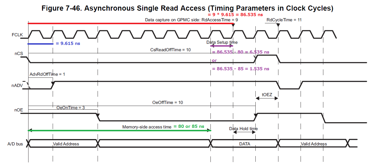

I'd like to know AccessTime of GPMC for asynchronous NOR. The tCE of NOR is 85ns, and FCLK is 104MHz (= 9.615ns). ACCESSTIME is calculated by the following formula. ACCESSTIME = round max (tCE) = 85ns / 9.615ns = 8.84 -> 9 (= 86.538ns). But in this case, I think there is no setup time (86.538ns - 85ns = 1.538ns). Should ACCESSTIME be set 10 as plus 1?
