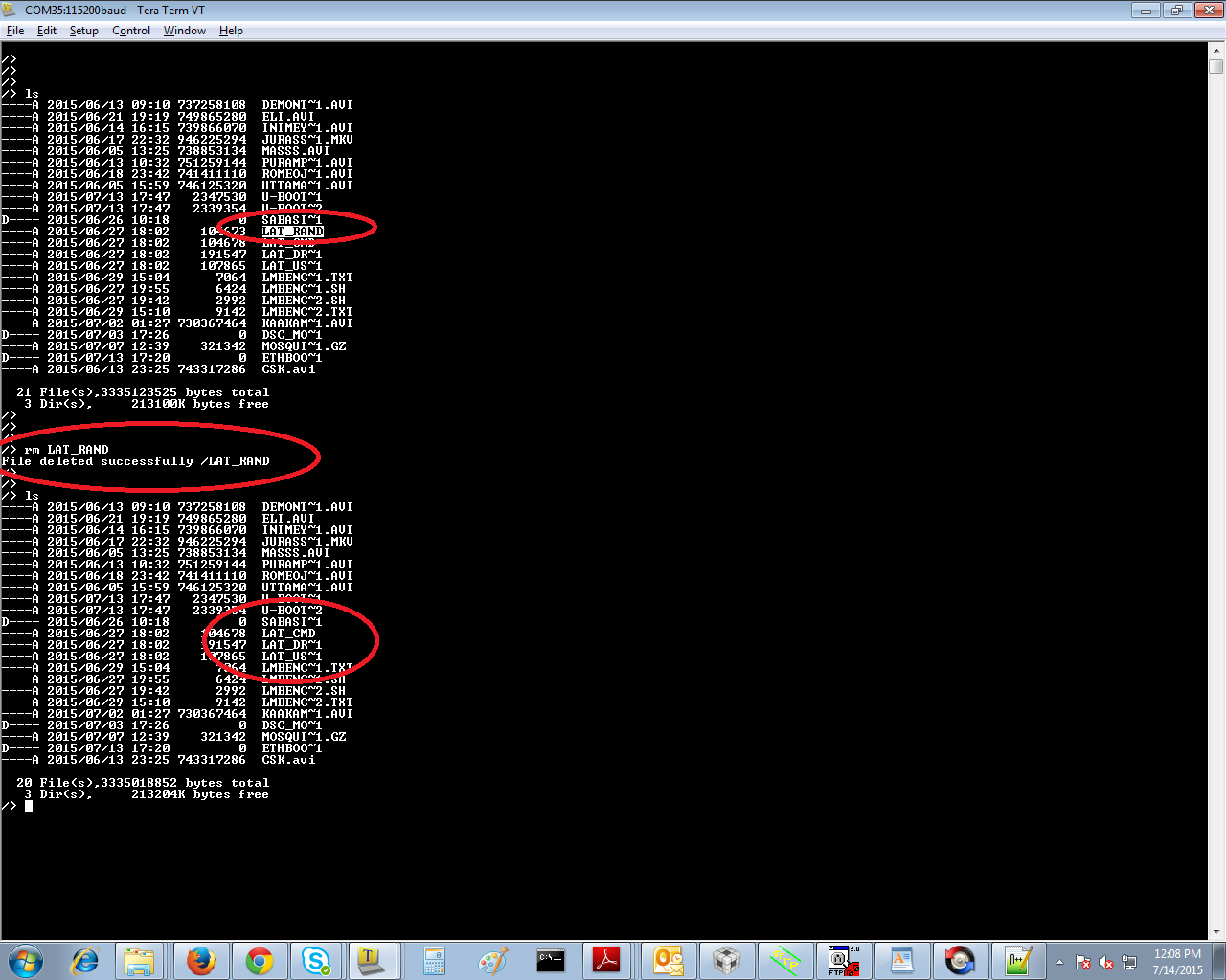

My application, based on OMAP-L138, NO OS,  requires USB Mass Storage support.
I need to store Log file in USB Mass Storage, and when USB near full, I have to delete older file.
There is no "DELETE" command in (OMAPL138_StarterWare_1_10_04_01\examples\lcdkOMAPL138\ usb_host_msc).
any help?
Guan
  • Moving this thread to the OMAP-L13x Processors Forum. Thanks for your patience.
    Lali
    You can use "f_unlink" API to delete the file.
    I've modified the code and attached here for your reference (actually we have API but not implemented in code).
    I've created "rm" command to delete the given file as argument.
    Please note that I've given this code for proof of concept, you can modify for robust code with error handling etc.,

    //Titus
    // This function implements the "rm" command. It will delete the file with "f_unlink()" API.
    int
    Cmd_rm(int argc, char *argv[])
        FRESULT fresult;
        unsigned short usBytesRead;
        unsigned int test_res;
        // Do not attempt to do anything if there is not a drive attached.
        if(g_eState != STATE_DEVICE_READY)
            return(FR_NOT_READY);
        // First, check to make sure that the current path (CWD), plus the file
        // name, plus a separator and trailing null, will all fit in the temporary
        // buffer that will be used to hold the file name.  The file name must be
        // fully specified, with path, to FatFs.
        if(strlen(g_cCwdBuf) + strlen(argv[1]) + 1 + 1 > sizeof(g_cTmpBuf))
            UARTprintf("Resulting path name is too long\n");
            return(0);
        // Copy the current path to the temporary buffer so it can be manipulated.
        strcpy(g_cTmpBuf, g_cCwdBuf);
        // If not already at the root level, then append a separator.
        if(strcmp("/", g_cCwdBuf))
            strcat(g_cTmpBuf, "/");
        // Now finally, append the file name to result in a fully specified file.
        strcat(g_cTmpBuf, argv[1]);
        // Delete or unlink the file.
        test_res = f_unlink(g_cTmpBuf);
        if(test_res == 0)
        	UARTprintf("File deleted successfully %s\n",g_cTmpBuf);
        else
        	UARTprintf("Error: unable to delete the file %s\n",g_cTmpBuf);
        // If there was some problem opening the file, then return an error.
        if(test_res != FR_OK)
            return(fresult);
        // Return success.
        return(0);

        { "rm",    Cmd_rm,      "  : Remove or Delete the file" },	//Titus
