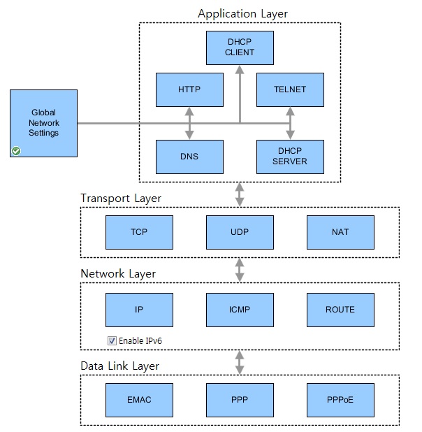

When I checked client_evmc6678l project, configuration show that only NDK global is enabled.
Here is the capture for NDK Core Stack-System Overview,
For client_evmc6678l, there are functions, like TCP, UDP, ICMP.
But the above picture doesn't show green mark. Does it mean that all functions is enabled using C code not SYS/BIOS?

    No, all the MCSDK examples are using SYS/BIOS and do not use any linux stuff.
    And is there simple project just for UDP?
    You can use that NDK "client" and "hello world" example SYS/BIOS code.
    You can send the either TCP or UDP packets. through ethernet MAC.

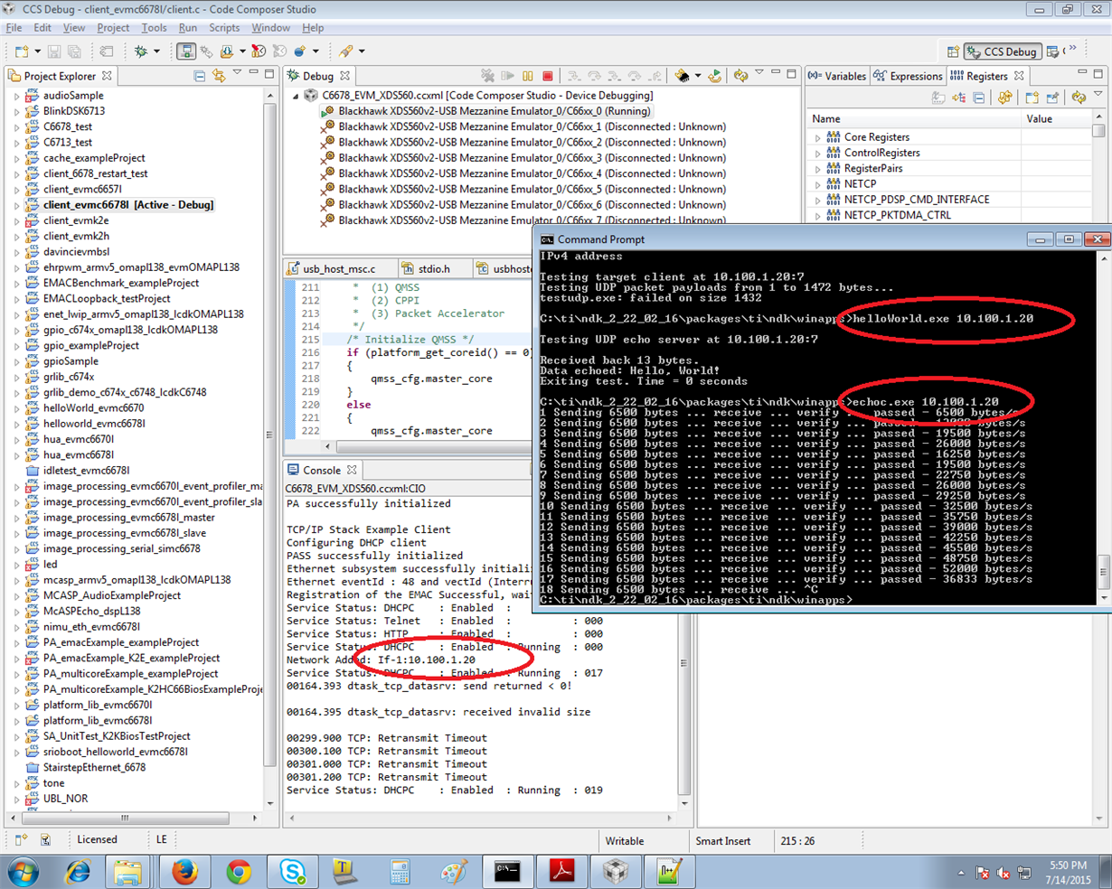

    By the way, would you explain windows applications "send", "recv" and "testudp" located in winapp directory?
    There is no explanation how to use these application.
    on client project, I am using telnet connection.
    On EVM board, there is "echo" command. And this command is not working correctly.
    Do I need setup for "echo" command?
    Thanks in advance.
    Baeyoung
    You have to use windows "command prompt" terminal to execute those apps with IP address which you got EVM board.
    Ex:
    <app> <EVM's IP address>
    helloWorld.exe 10.100.1.20
    send.exe 10.100.1.20
    recv.exe 10.100.1.20
    echoc.exe 10.100.1.20

    Already I did the same thing as you did. I opened dos command and excuted the command.
    I will delve into the codes. And if i have more quetion, I will come again.
