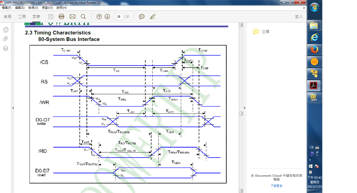

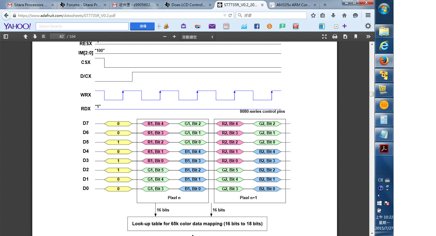

We adapt the ST7735R LCD (126*168 TFT 16bit 565 mode) 8080 mode, and I have referenced drivers/lcd Leonerdo supplies in below address and reference am335x TRM chapter 13.3.4 (LIDD controller).
BSP version: sdk6

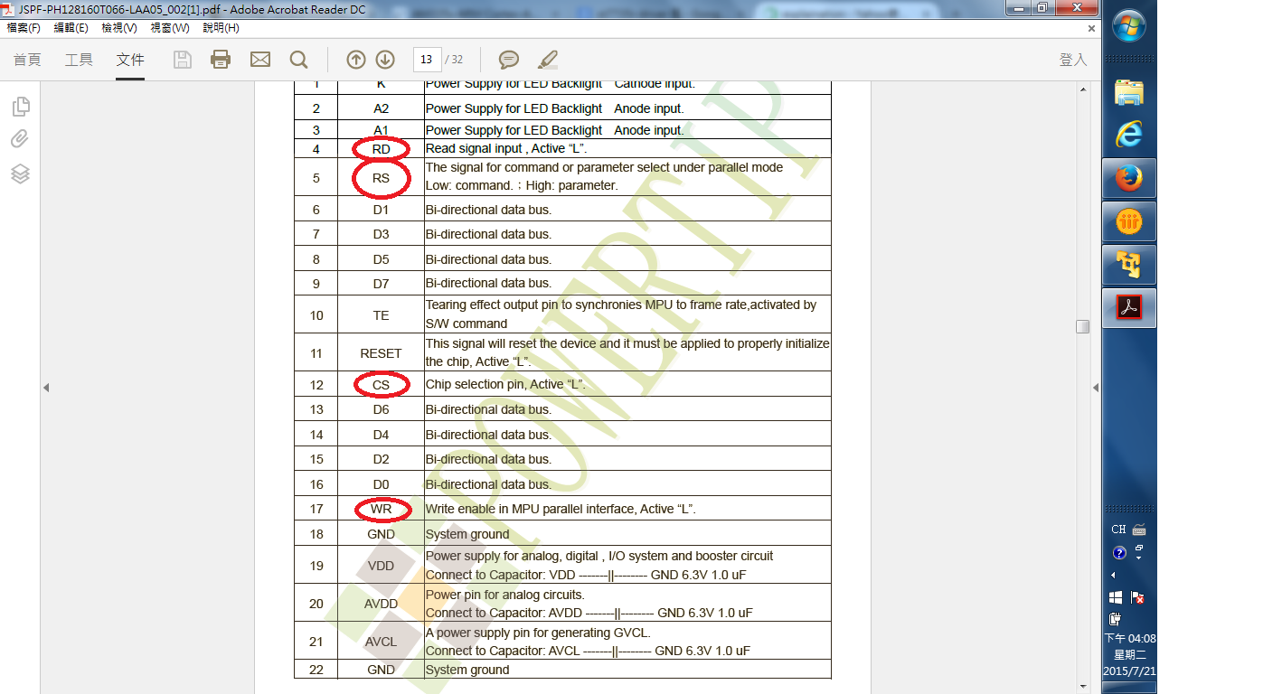

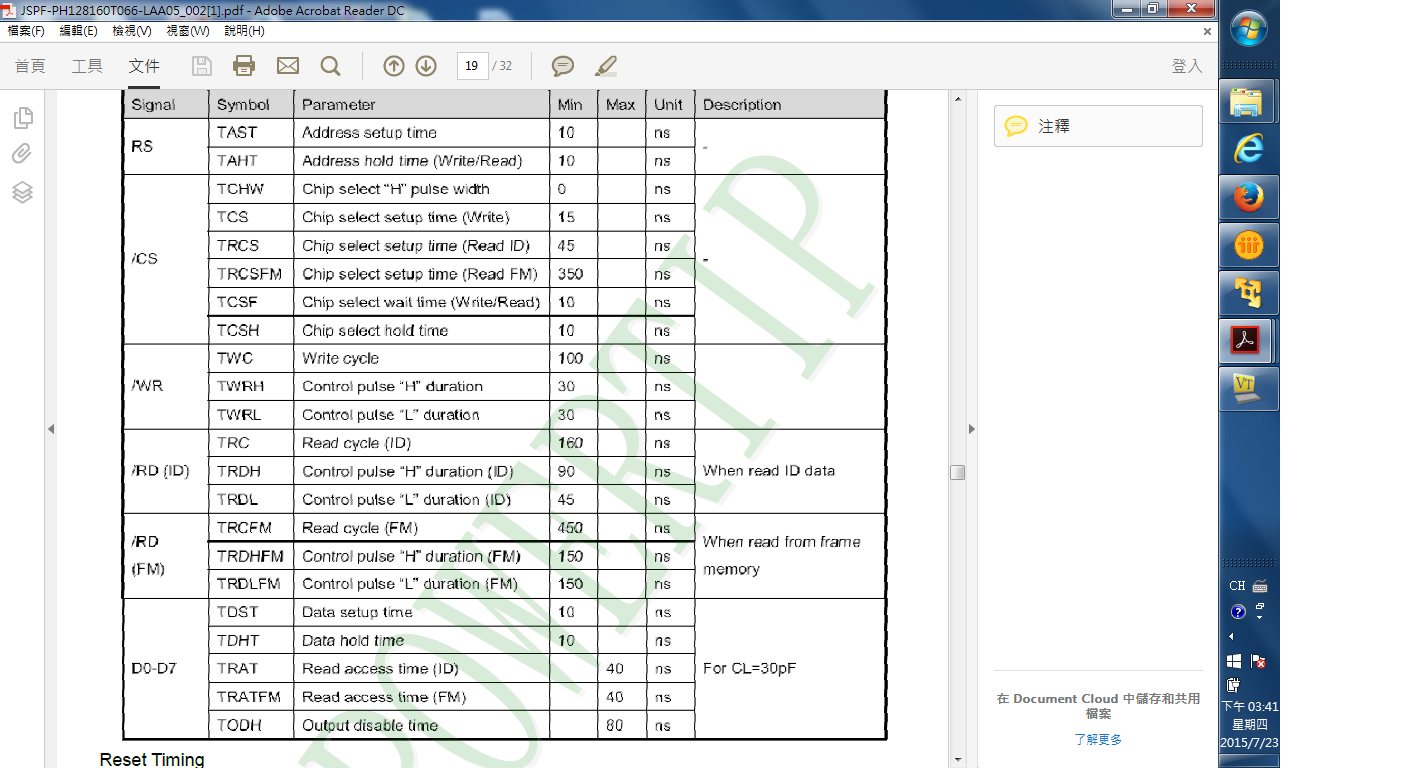

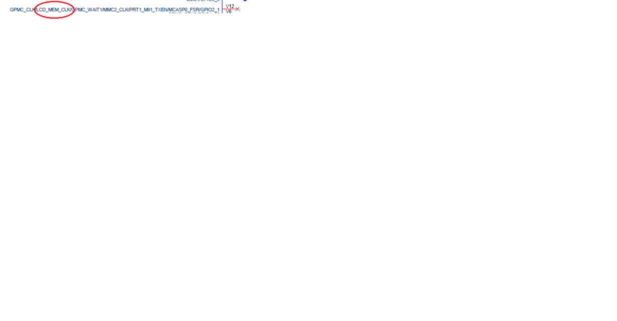

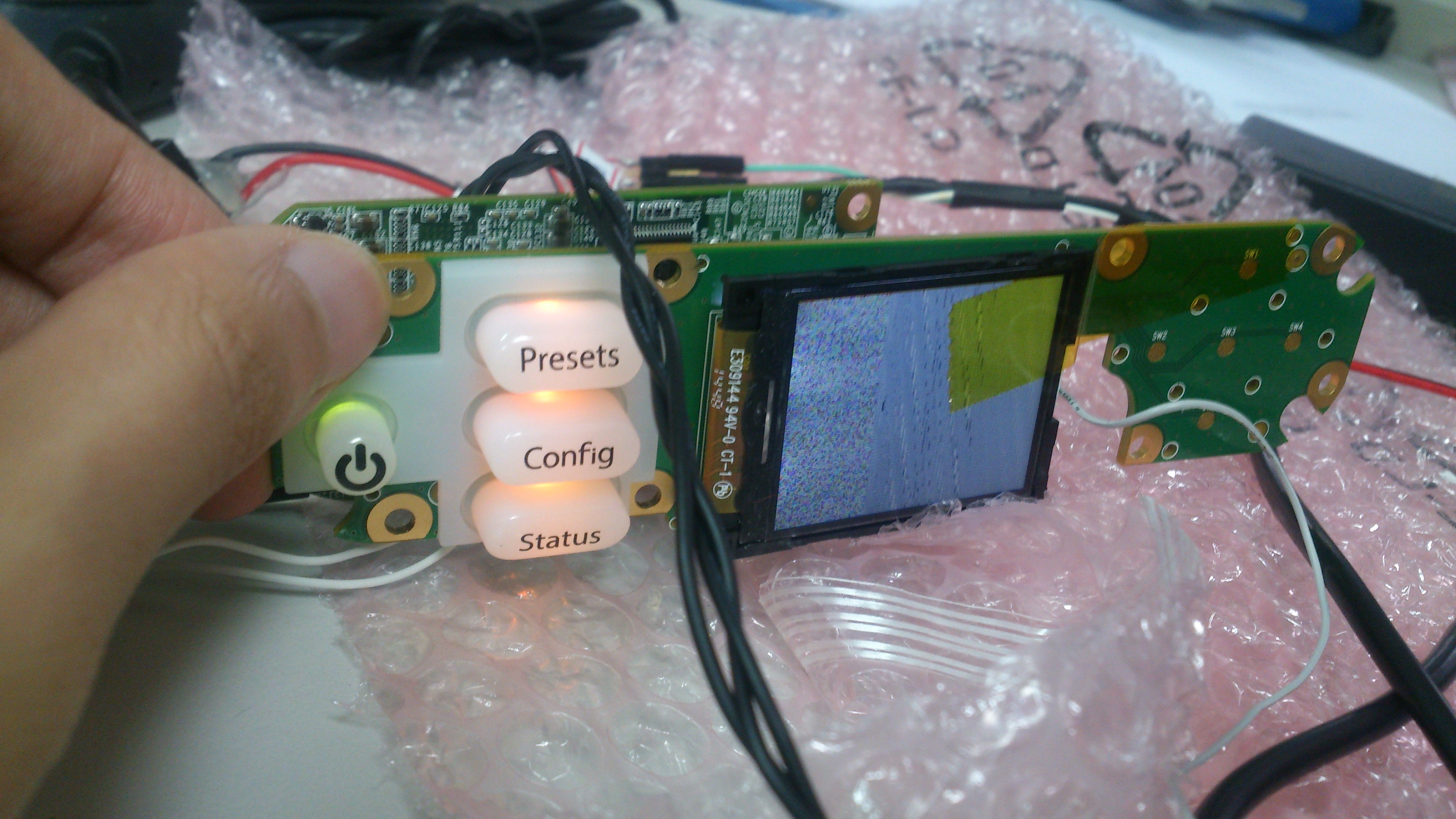

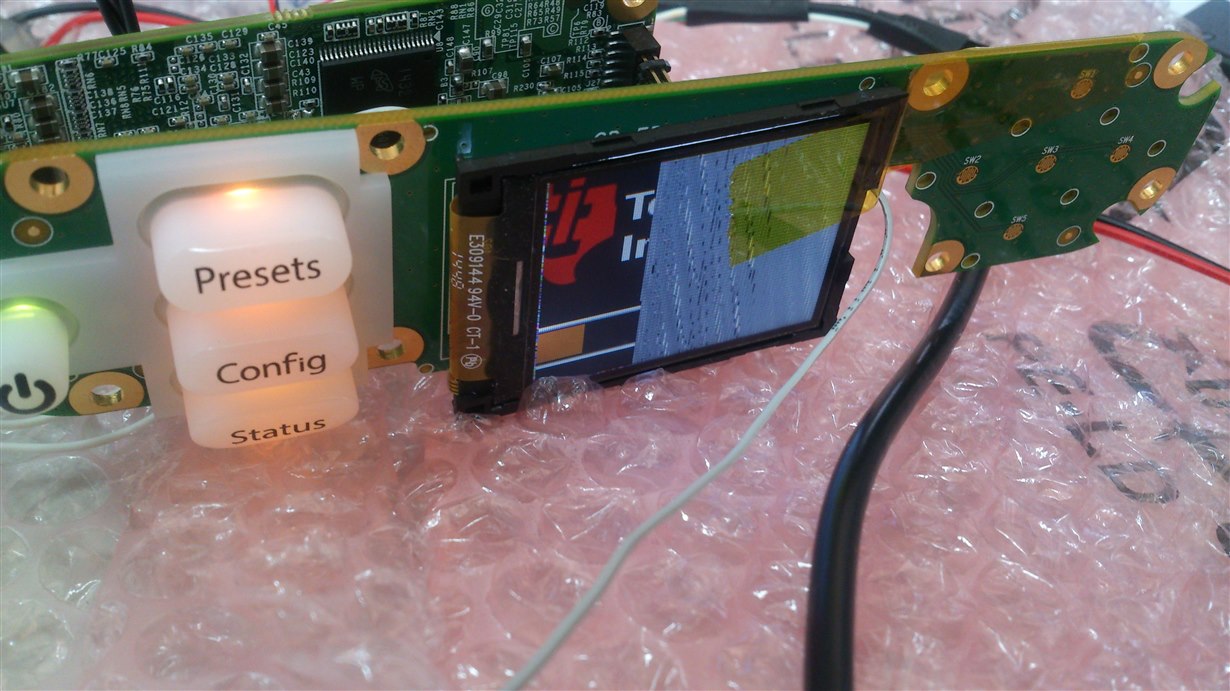

But panel have no picture in screen. I have two question to ask.
1 These process for initializing LIDD mode above are correct?
2 Do I need write something to initial LCD panel?
