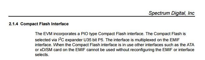

COMPACT FLASH ACCESS ISSUE IN DM6446EVM
1. we are trying to access compact flash in DM6446EVM board. First we tried reading device id using Spectrum digital inc example code. we are able to see console messages attached below.
Here we used SANDISK ULTRA II 4GB compact flash . Actual device id of the device is 848A. But we are able to read only MSB 84 , LSB bit 8A is not able to read.
2. Then we tried instruction given in Spectrum digital inc dm6446 technical reference manual page number 2-3, point 2.1.4 compact flash interface, mentioned below..
by making selection of U35 bit P5  we tried accessing compact flash. but we got only compact flash is detected like CD1 CD2 found..
 3. What could be the problem? what are all  the steps to be followed to make it work . Example Memory Test for the Regions.. Address test, pattern test etc.. please guide me.
