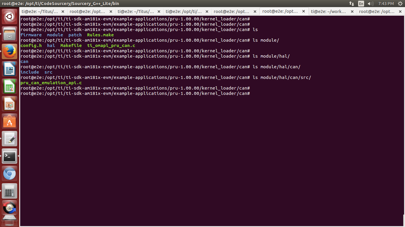

We are wondering if  TI PRU CAN Controller Driver is available or not, in "pru-1.00.00\kernel_loader\can\module" of AM1810?
And if there is latest version for this Driver?
Could anyone give us an application example of calling CAN Interface API that is used for data sending and receiving between two CAN nodes?

  • I will forward to IDK team incase they have more on this. My recollection is that the PRU CAN driver on AM18x is no longer much supported, you can possibly use it as reference , but this stack was never taken to certification etc.
    If you need CAN in the system you might want to look at other devices in the TI portfolio with native CAN interface.
    I have downloaded the SDK from the following TI link and able to see CAN linux driver with user space API interface.
