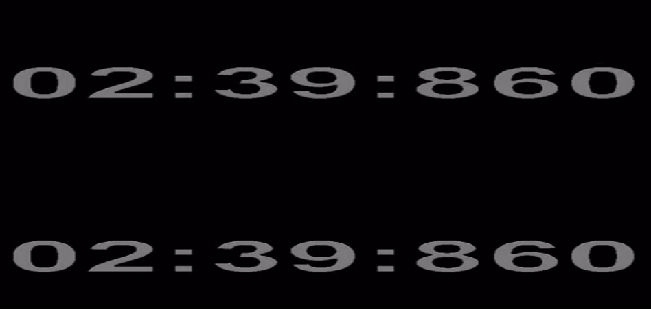

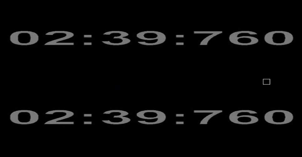

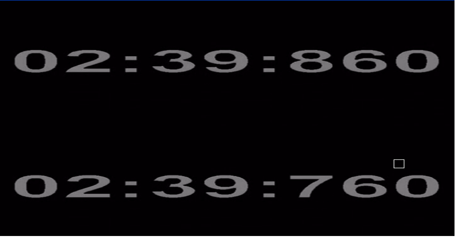

  • Hi Brijesh,
    See the video attached at below link :
    If you will play this sample.h264 (sample.h)video of a decrementing counter in elecard streamEye application. You will be able to see the both fields of the video simultaneously and it will be easy for you to identify which field is ahead compare to other with reference to the time.I have attached a picture of a frame from the same video.
    Initially both fields were showing value 02:39:860 as shown in image below. (Upper side Top field)
    When I pressed the button to see next field, I got below image in which value changed from 02:39:860 to 02:39:760 in bottom field first, while top field is still showing value 02:39:860. [Expected result : value should be change in top field first]
    When i again press the button to see next field, I got below image in which top field's value is changed from 02:39:860 to value 02:39:760.
    What we want is  when both fields show a value 02:39:860 and if we press button to see next field , we should get value changed in top fields first, means in top filed the value should be changed first to 02:39:760 and after that again when we press button to see next field, at that time value in bottom field should be changed from 02:39:860 to 02:39:760.
    This is what we want to achieve by inverting field ID. If we simply capture and dump the video, we are getting the same field order as I have mentioned in above case of decrementing counter.
    Let me know if you have any query or if we are going in wrong direction or doing something wrong.

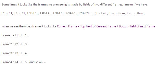

  • Brijesh,
    I have discussed with the team and i got to know that source is providing the correct field order. However when the video data get processed (cap_enc_dump) through EZSDK,  the problem get started.
    Sometimes it looks like the frames we are seeing is made by fields of two different frames. I mean if we have,
    F1B-F1T,  F2B-F2T,  F3B-F3T,  F4B-F4T,  F5B-F5T,  F6B-F6T,  F7B-F7T ....  ; F = Field,  B = Bottom, T = Top then ,
    when we see the video frame it looks like Current Frame = Top Field of Current frame + Bottom field of next frame
    Frame1 = F1T +  F2B,
    Frame2 = F2T +  F3B
    Frame3 = F3T +  F4B
    Frame4 = F4T +  F5B and so on....
    Devang

  • Hi Brijesh,
    1. NTSC camera: The NTSC camera with our custom board is giving reversal field order while the same NTSC camera with other proprietary products are giving field order as per standard.
    2. Black magic media express
        We have used black magic media as source and we have played a standard NTSC video in it. When we capture and encode  the same video using our custom board the, the output video is not same as input video in terms of field order when played in ELECARD.
    Let me know if you have any doubt.
    The problem is appearing in the firmware not in the source. It would be appreciated If you could spare some time to reproduce this at your end because that would give you the clear idea and we can approach towards solution.
    Devang
