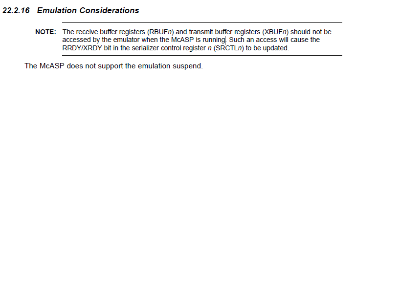

  • Dear Yordan,
    Am was going through reference manaul as per below section it says that it is unable to access RBUF's could you please clearly  let me know how to print these RBUF sample values
    As still am using ti sdk 8 with EDMA feature, could you please let me know
    I don't see the MACRO DAVINCI_MCASP_RXBUF_REG 0x280 being used anywhere in the code to print the samples , could you please let me know
    Could you please help me out where exactly & how to add the printk's in davinci-mcasp.c, could you please add & send across the patch Yordan
    Kindly do the needful as early as possible, as am trying to isolate this issue from driver side
    Many Thanks in advance once again
