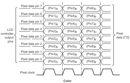

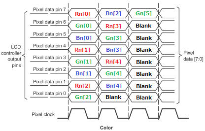

AM335x LCD Passive (STN) Mode Output Format
Is 24bit pixel data (RGB888) supported in the Passive (STN) Mode?
The color output format in Figure 13-14 on TRM (SPRUH73L) is not the active (TFT) mode since it seems that one pixel data (RGB888) is not output to the external LCD at each pixel clock. It seems to support 24bit pixel data (RGB888) in the Passive (STN) Mode.
Daisuke
