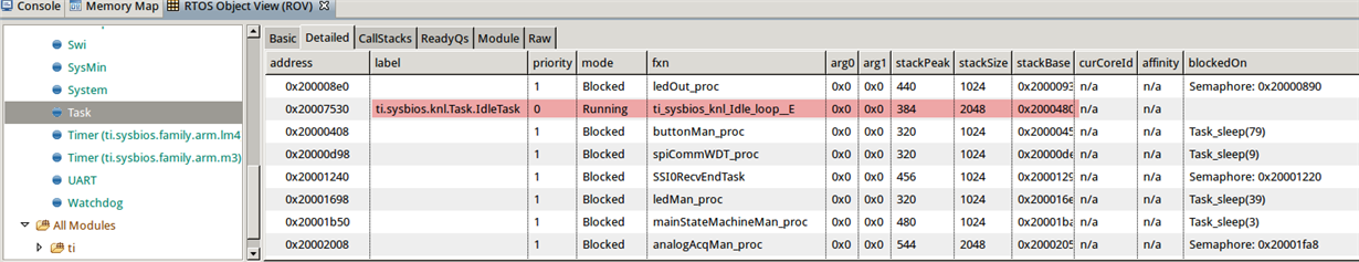

Hi I use Sysbios 6.41.00.26 and Tiva tm4c1231h6pge.
Whit ROV I can see that idle task has its own stack:
This idle task is 2048 bytes and after a normal usage of the firmware only 384 bytes are used.
I wonder how to reduce the idle task allocation.
my cfg fil is:

var Idle = xdc.useModule('ti.sysbios.knl.Idle');
Idle.addFunc('&wdt_Man_idleFcnt'); // add wdt_Man_idleFcnt()
