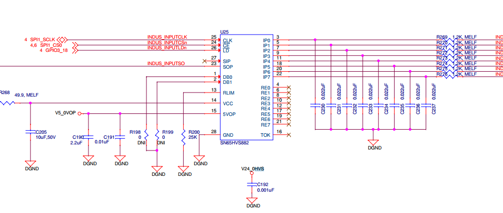

I spent many hours wondering why my SPI1_D1 would only read 0xFF every time I called the McSPICycle() function in the new SDK.
The problem is located in the plat_mcspi.h file, where MCSPI_HVS882_CH_ICE should use channel 1 instead and not 0 in the new TI-RTOS SDK:
Can Texas Instruments fix this problem ASAP to avoid the same pain when an SDK is downloaded?
am335x_sysbios_ind_sdk_1.1.0.8\sdk\platform\am335x\include
