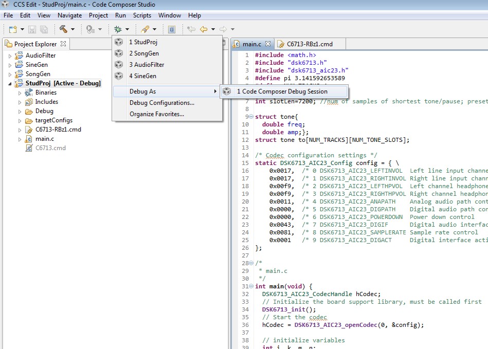

Slight code change makes DSK6713 hang
Recently we observed some strange behaviour when creating a C program for DSK6713.
The C program itself is about 700 lines of code and is meant to generate music. From some point on in the development process it would not run anymore in the DSK6713 though compiler and linker did not report any errors. I tried a series of changes, always starting with a code that still worked and finally could boil it down to a situation where the line (case 1)
  argA = argB = argC = argD = 0.0;
somewhere within the code leads to a working version, while replacing this single line by the two lines (case 2)
  argA = 0.0;
at the same location in the code leads to a version that hangs. The same happens if I split the command into four separate lines, one for each of the variables. There should be no functional difference between these approaches, though the compiler will likely translate them differently.
The map file itself shows plenty of available memory. In case 2 it uses 0x20 bytes more than in case 1.
We use CCS5.5.0 as floating license with license information "full license" - I also tried it on a separate machine with the free license and also with a node-locked full license. All cases showed the same behavior.
Has anybody observed some similar behavior and found a reason for that?

  • I now have perfomed some more tests:
    stack/heap size:
    I changed the stack and heap sizes from their default of 0x800 to 0x1000, and the nok-version still did not work, while the ok-version expectedly did fine.
    I also decreased the sizes of heap and stack to 0x600 to see whether the program is close to its limits, but even in this case the ok-Version worked well while the nok-version (expectedly) failed.
    breakpoints:
    I tried to find some pattern about the situation shortly before failure, looking into the nok-version:
    1. I set a breakpoint in the outer loop at line 677: it always was reached for the first time, never after a 'Resume' for a second time.
    2. I set an additional breakpoint in the inner loop at line 689: consecutive 'Resume' actions after 'Restart' stopped at line 677 and then subsequently at line 689. After about 20 such 'Resumes' with successful stops at line 689 and because I didn't want to step through all ~9000 cycles of the inner loop I set its loop counter k to 8898 (thereby shortcutting the inner loop) and continued with 'Resume' actions. The program stopped 3 times at line 689 and then (surprisingly!) again in the outer loop at line 677. Thus it had reached the outer loop breakpoint unexpectedly for a second time.
    I continued with that (setting k to 8898), and reached line 677 again for 2 or 3 times. After that the C$$EXIT showed up.
    3. I modified my loop counter k set value several times, and finally could find a pattern such that repeatedly after 36 loop cycles of the inner loop the program failed, ending at C$$EXIT. This happened no matter how often I did a shortcut in the inner Loop, even in the case of just 36 subsequent inner loop cycles without a shortcut action.
    4. I now 'Resume'ed after a 'Restart' until I reached loop cycle 35 and then single stepped (line by line C-based) until the C$$EXIT showed up; thereby I found it happened when processing line 689 (which is "x = x + ampA *sin(argA);").
    5. I then ran till line 689 after 36 inner loop cycles and changed from then on to 'Assembly Step Into'. This brought me right into the assembly code of the sin() function, which I actually don't understand. However after about 70 steps C$$EXIT was reached.
    6. Now: why did the sin() call work for the previous 36 loop cycles? For that to find out I played with the value of the sin-function argument. It soon turned out that higher values lead to a failure while lower values work; for me it seemed that pi/2 is the key value above which sin() did fail.
    7. Next I worked in 'Assembly Step Into' mode through the sin(x) function for a value x=1.4 (<pi/2) and x=1.6 (>pi/2) and found that the internal assembly processing took different paths for these two values, and the path for x=1.6 ended at C$$EXIT. I could confirm this for a few more values >pi/2.
    8. However the really interesting question (and the starting point of this post thread) was: Why does everything work fine with the ok-version and fail with the nok-version? There is no difference between the two versions in that part of the program where the sin() is called.
    Thus I loaded the ok-version to find the difference in its behavior. I also put an argument of 1.6 into the sin() call and did 'Assembly Step Into' subsequently. Except for the fact that the ok-version sits at an address 0x20 below the one of the nok-version the whole path through the assembly code was identical until at 0x5d48, shortly before the C$$EXIT location (which is at 0x5d60 for the ok-version), the ok-program branched back to some code location at 0x47ac while the nok-version just stepped over a series of NOPs right into C$$EXIT.
    9. I tried to further understand what was happening and compared ok- and nok-version behavior in that sin() function when its argument is >pi/2. As I said above I don't really understand how the function works. For me it seems that it itself calls a subfunction labelled '_trunc' which then calls a subfunction labelled 'modf'. In the ok-version the sequence sin() -> calls _trunc -> calls modf -> returns to _trunc -> returns to sin() seems fine. In the nok-version it seems to me that the return from _trunc to sin() does not work.
    10. One even deeper look seemed to reveal to me, that the register B3 is used for the return address to sin(). B3 is loaded from the stack, which could be observed in the ok-version, but which did not happen in the nok-version.
    Interesting in the nok-version is that the (wrong) content of B3 should make the program branch to that location, which does not occur (why??). Also, after a few of those NOPs before C$$EXIT B3 seems to be loaded with the correct return address, but the return action does not occur anymore.
    I am attaching a zip with three screenshots, each containing the register and disassembly window at the location where I would expect a return from _trunc to sin():
    a) screen-ok-rd01: it shows the PC and B3; the content of B3 (0x47ac) is the correct return location, and one assembly step further this is copied into the PC and the program correctly continues from there.
    b) screen-nok-rd01: it shows the PC and B3; the content of B3 (0x5d58) is not the correct return location, but the program also does not branch to 0x5d58 in the next step but continues with the following NOPs. Three NOPs later:
    c) screen-nok-rd02: it shows the PC and B3; the content of B3 (0x47cc) now is the correct return location, but the program does not branch there but just continue till C$$EXIT.
    This is where I have to give up.
    Is there anybody out there that can resume from here and find out why the same code behaves differently just by being moved 0x20 bytes further, and what I am supposed to do to make it work in this and future projects?
    Rainer
    /cfs-file/__key/communityserver-discussions-components-files/791/0728.screens.zip

    3. After freshly opening CCS, if you left-click on the down arrow by the bug icon, it will show 1 or more Target Configurations, with the latest at the top of the list. You can click on that item in the list and it will launch the Target Configuration only. Second, you can go to the newly opened Debug Window and right-click on the lowest DSP or C6713 line and select Connect Target. Third, you can find the Load program icon on the top icon ribbon and click it to select a previously opened file or re-load the latest or Load from browsing. Those three steps are done automatically by the bug icon, and you would normally not need to repeat the first two when you are running tests and changing your program code. Whenever you change the code and build it again, you should be prompted that it has changed and you can select to have it automatically reloaded.
    When doing this, after doing the Connect Target step, it should indicate where the PC is and the DSP should be started. At this point, do an invalidate, and then load your program to see if things will work.

    I don't see any such target configurations when clicking the down button at "Bug", jaus as given in the screenshot attached.

    When you clicked the down-arrow by the bug, it shows 4 Target Configurations, the first one is named StudProj. If you click on that one, it will be launched, and then you can do the Target Connect. Most of the time when I am debugging a program, I launch once, Target Connect once, and load my program many times without having to do those first two steps again. This would make things run faster since you would not have to wait for the launch and connect.
    I assume there is a typo in the file name, and it is DSK6713.gel. If so, then we can be confident it is designed to work with the DSK board and will setup the EMIF and PLL and everything you need to be done.
    After launching your Target Configuration, you can click on the C6713 line in the Debug window to select it (before Connecting) and find that GEL files menu the way I mentioned above or however you found it earlier. In the GEL files box, you can right-click and request to Load GEL, browsing to the file you found above. Now, when you Connect there will be an OnTargetConnect() function in the GEL file that runs automatically, and before it loads your program it will run OnPreFileLoaded().

    1. yes, it was a typo; the GEL file is "DSK6713.gel", and there is one in the DSK6713 distribution and one in the CCS5 distribution (with a difference in the reset_pll() function).
    2. when I click the down-arrow by the bug and select the "StudProj" target configuration it will connect automatically. Anyway I tried to play with several sequences of "disconnect - connect - reload program - resume" without a GEL file, and it always went to the looping case and got stuck there. This is as it was before.
    3. I then did a sequence of "disconnect - load GEL file - connect - reload program - resume" and it seemed to work fine. I did this several times with both versions of the above GEL files and did not observe any problems any more nor differences in the behavior between the two Versions of the GEL file.
    4. Finally I found that it seems to be sufficient to click the "bug" button, then load the GEL file, reload the program and click the resume button.
    5. Also I noticed that the GEL file disappears when stopping the debug process; it needs to be re-loaded each time, which is a bit tedious.

    As the manual loading of the GEL file each time after starting a new debug run is laborious, I looked through the TI documentation on how to load the GEL file automatically. There is not much written about that, but after some hints in your posts and in other threads and own trying I finally found a solution (and looking back, it's not that difficult).
    Now the GEL file is part of the CCS project and is automatically loaded when pressing the 'Bug' button.
    From my point of view, the issue is solved and this thread can be closed.
    Should/could I do that or is it something the TI staff does?
    For all who have followed the thread up to this point and themselves wonder how to add a GEL file to a project, here is how I managed to do that in CCSv5.5:
    1. In the "Project Explorer" view: double-click on the project. A folder icon "targetConfigs" should be seen in the project.
    2. Double-click on "targetConfigs". An entry "*.ccxml" should be in there (with * being some config name).
    3. Double-click on that entry. It should open a new tab in the editor view. This tab has three inner tabs "Basic", "Advanced", and "Source", which appear at the lower left edge of the editor view.
    4. Select the "Advanced" tab. It shows on the left side ("All Connections") a tree, where the leaf is a CPU (in my case it is "TMS320C671X").
    5. Select the CPU. This causes "Cpu properties " to appear on the right side, where some settings can be made, among them "initialization script".
    6. If there is no GEL file yet specified, the text field to the right of "initialization script" is empty, otherwise it contains the path to the specified GEL file.
    7. To change the GEL file or to specify a GEL file: either type in the path of it or use the "Browse" button next to the text field to navigate to it.
    8. Do a "File-->Save" to save the settings - done.
