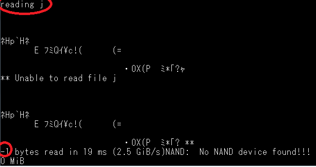

How do I add "fatload mmc 0 0x80050000 tv.bin" into code of u-boot?
Dear TI
I try add command of "fatload mmc 0 0x80050000 tv.bin" into code, and I trace code to
u-boot/fs/fs.c
static int fs_read_fat(const char *filename, ulong addr, int offset, int len)
    int len_read;
        printf("value are %x %d %d\n", filename,offset,len);
    len_read = file_fat_read_at(filename, offset,
                    (unsigned char *)addr, len);
    if (len_read == -1) {
        printf("** Unable to read file %s **\n", filename);
        return -1;
    return len_read;
At first, I do "fatload mmc 0 0x80050000 tv.bin" in u-boot mode, and it prints  "value are 8f9db6a8 0 0", as result, I do the same thing in u-boot code.
    time = get_timer(0);
    ptr=0x8f9db6a8;
    len_read=fs_read(ptr,0x80050000,0,0);
    time = get_timer(time);
    printf("%d bytes read in %lu ms", len_read, time);
    if (time > 0) {
        puts(" (");
        print_size(len_read / time * 1000, "/s");
        puts(")");
but there error occurs.
What is wrong? Could you correct me? Thank you.
