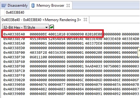

We are doing a custom board based on TI AM4377 processor.

Debugging our custom board using Code Composer Studio:-
(1) We selected IDK_AM437x in configuration file.
(2) Initialized the AM437x IDK GEL file.
(3) Loaded MLO (TI SYS BIOS) to the External RAM(DDR3) location (0x8000_0000).
(4) Executed from the RAM.
Result:-
We are able to see initial prints which was expected in our custom board.
Please find the attached snapshot of MLO executed from RAM.
Observations:-
(1) We checked the SYSBOOT settings from CTL_STS (processor status registers), it reflects the MMCSD0 boot settings.
(2) We checked the Trace vectors of processor in our custom board it looks to be positive for us.
Please find the attached snapshot of trace vectors
