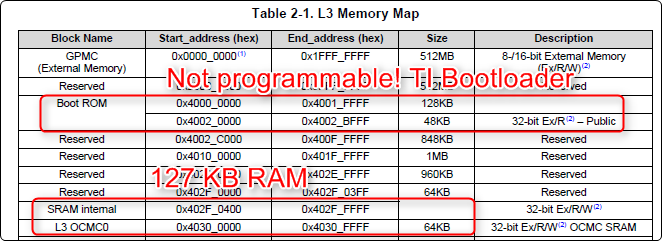

    Not quite.  Here's a screenshot I marked up from the TRM's memory map:
    The "Boot ROM" area is code written by TI to load user code into RAM.  So in particular, the "normal" way of using this device is that both code and data reside in RAM.  In terms of RAM there is a total of 127 KB.  The "SRAM internal" is accessible only by the ARM, i.e. it is "internal" to the ARM.  The L3 OCMC0 is accessible to the whole chip (e.g. DMA, USB, Ethernet, etc.).
    Now there are some additional "tricks" you could play.  For example, if you use parallel NOR flash as your boot device, you can actually execute code directly from parallel NOR flash.  That could enable you to execute all your code directly from NOR and use all the RAM for data.  So there are tricks like this that you can play.  However, I still think it would be a lot of engineering effort to get your data usage down to 127 KB of RAM.
