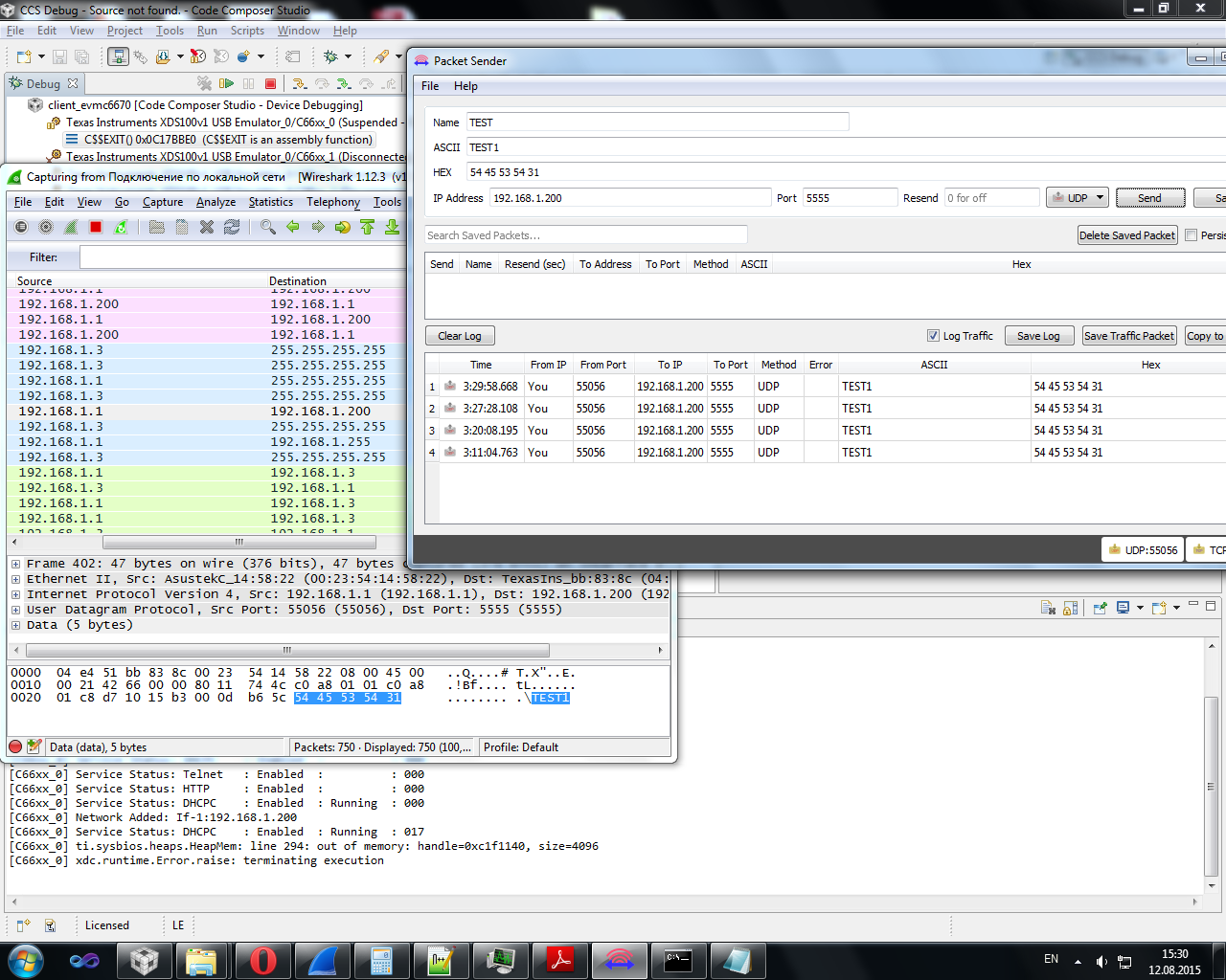

    I've followed the thread and got some problems. Debug stops at the
    rSocket = socket(AF_INET, SOCK_DGRAM, IPPROTO_UDP );
                if( rSocket == INVALID_SOCKET )
                	printf("FATAL ERROR! SOCKET IS NOT CREATED \n");
    And returns this in the console:
    00000.000 llEnter: Illegal priority call to llEnter()
    00000.000 llExit: Illegal call to llExit()
    What's wrong with this thing? If i'm using only recieve section, it's working, but when i add send section, this error appears. Is that a memory configuration issue or i've just mistaked in the socket creation code?

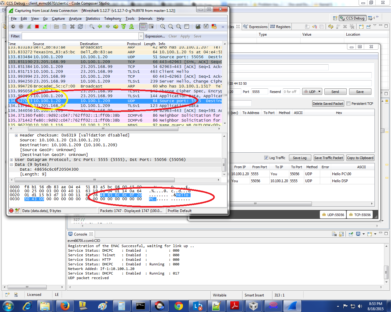

  • Hi Taras,
    I have used "hello world" NDK example code which receive the UDP packets and send back to the same IP address.
    So, you can use the function "dtask_udp_hello" from "udpHello.c" then create socket to do that....
    You can also change the port no as your wish.
    Here, 7 is the port no...

    I have used packet sender to send UDP packets from PC (10.100.1.94) to C6678 EVM board (10.100.1.17) and able to get the same packet to my PC (echoed back).
    I hope, that's what you need right ?

    I have send UDP packet from PC to board through "packetsender" and captured the packet in PC which I received from board.

  • Well i thank you very much, that really helps a lot. But that's not all what i need to do. I've created C++ application, which must send a string like "Hello Board" to the board. Board must recieve this, and spit the "Hello PC" String. In my case it look like even the infinte cycle of recv with "break" is not helping, i can't recieve this data. If i will fix and understand that, hope i'll can do sending to PC by myself.
    UPD: Program runs out of memory when i'm launching the C++ application. Problems with heap or something like that:
    [C66xx_0] ti.sysbios.heaps.HeapMem: line 294: out of memory: handle=0xc1f00b0, size=4096
    I have added one more screen shot for your reference in previous post..
    I would like you to suggest to use the "packetsender" to send the packet and use the "wireshark" to capture and analyse (whats going on network) the packets over network.
    Try to increase the heap memory in *.cfg file.

  • UPD:
    [C66xx_0] ti.sysbios.heaps.HeapMem: line 294: out of memory: handle=0xc1f0080, size=4096
    [C66xx_0] xdc.runtime.Error.raise: terminating execution
    begins to appear, when i'm trying send packet with PacketSender, as you said. I've added the transmission task function

    Now I'm able to see your memory insufficient issue.
    You have added lot of stuff (platform LED code, testing etc.,) in that code which consume much memory, I will look into it and get back to you.
  • Hello again.
    Well, i've really added a lot of stuff, but in the final stage, i will need to add the whole calculation program in the project, so it's critical to me to know if I can work within the framework of internal memory or will have to finish boot DDR memory. And i'm afraid that this will be a nessesary step, but now i would be satisfied with properly internal configuration.
    UPD: Still working to make the DDR loader to initialize. Waiting for your news.
    Yes I'm able to reproduce your memory issue, its due to stack overflow.
    This "dtask_udp_transmit" function executing continuously if received single UDP packet, due to that it lead to stack overflow.
    You can put breakpoint in that function or put some printf to check.
    I'm checking why the UDP function get called even didn't send any UDP packet (just for single UDP packet event) from PC.
  • Hi Taras,
    Now, I'm able to send and receive the UDP packets with your client NDK project example code without any issues.
    The problem is due to your "dtask_udp_transmit" in "retrans.c" file.
    I think, your requirement is need to send UDP packet from PC (Message: Hello DSP) and DSP should respond to DSP with UDP packet (Message : Hello PC)
    I have modified the code like that and able to send/receive the UD packet without any stack overflow or memory issue.
    Try the code in "retrans.c" file and let me know if any issues.

    Your code helped! Thank you very much, i've defeated this simple project. I will still ask further  questions about DDR init in other themes, but this thing is finished
    Are you switch OFF the board for every load ?
    Can you attach the complete log.
    I will attach the complete working project.
  • Yes, i was switching it off, doing the full reset, etc. Everything is worked, but one tiny thing appeared - when i'm receiving the data, it appears like
    What should i do, if i want to print the whole data message, instead of only first letter?
    And one more thing? Are there the specific memory locations for ethernet buffer, or they are created dynamically? Can i allocate the specific one  to watch it?

    Now also I tested your modified code and didn't see any issues.
    Could you please test this and let me know.
    Delete your imported project from CCS workspace and import the attached project.
    I attached here your modified project.
    8551.client.zip
  • Hello Titus.
    This project is working correctly too. I've tested this, didn't find issues.
