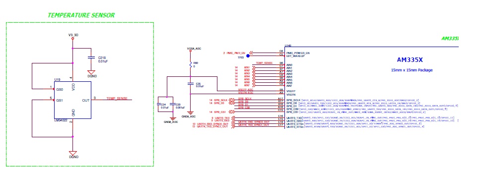

AM3359 I/F with Temperature Sensor LM94022 on ICE V2.1 board
Other Parts Discussed in Thread: SYSBIOS, LM94022
I'm trying  to read Temperature Sensor (LM94022) presentt on ICE v2.1 board.  However there is no example given to read this sensor  in SDK (am335x_sysbios_ind_sdk_1.1.0.3).
I've taken example code (..\sdk\starterware\examples\evmAM335x\adc\adcVoltMeasure.c) of starterware to start with and integrated this code in a sys/bios project.
But I'm not able to read the sensor value correctly. It is always returning a fixed value(0xFFF). I'm adding a snapshot of schematic of ICE v2.1
I'm not sure if I'm configuring the internal ADC correctly. Please correct me as I"ve pasted code for adc configuration.
Code for Reading Temperature Sensor value.

Void adc_int_isr(UArg arg);
 * ADCInit: Function to Initialize ADC in 1 Ch(AN0) mode, one-shot measurement
 * mode.
void ADCInit(void)
    TSCADCModuleClkConfig();
    TSCADCConfigureAFEClock(TSC_ADC_INSTANCE, 24000000, 3000000);// Configures ADC to 3Mhz
    TSCADCTSTransistorConfig(TSC_ADC_INSTANCE, TSCADC_TRANSISTOR_ENABLE);// Enable Transistor bias
    TSCADCStepIDTagConfig(TSC_ADC_INSTANCE, 1);
    // Disable Write Protection of Step Configuration regs
    TSCADCStepConfigProtectionDisable(TSC_ADC_INSTANCE);
    // Configure step 1 for channel 1(AN0)
    StepConfigure(0, TSCADC_FIFO_0, TSCADC_POSITIVE_INP_CHANNEL1);
    // General purpose inputs
    TSCADCTSModeConfig(TSC_ADC_INSTANCE, TSCADC_GENERAL_PURPOSE_MODE);
    // Enable step 1
    TSCADCConfigureStepEnable(TSC_ADC_INSTANCE, 1, 1);
    // Clear the status of all interrupts
    //CleanUpInterrupts();
    // End of sequence interrupt is enable
    TSCADCEventInterruptEnable(TSC_ADC_INSTANCE, TSCADC_END_OF_SEQUENCE_INT);
    // Enable the TSC_ADC_SS module
    TSCADCModuleStateSet(TSC_ADC_INSTANCE, TSCADC_MODULE_ENABLE);
 * StepConfigure: Function to Initialize ADC channel, reference voltage, Fifo
 * and one-shot measurement mode.
void StepConfigure(unsigned int stepSel, unsigned int fifo,
                   unsigned int positiveInpChannel)
    // Configure ADC to Single ended operation mode
    TSCADCTSStepOperationModeControl(TSC_ADC_INSTANCE,
                                  TSCADC_SINGLE_ENDED_OPER_MODE, stepSel);
    // Configure step to select Channel, reference voltages
    TSCADCTSStepConfig(TSC_ADC_INSTANCE, stepSel, TSCADC_NEGATIVE_REF_VSSA,
                    positiveInpChannel, TSCADC_NEGATIVE_INP_CHANNEL1, TSCADC_POSITIVE_REF_VDDA);
    // XPPSW Pin is on, Which pull up the AN0 line
    TSCADCTSStepAnalogSupplyConfig(TSC_ADC_INSTANCE, TSCADC_XPPSW_PIN_ON, TSCADC_XNPSW_PIN_OFF,
                                TSCADC_YPPSW_PIN_OFF, stepSel);
    // XNNSW Pin is on, Which pull down the AN1 line
    TSCADCTSStepAnalogGroundConfig(TSC_ADC_INSTANCE, TSCADC_XNNSW_PIN_ON, TSCADC_YPNSW_PIN_OFF,
                                TSCADC_YNNSW_PIN_OFF,  TSCADC_WPNSW_PIN_OFF, stepSel);
    //select fifo 0 or 1
    TSCADCTSStepFIFOSelConfig(TSC_ADC_INSTANCE, stepSel, fifo);
    // Configure ADC to one shot mode
    TSCADCTSStepModeConfig(TSC_ADC_INSTANCE, stepSel,  TSCADC_ONE_SHOT_SOFTWARE_ENABLED);
Void ADC_Task(UArg arg1, UArg arg2)
    int analogSensor;
    //char t_str[32];
    Task_sleep(2500);    // Give two and half second to taskOne
    // Task will run this loop forever
    while(1)
        ADCInit();                                                // Set-up ADC for one-shot measure
        while(flagADC);                                            // Wait that the analog to digital conversion has been done
        analogSensor = sample*439/1000;                            // Conversion to have a value in mV
        //sprintf(t_str,"Temperature: %dmV.\n",analogSensor);
        //UARTPutString(uartInstance,t_str);                        // Push it through the UART you it's readable for users
        UARTPutString(uartInstance,"\n\rTemperature ");
        UARTPutInteger(uartInstance,count_adc_int);
        UARTPutString(uartInstance," : ");
        UARTPutIntegerHex(uartInstance,(analogSensor));
        flagADC = 1;                                            // Will be turn to 0 at the next conversion
        Task_sleep(5000);                                        // Repeat every 5 seconds
Void create_adc_tasks(Void)
 ////////////Task Creation//////////////////
    Task_Params taskParams;
    Task_Params_init(&taskParams);
    taskParams.priority = 12;
    taskParams.stackSize = 1512;
    adc_tsk= Task_create (ADC_Task, &taskParams, NULL);
    if (NULL == adc_tsk)
        System_abort("ADC Task create failed");
        BIOS_exit(0);
 //////////HWI Creation//////////////////////
    Hwi_Params hwiParams;
    Hwi_Params_init(&hwiParams);
    hwiParams.priority = 6;
    hwiParams.enableInt = false;
    adcHwiInt = Hwi_create(SYS_ADC_INT, adc_int_isr, &hwiParams, NULL);
    if (NULL == adcHwiInt)
        System_abort("HWI ADC int creation failed");
        BIOS_exit(0);
    Hwi_enableInterrupt(SYS_ADC_INT);
     volatile unsigned int status;
     count_adc_int++;
     count_adc_int = count_adc_int % 200;
     status = TSCADCIntStatus(TSC_ADC_INSTANCE);
     TSCADCIntStatusClear(TSC_ADC_INSTANCE, status);
     if(status & TSCADC_END_OF_SEQUENCE_INT)
         /* Read data from fifo 0 */
         sample = TSCADCFIFOADCDataRead(TSC_ADC_INSTANCE, TSCADC_FIFO_0);
         flagADC = 0;
